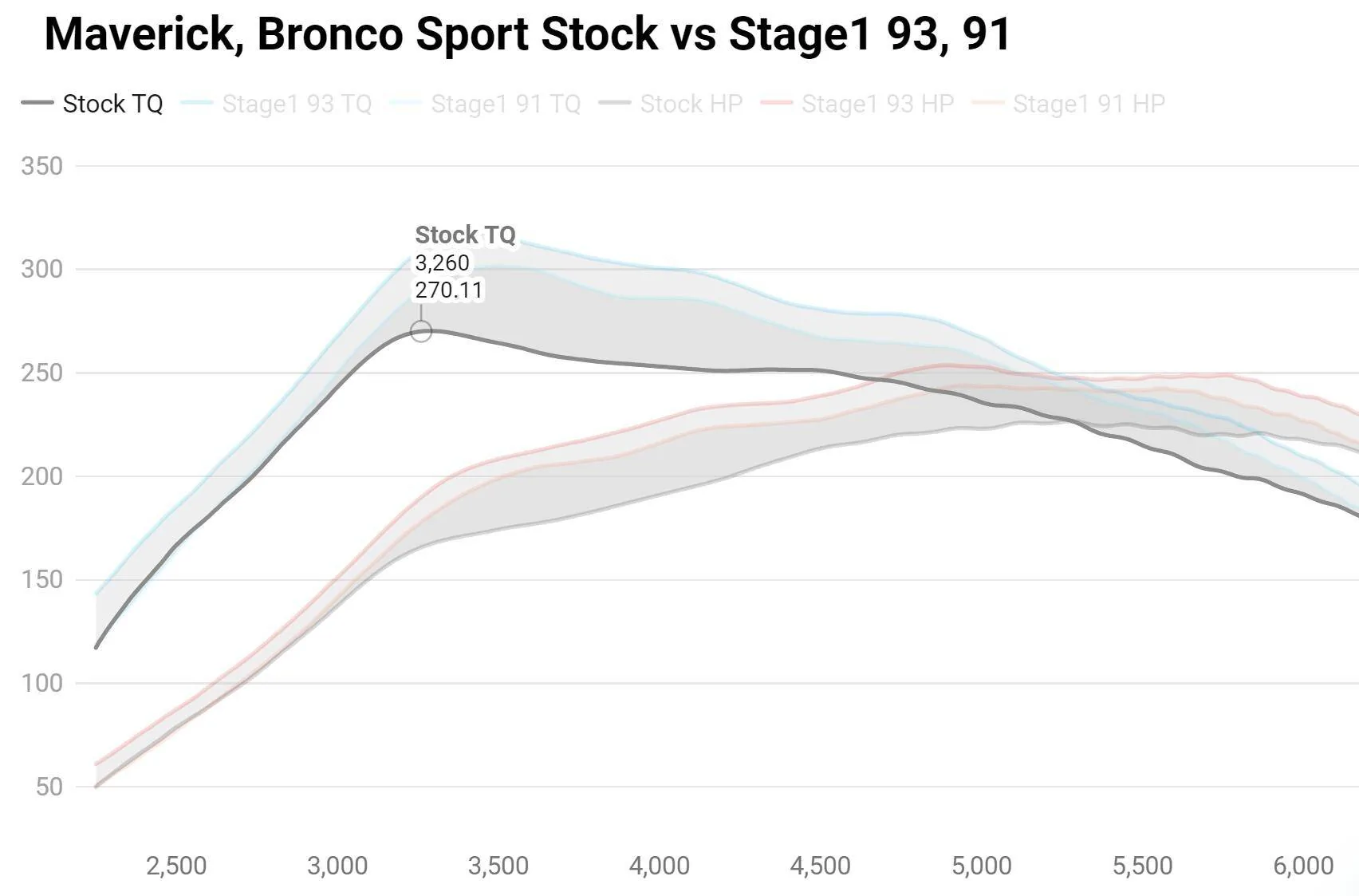

2. Dear Badlands owners: Your engine has the possibility of producing more torque than the 8F35 can handle.
The 2.0 in the Bronco Sport, accordingly to very reputable people like Cobb is capable of putting out 270ft/lbs or 366 n/m of torque at peak.
Ford Bronco Sport Badlands 2.0 Transmission Clutch Failure 1729018517122-s4

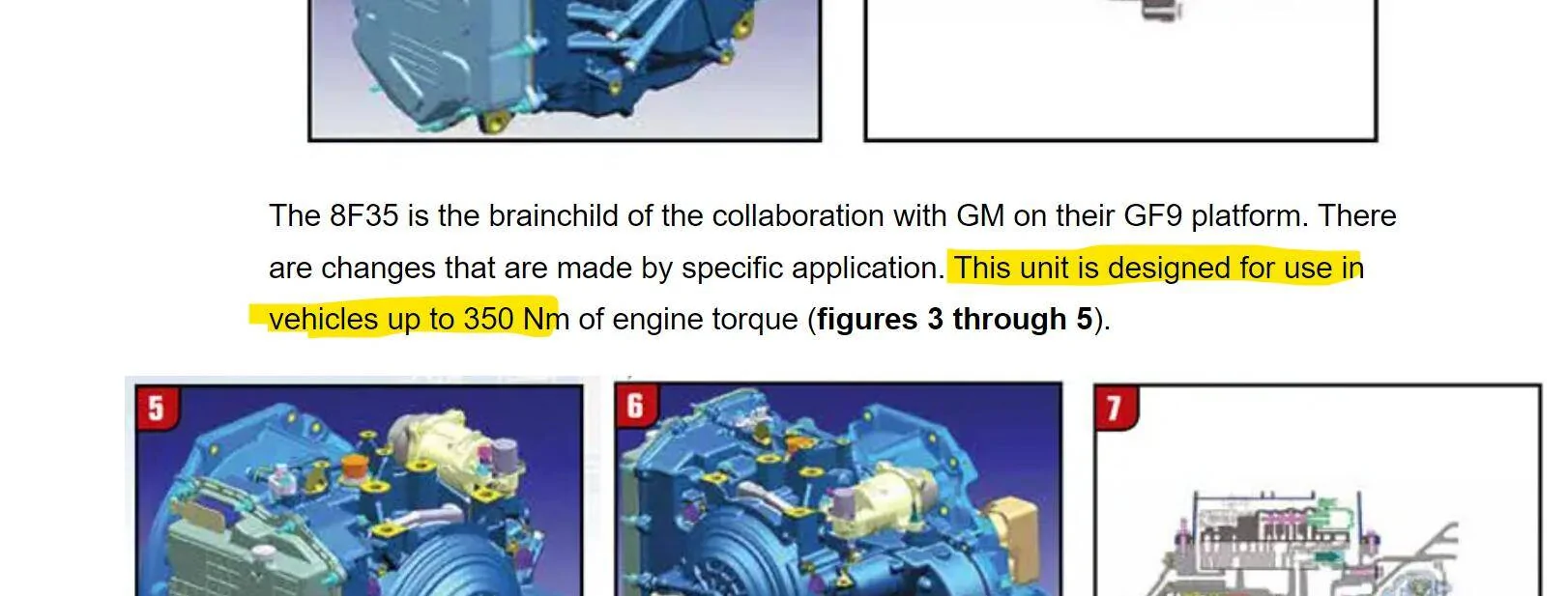

However, just looking at some tear down videos of the 8F35, it doesn't seem that robust. The selectable one way clutch design is kind of an easy way to simply cut down on parts and make the transmission lighter. The transmission limits are confirmed by the people at transmission digest, however reputable that may be.
Ford Motor Company and the Hat Trick - Transmission Digest
Ford Bronco Sport Badlands 2.0 Transmission Clutch Failure 1729018487414-am
