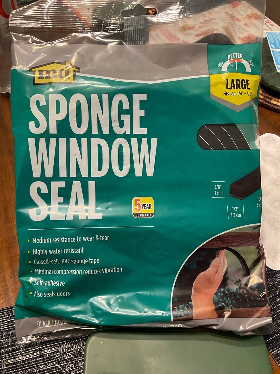

So, this is what I purchased today at Lowe’s. I intend to cut small 1/2” strips and cut off the tape and squeeze it in horizontally at the bottom of the screen. It did not get out of the 30’s today so I am waiting until Saturday when it will be in the 50’s. Gotta love Michigan weather.
Ford Bronco Sport Bad Dash Rattle on rough roads and expansion joints in the road anyone else? IMG_0333
I Live in Ohio so i know how your Weather Is.Sunday Night until early Monday morning we had a ground covering of Snow,Later that Day i cut the grass :) . I talked to a Guy Leaving the Bank when i did on Monday and told Him about the Snow and cutting the Grass He said only in Ohio.:) Let me know if that works for you but i think my rattle is also coming from the plastic vents on the dash by the windshield.

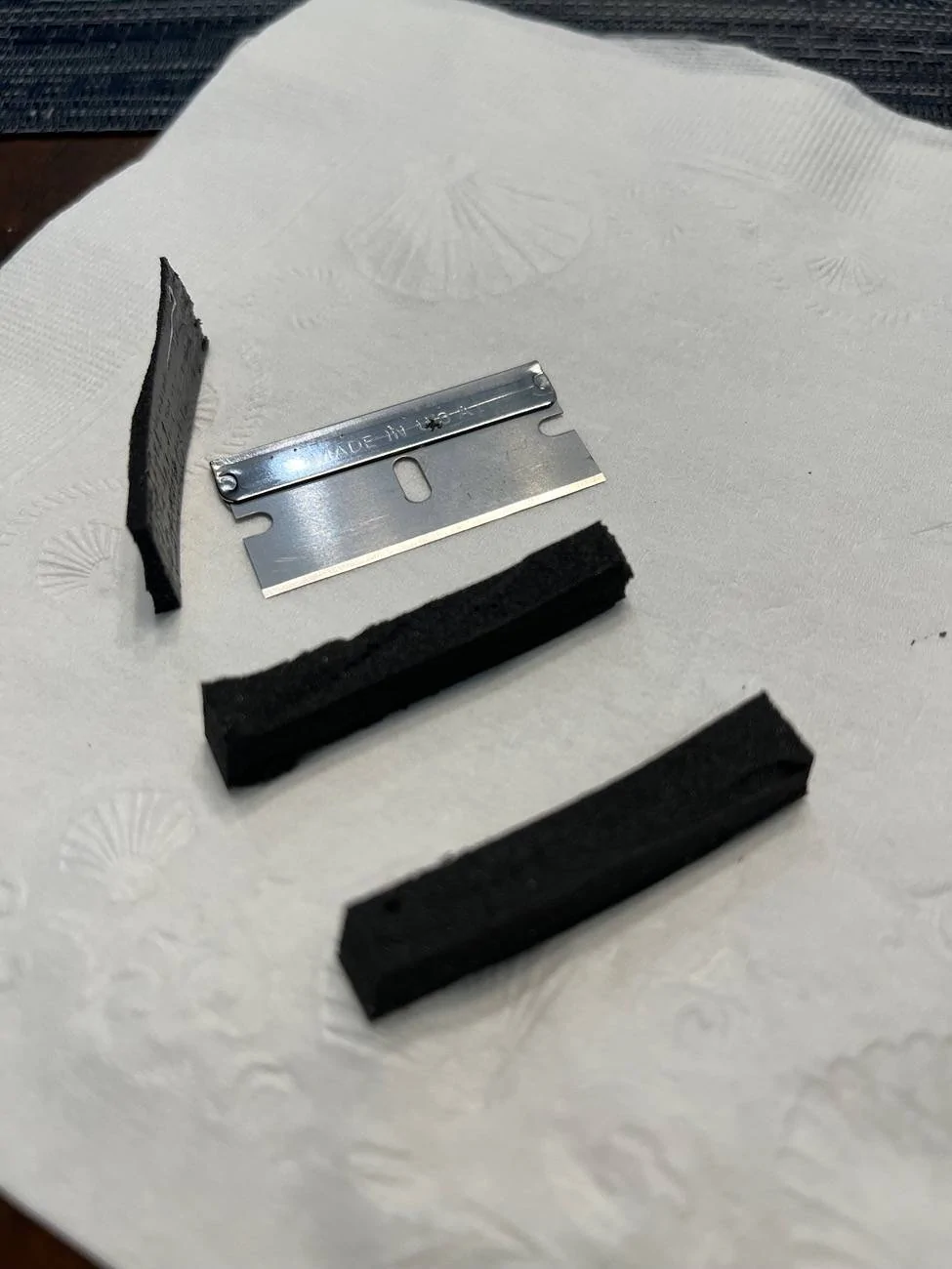

I used the razor blade to remove the tape, then cut in half again from 1/2”width. I used a plastic knife and a screen bead roller to stuff next to the screen. Tomorrow will be the road test. The foam is a little long, should be about 3/4 of the razor blade, I cut full length of blade.
Ford Bronco Sport Bad Dash Rattle on rough roads and expansion joints in the road anyone else? IMG_0743
Ford Bronco Sport Bad Dash Rattle on rough roads and expansion joints in the road anyone else? IMG_0742
