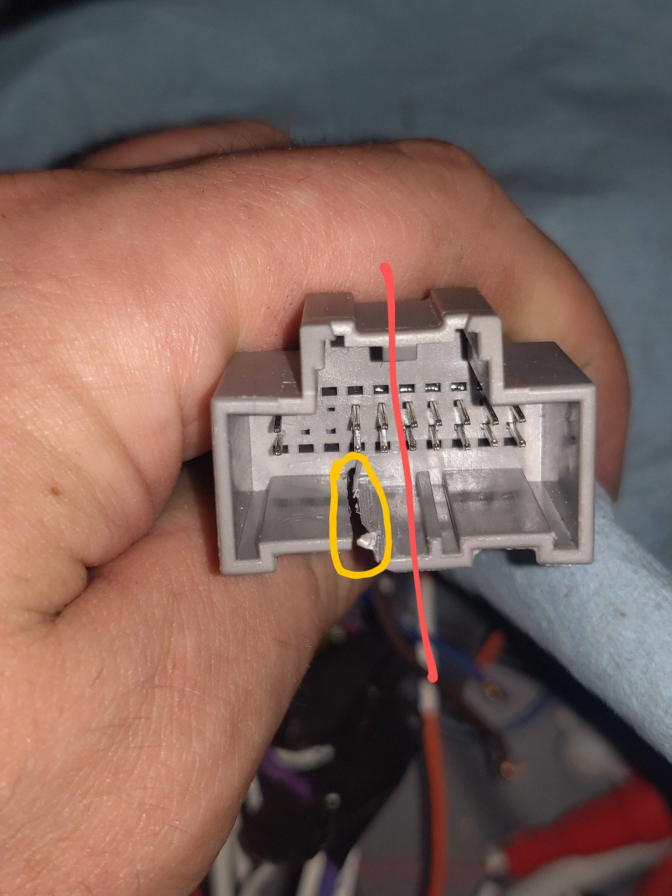

I bought an Axxess AXDSPX-A2B2 (https://axxessinterfaces.com/product/AXDSPX-A2B2) to bypass the factory B&O amplifier/DSP, but the Axxess 20-pin female connector's bottom slot doesn't line up with the factory male connector, figured I'd see what the options are before I start filing the connector or splicing wires.

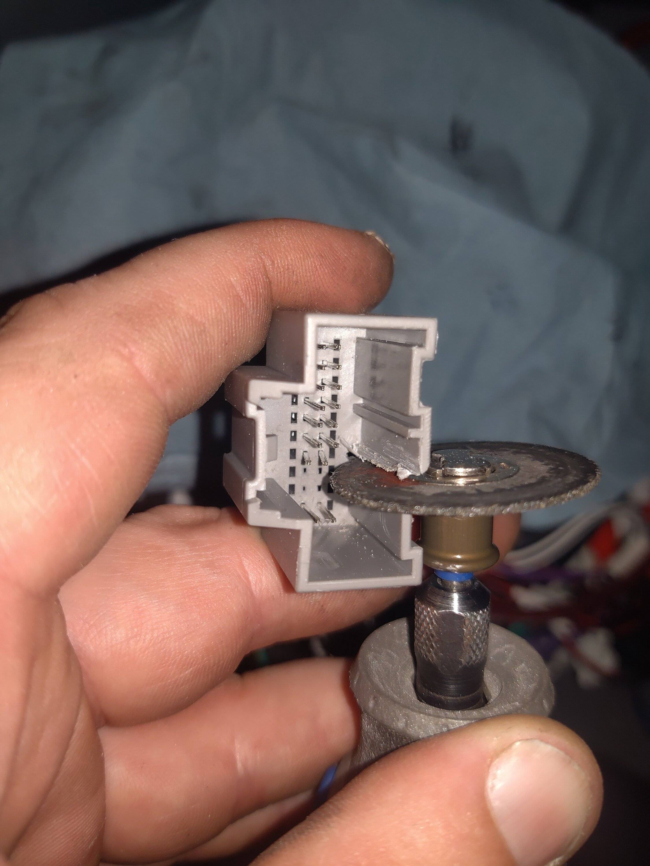

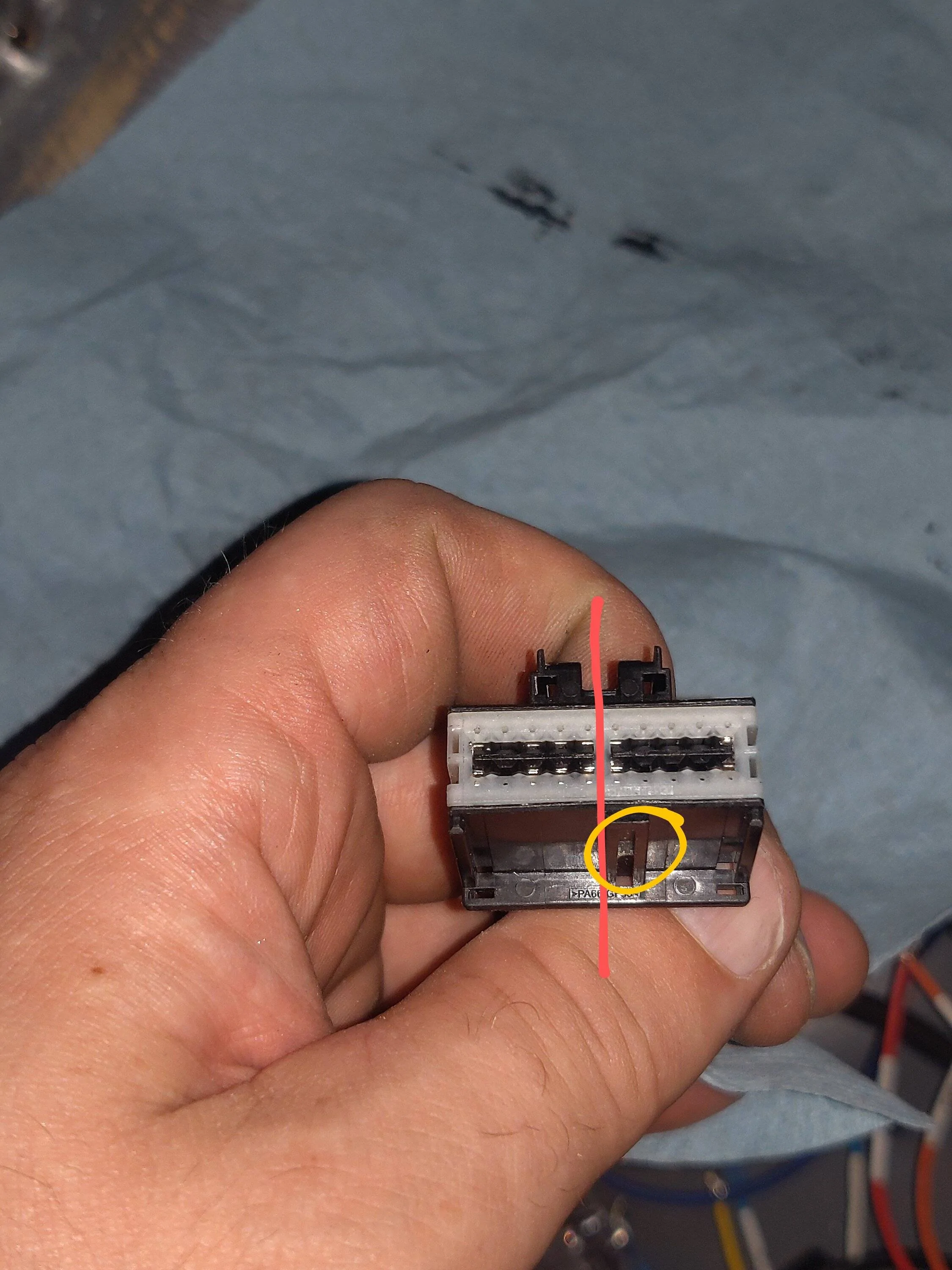

EDIT 7/14/22: Here's what the connector looks like that needs to be modified. I tried to highlight how the black male connector from the car, the one that plugs into the factory amp, has a ridge that is off-center and won't fit into the gray female connector with a slot in the center that comes with the kit. It looks ugly, but when I checked the fitment of it, they connected perfectly so I left it alone. You're basically just trying to widen that center slot just enough to get the off-center ridge into there, it won't take much to widen it enough to fit.

Alright, for anyone wondering, I used the Axxess interface to bypass the B&O factory amp, I just had to cut a slot with my Dremel into the Axxess' female connector so the male connector tab could fit into it. I also had to select "2020 - 2022 Escape" on the Axxess app when I was setting it up, seems to work better than the "Bronco" option, and there isn't an option for the Sport yet. Haven't heard the rear parking sensor yet, but the chimes and the voice commands all work. The fake engine noise still gets pumped in when the music is off, but I don't think the front tweeters or center channel are working at the moment, I'm still working on that.

Some photos of the connectors you are referring to would be grand.
Sure, it'll be a couple days but I'll add some to the first post. It was the only modification I had to do, everything else fit and wired together perfectly.

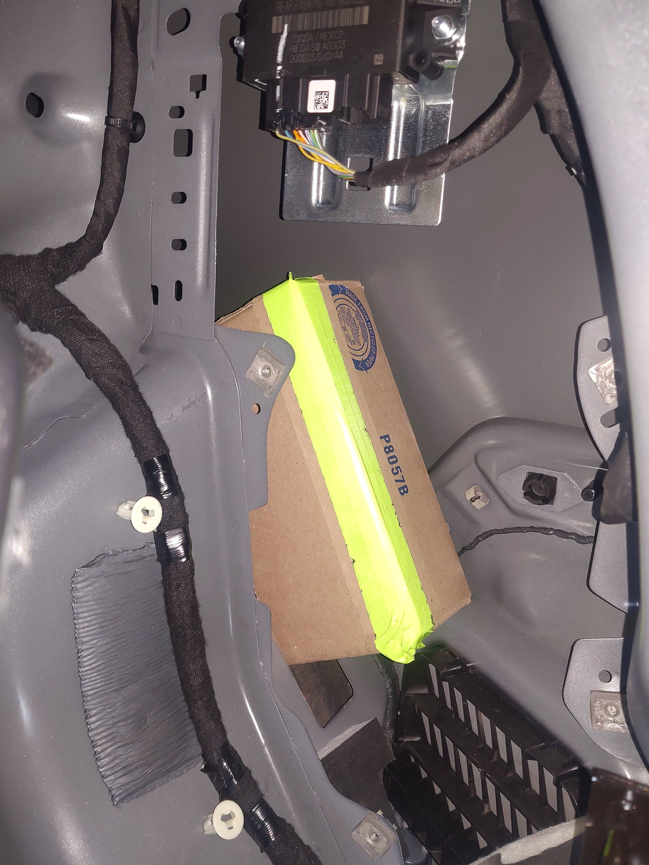

I'm enjoying this thread. Would you happen to have any picture's of the right hand panel in the back removed showing the subwoofer? I'm curious that if the B&O subwoofer was removed a small subwoofer could be installed in it's place? e.g;
https://www.amazon.com/gp/product/B08PVVL5G4/ref=ox_sc_saved_title_9?smid=A270FEYNWLVOMA&psc=1 It's 4.63 x 9 x 2.75 inches
I'll get a picture of that, the factory sub mounted and unmounted, and the factory amp location on the other side. That downfiring sub looks like a great idea, I think mounting it to the floor would be the best option anyway. Hopefully it fits, I'll even make a cardboard box model of that sub for funsies so anyone looking at this can get an idea of how it'll be.

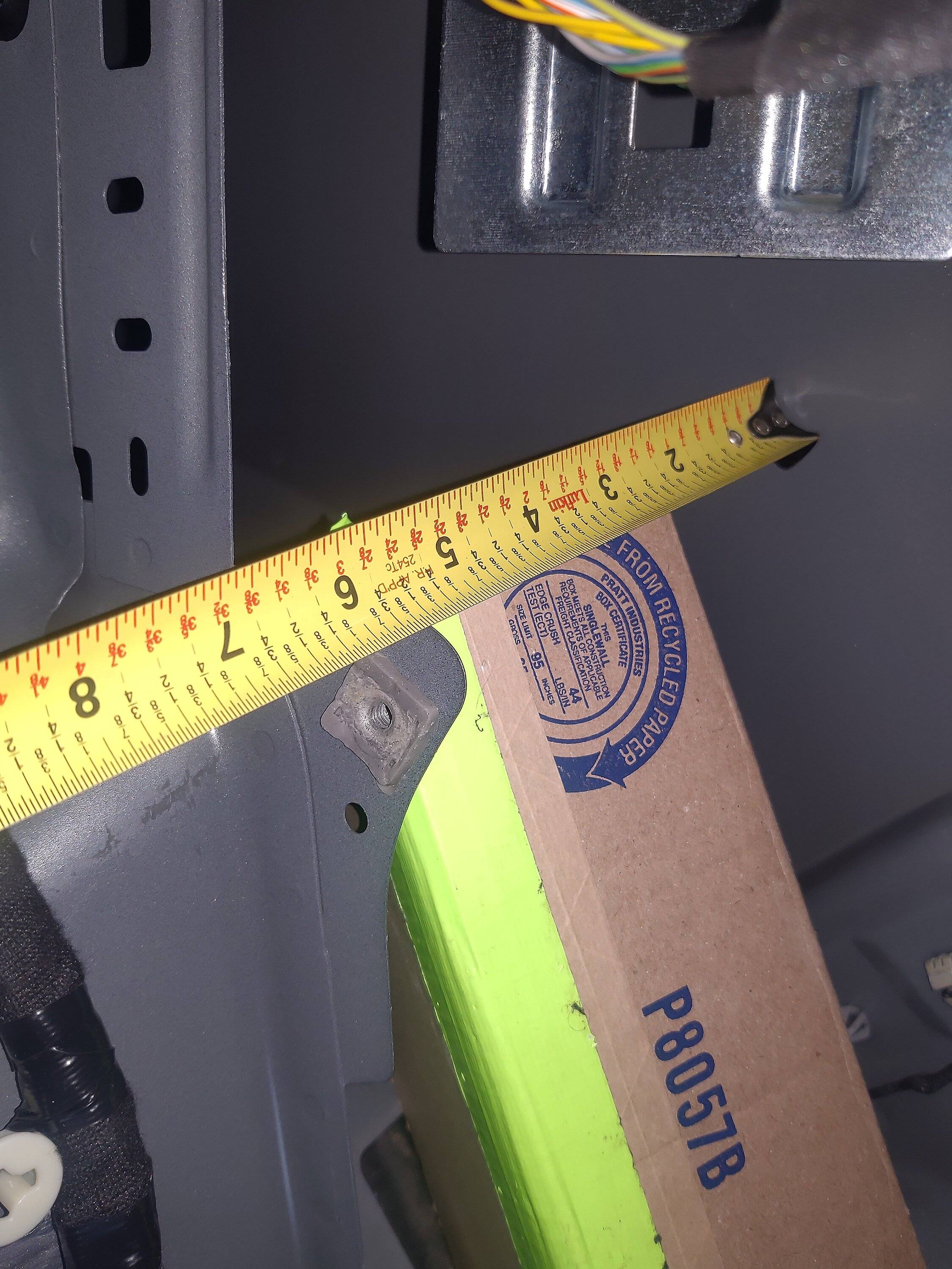

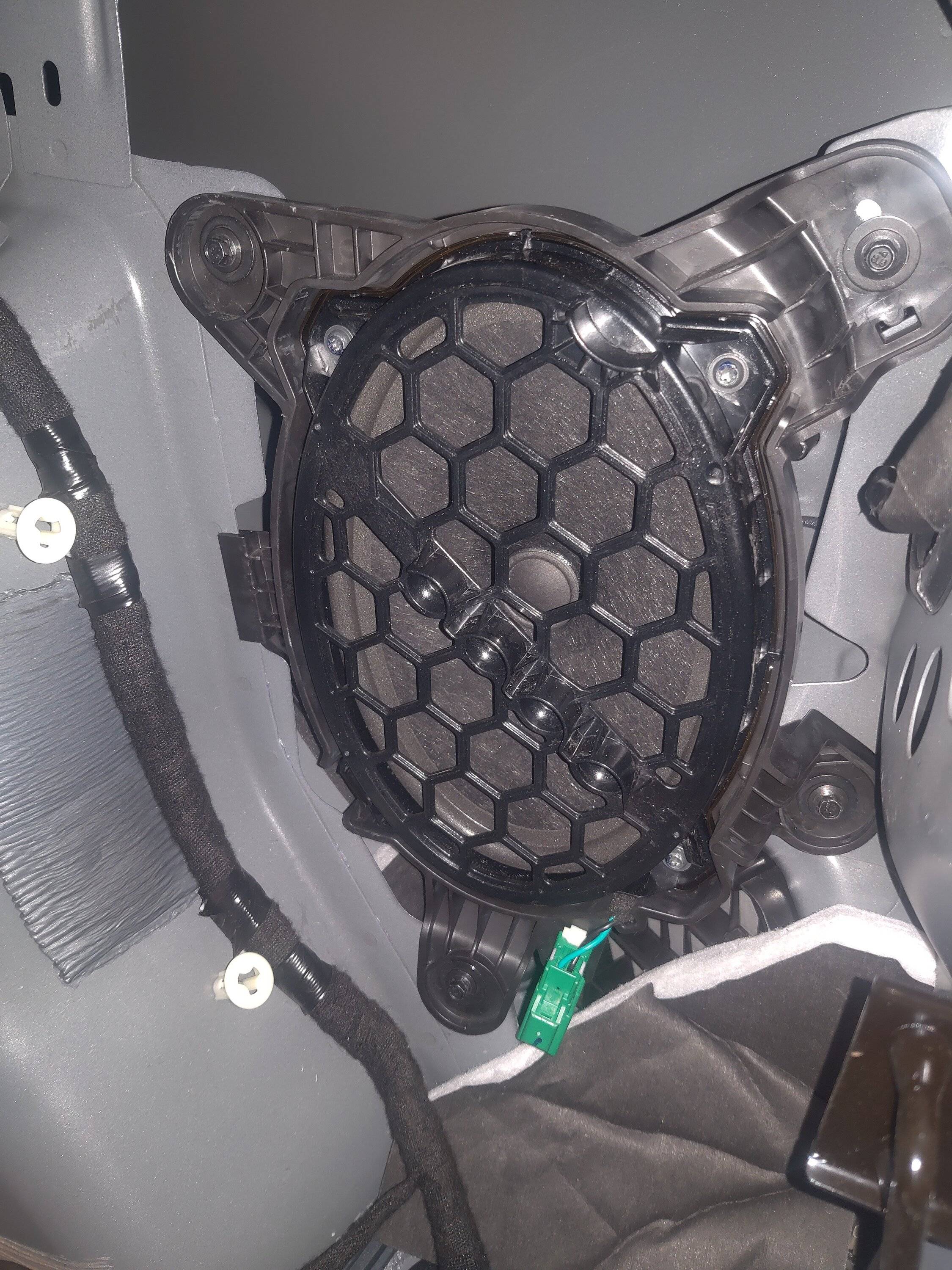

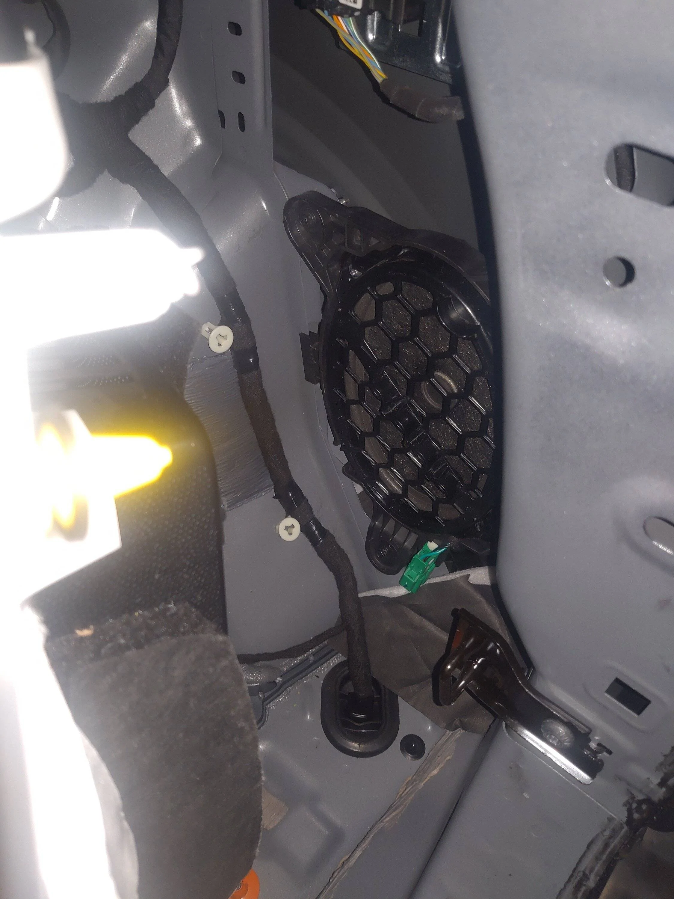

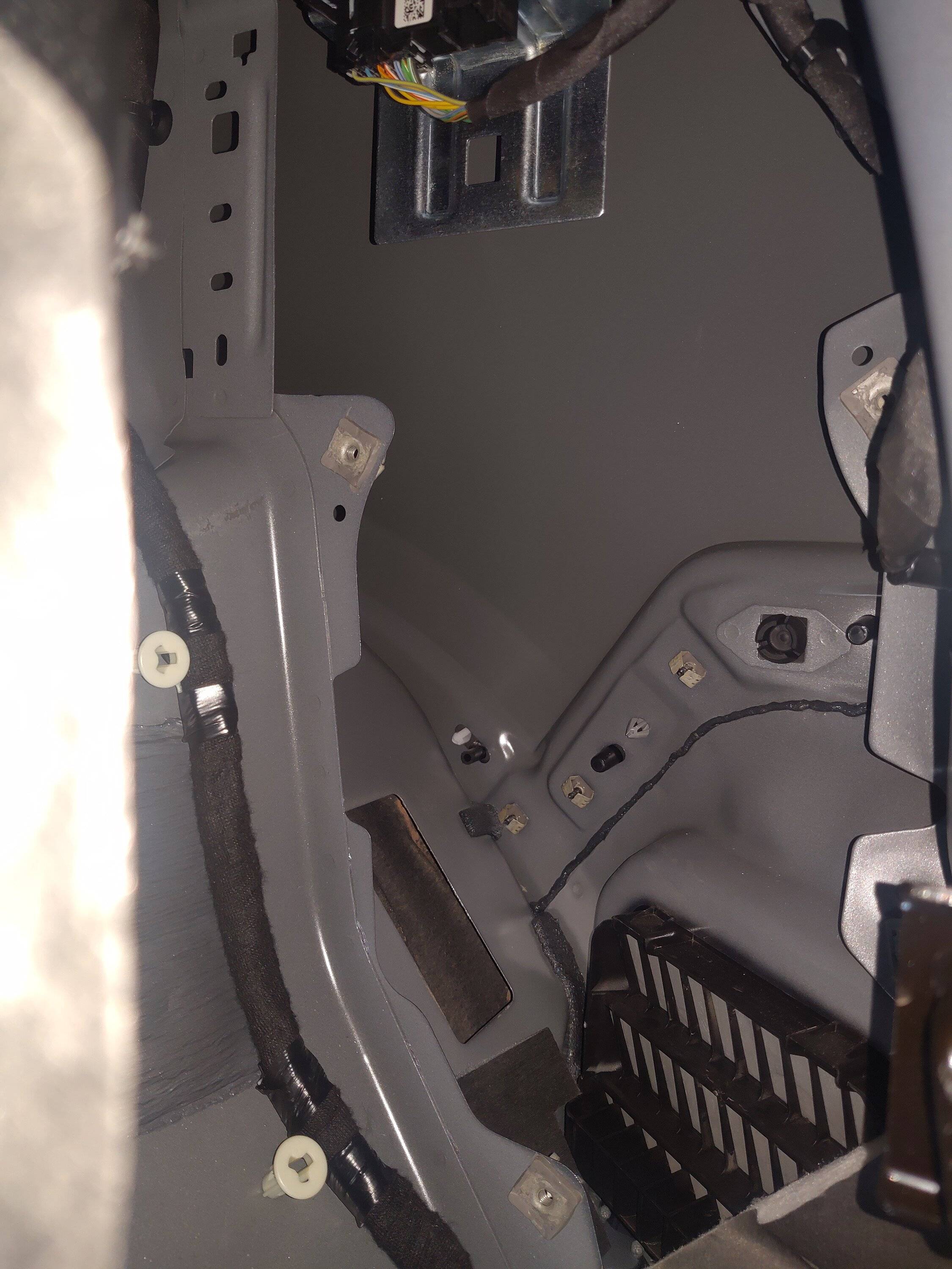

OK, I got what I hope are alright pictures of the rear passenger cargo panel where the subwoofer is. I made a little model roughly the size of that small Pioneer subwoofer, and placed it where I think a viable option would be for it. I think you'll still need to get creative mounting it, but it seems like it's doable.
I'd forgotten how much more narrow it is in the lower rear corner of that void space, you can kinda see that it's roughly 3 1/4" at the narrow point.
I lost the motivation to take pictures of the other side where the amplifier is, but it's very similar. I have more pictures of the amp and the sub by themselves if anyone is curious how the mounting brackets look.

Awesome thanks! Looks like there’s room for even a larger subwoofer if you were so inclined. What are the distances between the mounting points on the sub?
Almost seems you could mount a sub this large into the space. 10" x 8" x 3" https://www.crutchfield.com/S-q2N2qIIWYAe/p_109BASPRON/JBL-BassPro-Nano.html

I think you'll wanna wait until you can make a model of the mounting points, a couple are depressed back into the void space a couple inches and they're not in any sensible position.
https://parts.ford.com/shop/en/us/electrical/other-electrical-related-parts/speaker-13292593-1?pdp=y
