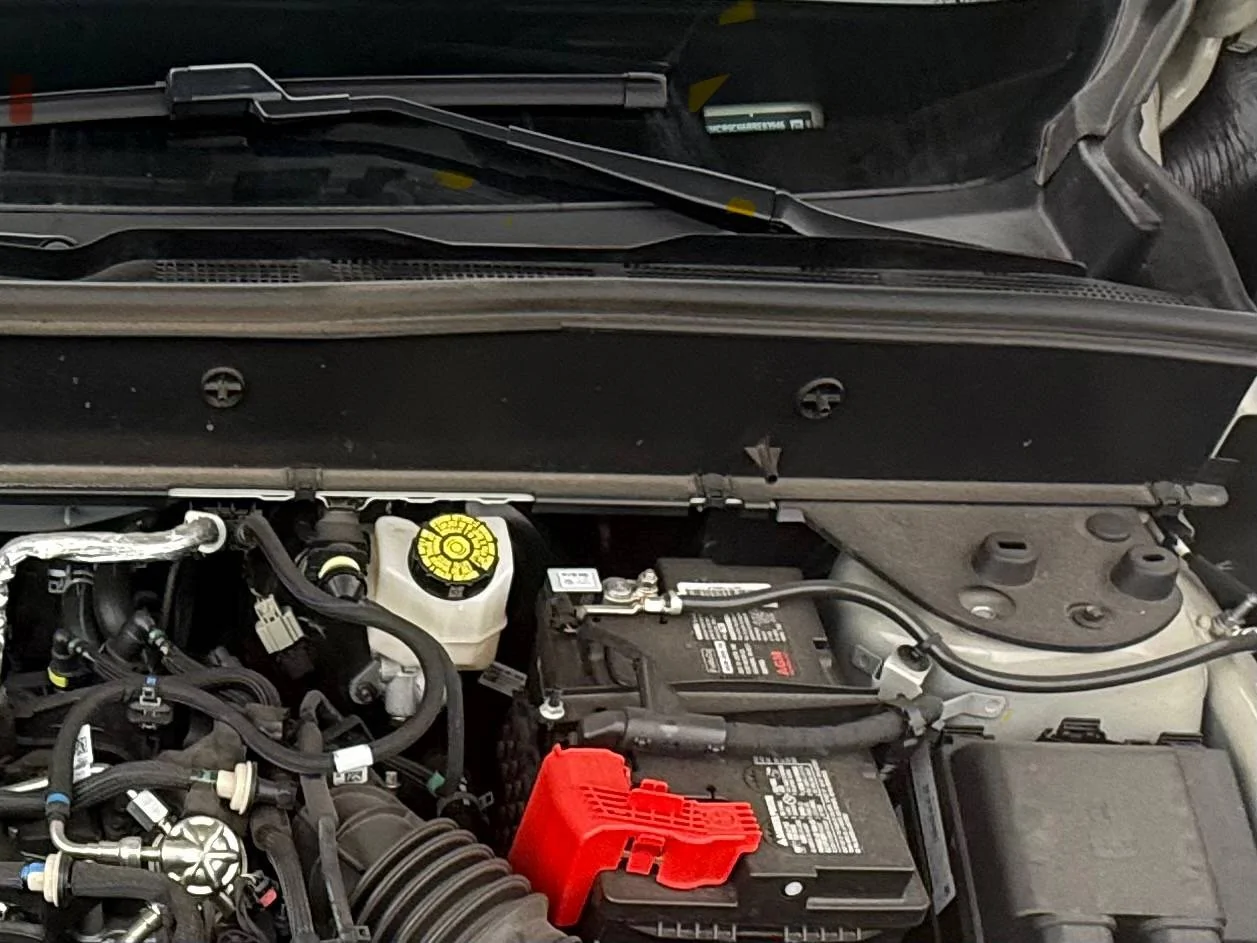

Where did you go in through the firewall to wire up your switch panel?

while I can’t answer for him. I have a 2024 and right behind the battery is a nice big removable grommet. I ordered a replacement on Amazon for $7 that allows cables and wires to pass through. It is right behind the pedals and easy to get to in the cabin.

Awesome, thanks! Any chance I could get a link to the replacement grommet on Amazon?

I ran it through the grommet in the door jam area! I initially tried running wire through the grommet @Troiano27 mentioned but cut my hole too large. It’s not a rubber material you can poke through like the door jam grommet. It’s a hard plastic. (Edit: it’s not a hard plastic just confirmed. Can be poked throug, at the time I for whatever reason felt like I needed a drill bit to get through it) It made every single sound in the engine bay so loud in the cab that I rerouted through door jam and sealed the hole I made in the grommet with flex seal tape.
I than pulled off the panel on the lower left hand side that holds the light switch control and drilled a hole for the wire to come through to the controller. Than bolted it to the panel by drilling two more holes for the bolts to go through. ?
Also don’t be like me, silicon the hole you create immediately after install. It’s turned into one of those “I need to do that this weekend” things for months lol.

just looked. Yeah, the one I bought from Amazon is smaller. I will say this. The one in my 24 OB is rubber. Not plastic. Im sure i’ll be able to slice it to allow cable pass through.
Yep. The grommet on ours is rubber, and was easy to cut. Didn’t remove any material, just a slit with a razor blade.
