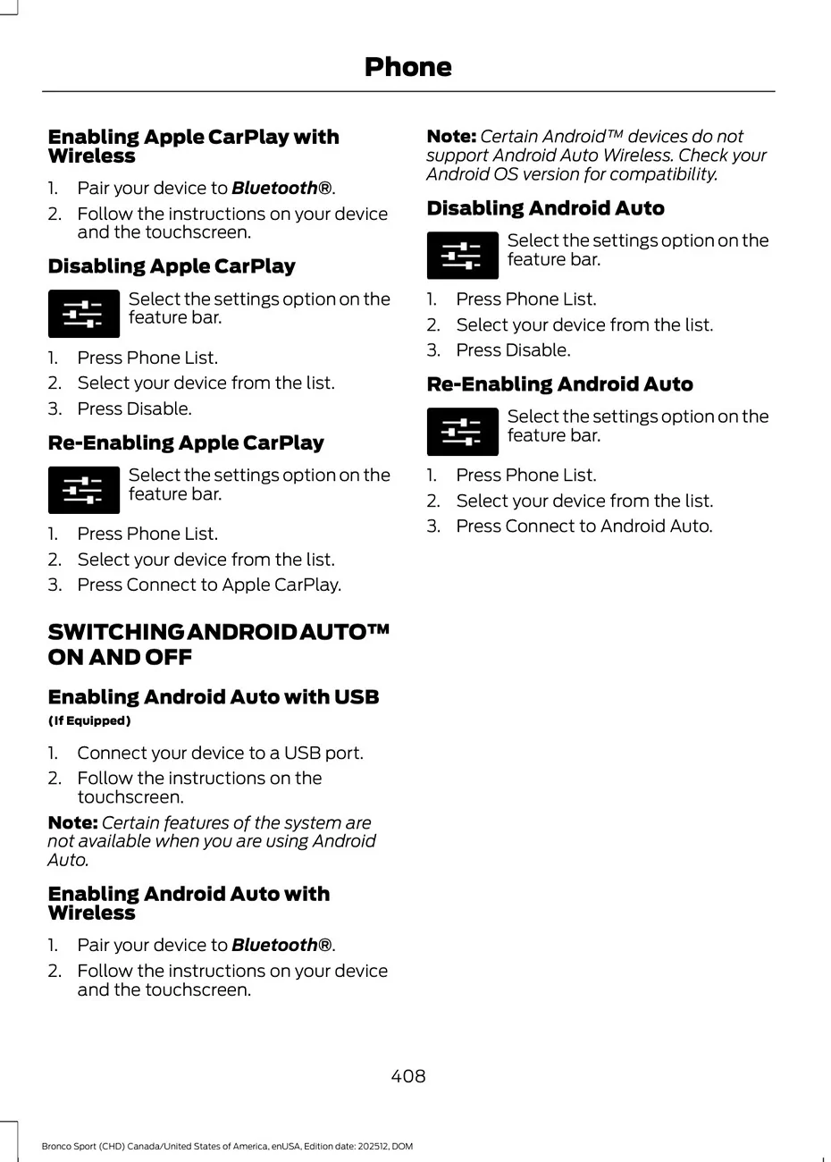

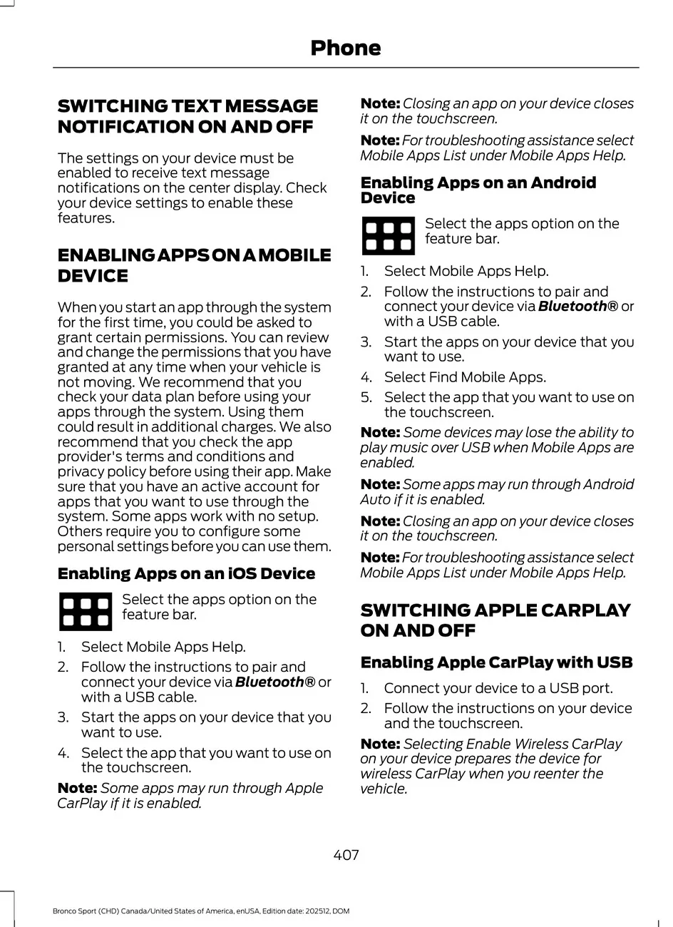

After updating to iOS 26.6, check the following.
On your iPhone, tap on Settings, scroll to General, tap General, scroll down to CarPlay, tap CarPlay. Make sure Allow CarPlay While Locked is on.
Also make sure under Apps, that your Maps apps are selected.
After that, on your center screen, tap Settings, scroll to CarPlay, tap Apple CarPlay, select your device, make sure Apple CarPlay in on and Show on connection is turned on.

The CarPlay button is on, but I don't have a "show on connection" option.
