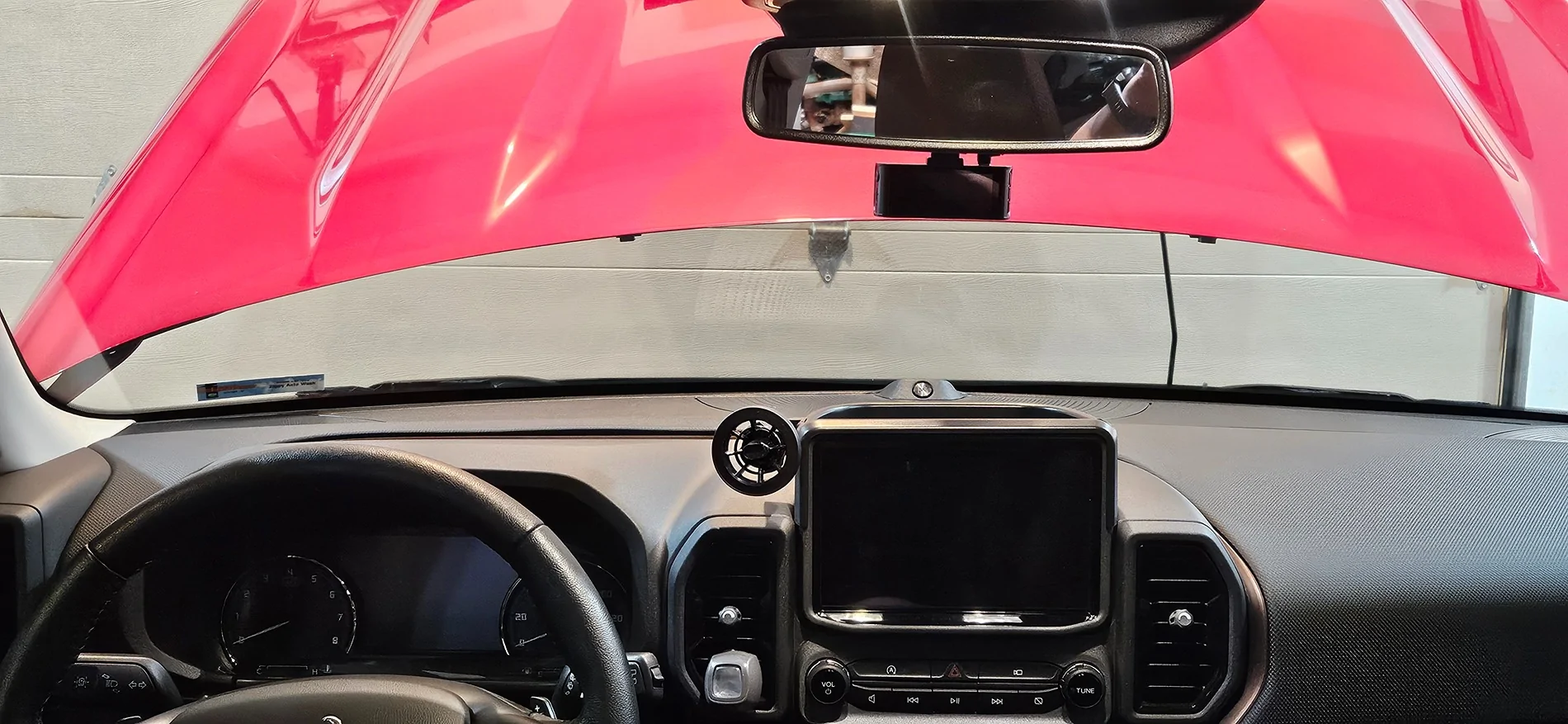

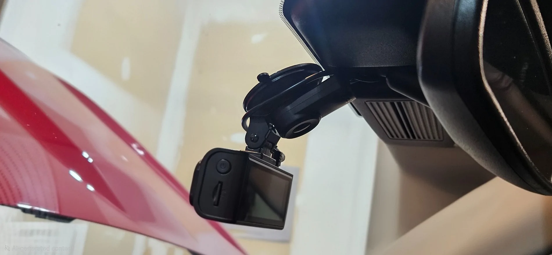

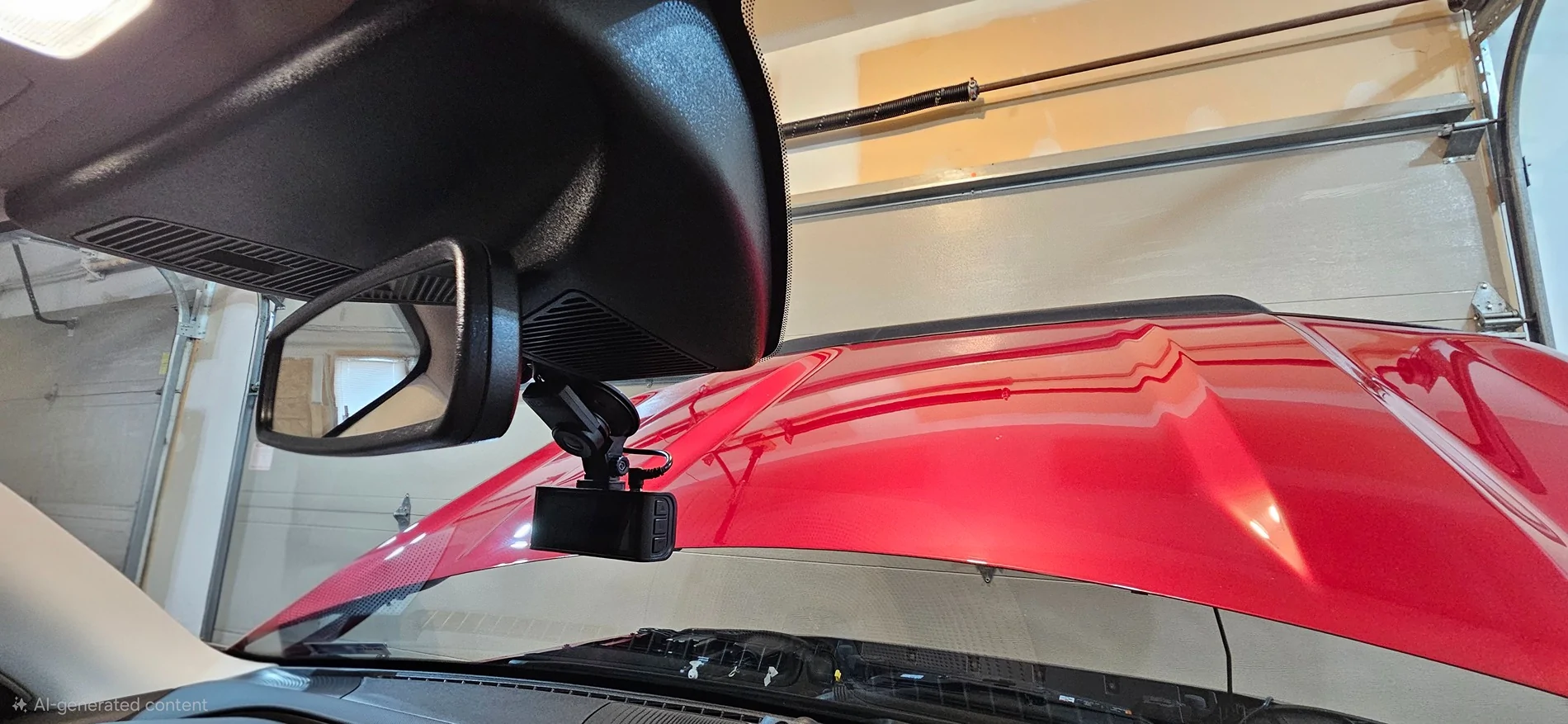

Yes. Did my own. Not difficult at all.
Bought the harness (Amazon - "Dash cam power adapter for Bronco Sport") that tees into the rear view mirror power connector under the plastic trim panel that houses the forward camera. This provides a USB outlet, so the only wire routing was from that plastic trim cover to where the dash cam is located, which I mounted just below that plastic trim panel.
It was very easy using this method.
did you take any pictures of that ?
