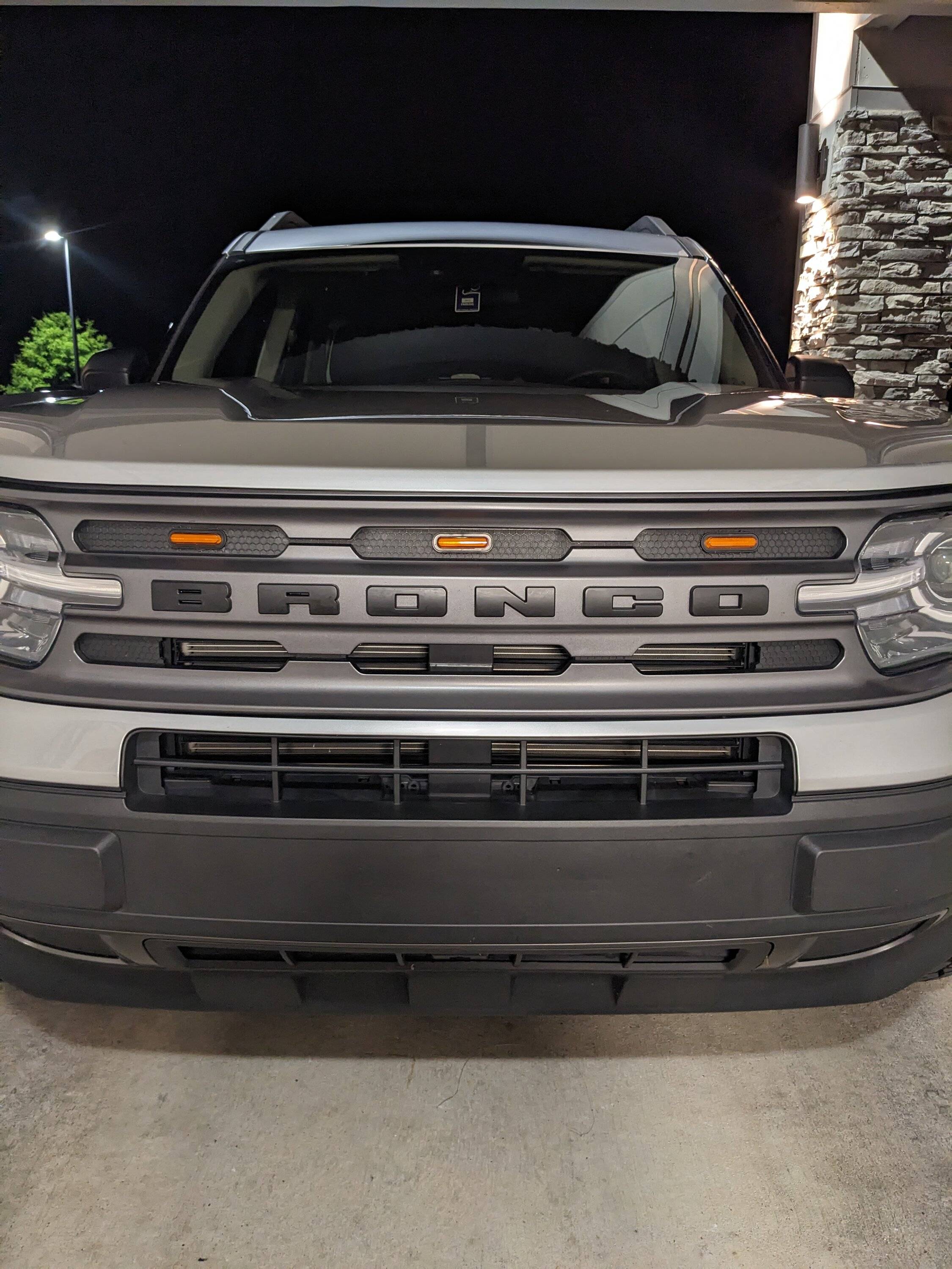

Got it off and all glue cleaned off took me bout 30 mins easy peasy. Gotta say wife was right on this one gives it a cleaner look I think
Ford Bronco Sport Advisement on removing Aeroskin II textured hood? PXL_20230520_021139239.MP
Do you have a link to your raptor lights? That’s exactly what I’m looking for but have only seen raptor lights on a different grill

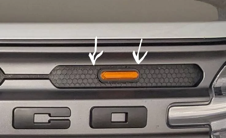

Thanks bro, yeah it was my first rodeo doing aaaanything like that so I was nervous. Just go slow and be patient, may i recommend (what I didn't do and should have) is try to mount the lights to the top of that plastic part so it's flush with the upper part of the grill, that way you don't have to worry about them being crooked or anything.
attached this pic for reference, try to line the lights up flush with that if you can. Only thing I would have done different, cuz i'm ocd and if they are slightly crooked it drives me nuts. That just reduces that risk.
