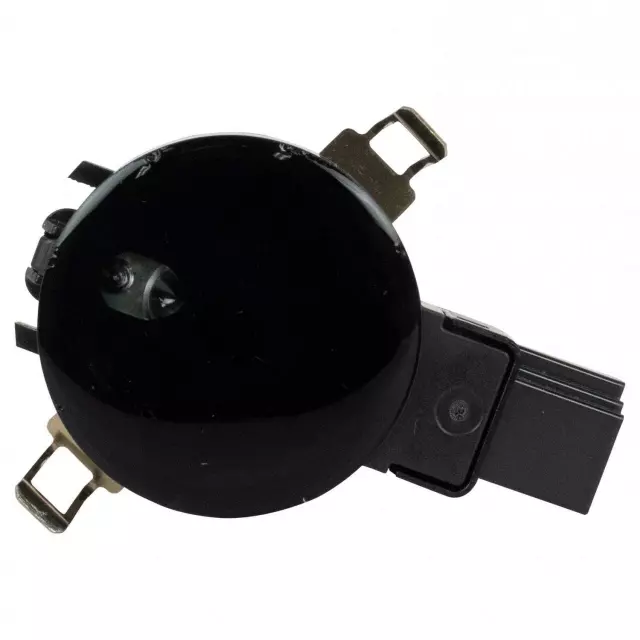

Interesting. Because your writing on the sensor is also at an angle, whereas mine is straight across.
Ford Bronco Sport Add Auto-wipers? IMG_3971
I see what you mean about the connector though. I can just pull that clip and rotate it to the other two pins that are there. 😊
they are different part numbers also yours is a Lu5t the black one is a Lt7T (thats what it looks like for my eyes.)

The correct part number is LU5Z-17D547-A.
The clips are loose!
Take it out and put it back in crooked. :muscle: :muscle: :muscle: :muscle:
I decided to keep this as OEM as possible. I ordered the proper electrical connector (which cost more than the sensor) as well as the wiper stalk.
