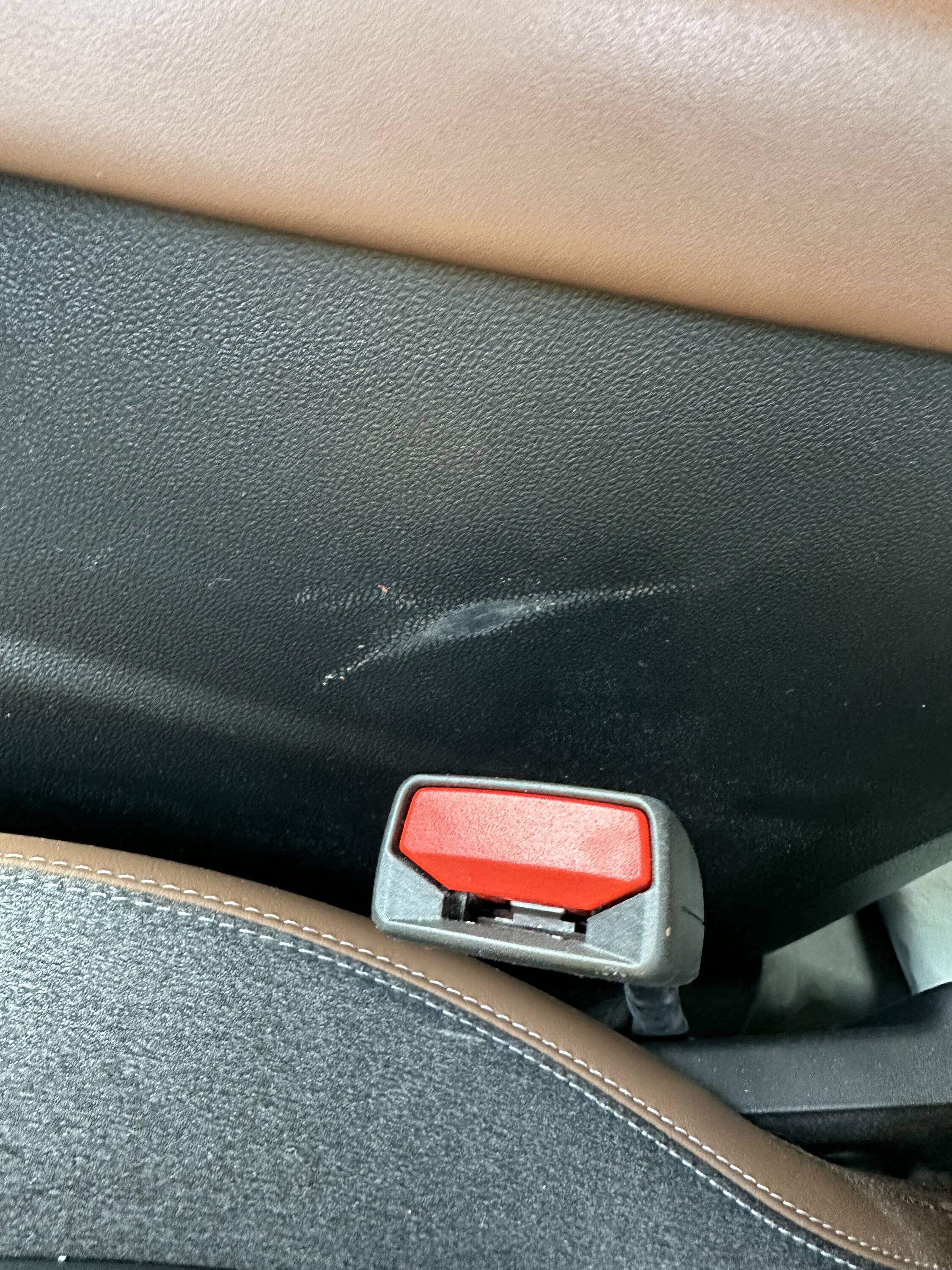

Hey all, so I’m having a couple of problems that I don’t know what to do about.
The first one is I just noticed today that my seat belt is rubbing the plastic on the arm rest raw and I don’t know how to go about getting it fixed or prevent it from rubbing a hole into the plastic. Every car I’ve owned has never had this problem except the 2022 Escape my parents bought from me that my dad said is doing the same thing. I’ll post a picture of what I’m talking about to this post.

As to the belt rubbing the plastic, does your BS allow for belt adjustment height by the door pillar?

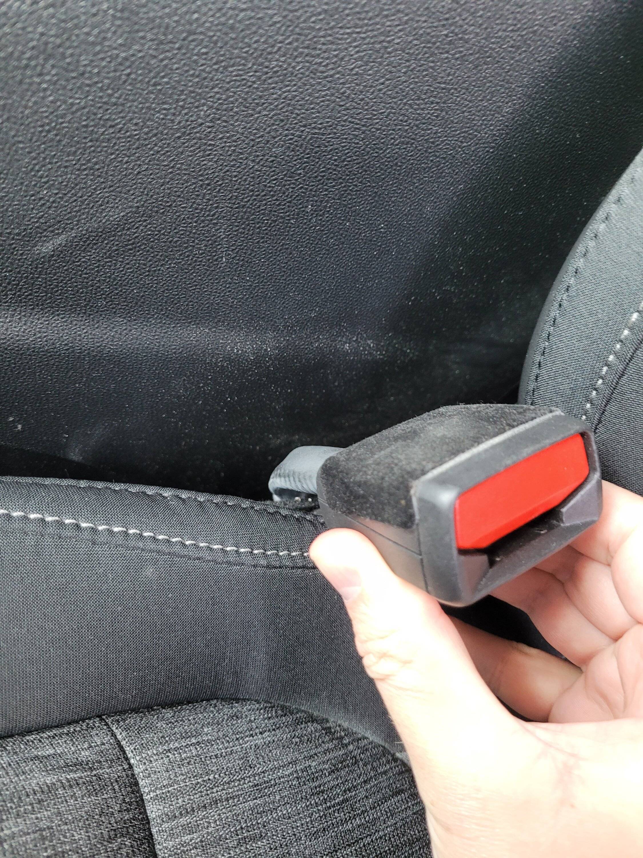

It looks like your seat belt buckle is missing a felt piece that would prevent this from happening.
Ford Bronco Sport A couple of issues that I’m having SEATBELT
I second this, you can also buy felt with adhesive backing from just about any hardware store or amazon for cheap. I put felt on my last cars buckles for this very reason.

This is cheap enough that you can set aside the "hook" strip and just use the "loop" side. I used to get 2" rolls and then drop a strip on the driver window ledge to avoid getting "trucker elbow" on my lazy left. I don't know how the Bronco interior door panel would do with the adhesive- haven't tried it.
By the way, I have the felt on my buckle and the console still gets some minor scuffs there. Cleaning it real good hides most of it.
Yup I just got back from the dealership and they took pictures and put a felt pad on my seat belt buckle. They gotta do the same with my dad’s Escape because they didn’t put it on his either. They must’ve shipped some without that piece.
