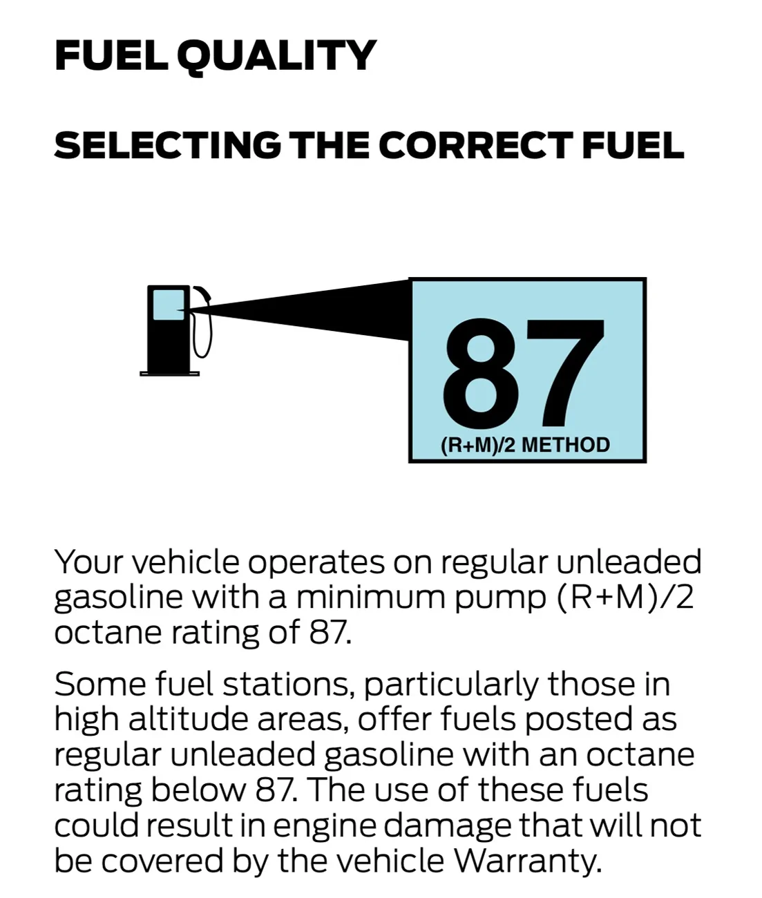

I suspect for my use, not really towing or anything I should probably stick with 87 and maybe every 5th tank fill it with 93 to clean it up a bit. I might be wrong, I'm still learning about this, so if there is no benefit using the 93 as far as helping keep crap out, then let me know, I'll save the 21 extra dollars :)

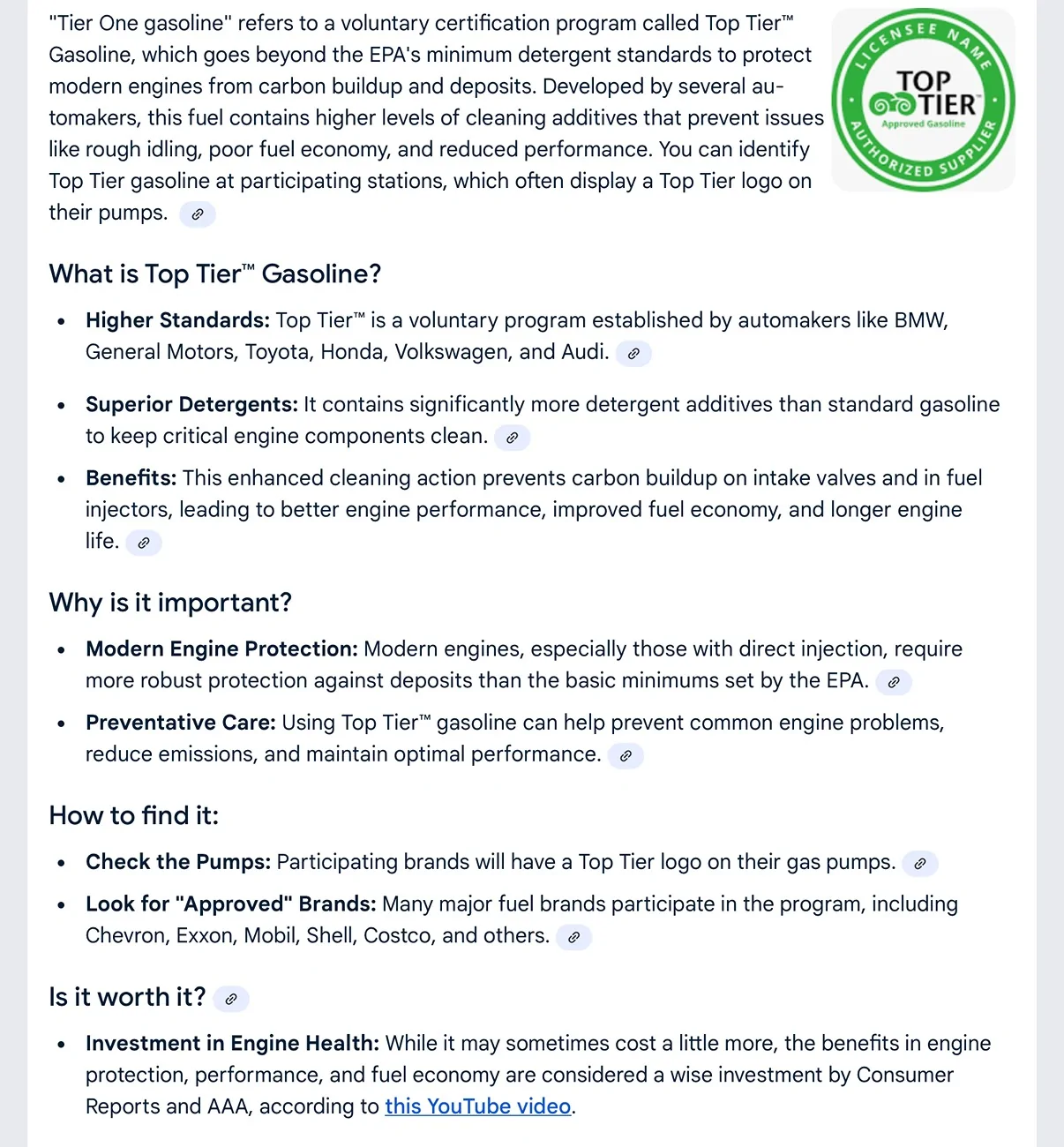

93 from the same gas station isn’t any cleaner than 87, it’s higher octane which prevents knocking in higher compression engines or engines tuned which require higher octane because of spark settings. For cleanliness, you want to use tier one or top tier gasoline which can be different between different gas stations.

Thanks for the explanation! The Mobil that I use is indeed Top Tier according to logos on their pumps.
