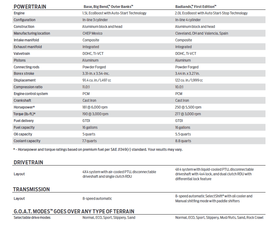

Yes, it was from the Ford site. Bronco Sport Technical Specifications. The oil cooler is for the dual clutch system and the manual shifter refers to the paddle shifters in manual mode.

IIRC the oil cooler is for the PTO and not the rear diff but either way the 1.5's do not have it
