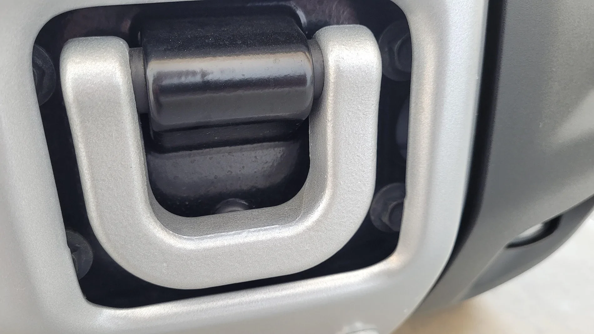

I don't think I'd even trust the push bars on the Sasquatch or Black Diamond packages. The recovery mounting brackets look like they might be useable?
Best photo I could find, but the angle isn't the greatest. I'd imagine the bolt pattern is the same on all the similar offerings.
Ford Bronco Sport 2025 BSBL Sasquatch Winch? Recovery Squatch
Now if somebody comes up with a mount that also extends to the recovery hook points on the Badlands, we might have a contender.
I'm not willing to rip off my bumper to investigate further, but it looks like the recovery points are just bolted on. They could most likely be swapped out without too much trouble. It looks like 4 bolts in the corners, but possibly more out of view?

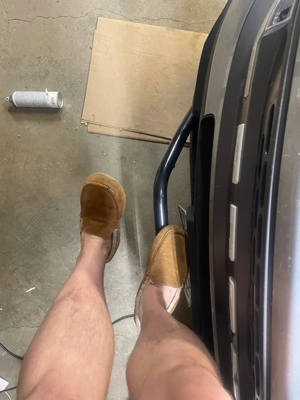

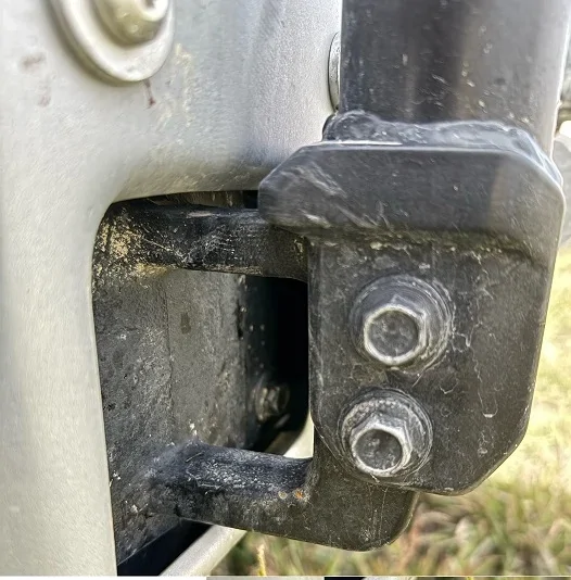

The ford ranger lift is actually quite solid on my badlands., it uses The factory badlands (the lower trims don’t have the subframe attachments, so yes it is ONLY cosmetic on non BL trims) attachment has plenty of strength. It uses the recovery point as a Bolt mounting point and the actual steel is sufficient to Hold say a 275 lbs man standing on it and bouncing, in a straight vertical position with no issues. The front shocks depress , but the bar doesn’t move. The recovery points are sufficient to pull a 10 inch by 35 foot pine tree when the BS is in reverse. I mounted my FRL bar using grade 8 , 3/4 inch all thread. It arguably is one of the strongest part of the vehicle, though I likely increased vehicle weight about 60 lbs.
Ford Bronco Sport 2025 BSBL Sasquatch Winch? IMG_7598
As for winch pull capacity.
Few things about winches
A “5000 lbs winch “ is only 5000 lbs on first drum wrap, goes down about 5% per wrap.
Mire factor is “how stuck you are” up to
Mid point of wheel is 1x vehicle weight, top of rubber is 2x, top of hood is 3x.
Since the BS has an ECU computer located behind the middle of the front Fender(28 inches high iirc I’m sure data is on here) basically You ain’t getting mire factor 3 in anything liquid ish and keeping a long running vehicle.
You can EASILY recover a 4000 lbs vehicle Mire factor 2 vehicle(effectively a 8000 lb vehicle, though BS is unlikely to get a true 2x due to skid
Plates), with a 5000 lb winch . Simple use mechanical advantage and a good Anchor point. Winch leaves the bumper, goes to recovery tree , through a pully, then back to bumper. (If front I’d recommend a bridal to reduce load). Recovery is 1/2 speed and twice power. Add a second pully near vehicle and you can get 1:3 sped and 3:1 power,
Now I’m Fairly certain my Tow points (front, rear, ANY), are NOT sufficient to withstand 12000 lb of pull, but also what did I do to get there??? I could legitimately go straight up and only need 4500 lbs of pull… there is a reason tow trucks exist.
That is interesting - I've not looked at the two mount points on the BL vs. the Big Bend - but yeah, it would never have supported my weight standing on it like that on hers. Glad to see it.
