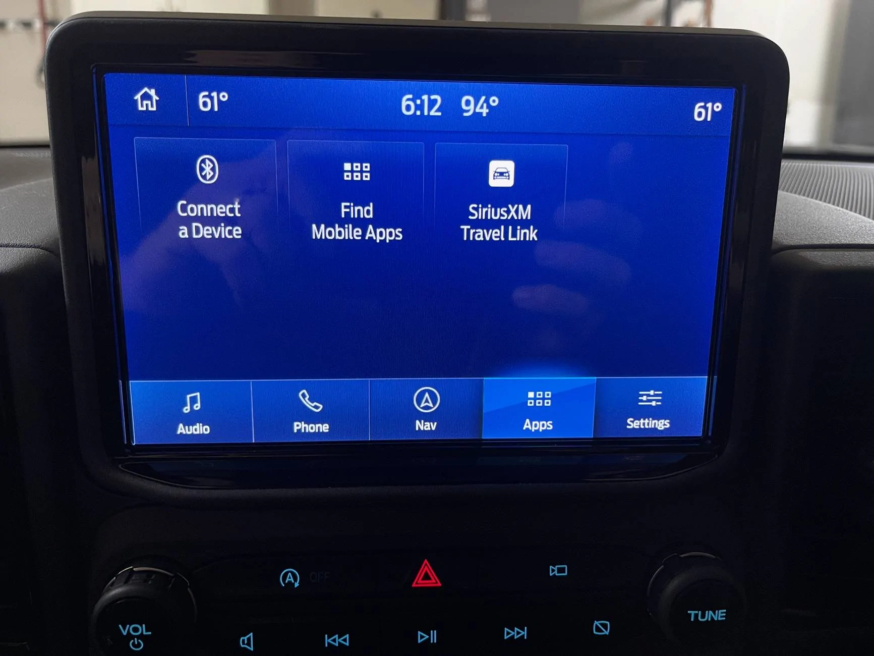

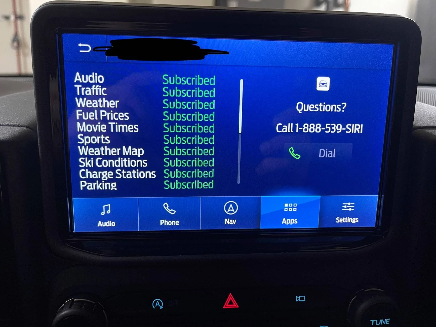

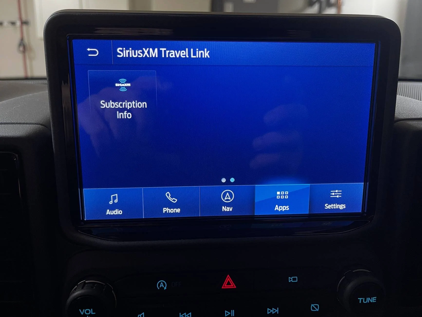

So under the Apps -> SiriusXM Travel Link which options show subscribed? Mine take a minute to populate all the services.

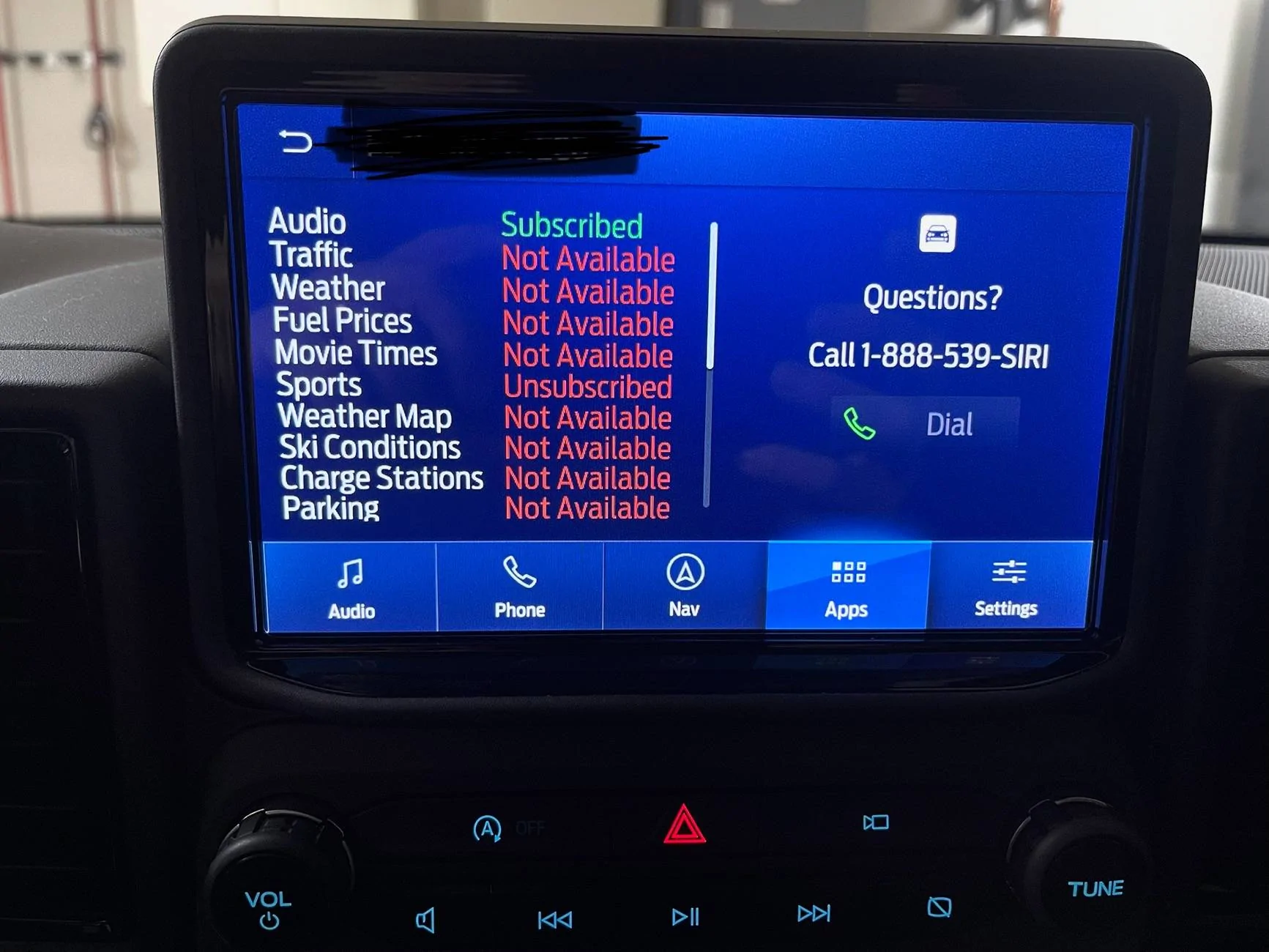

That’s it thanks for posting @Jmuns
@DSB Snag did you wait long enough to populate?
Yes. It does initially say most are unsubscribed. Last time I escalated this with Sirius they had me to a system reset. Didn't correct the issue and my wife lost all her navigation favorites and history. She was pissed.

Your screenshot shows you have the Ford Nav (Sirius Traffic works with Ford Nav)
You checked the Apps Subscription info which shows everything is Subscribed except Traffic which shows Unsubscribed
You are paying for both the SiriusXM subscription and the Traffic subscription
There is nothing else you can do - the issue with Traffic not working is with Sirius not your vehicle

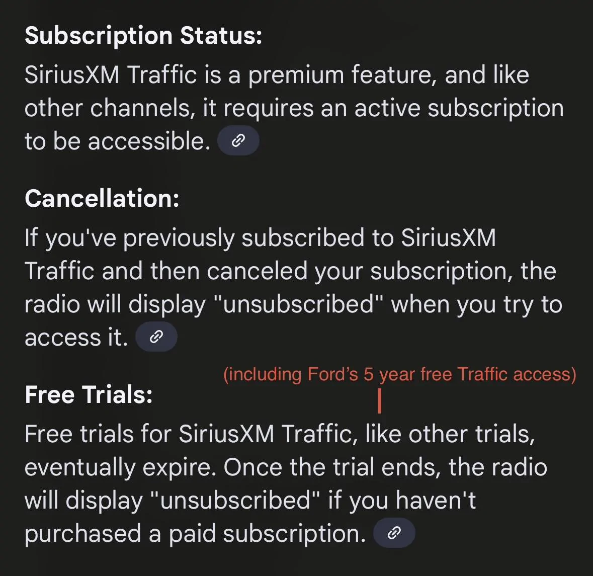

What I think happened is back in 2022 or whenever your vehicle was delivered to you, Sirius Traffic worked during the 1st 3 months which is the SiriusXM Trial Period (3 months)
However if you are 100% positive you or your wife never enabled the SiriusXM Trial including SiriusXM Trial was not enabled by the dealership or someone else for your vehicle, then my theory is not correct. But it might be hard to remember exactly 3+ years ago.
My theory on the free trial relates to what is described in the attached pic - Ford provided 5 year access to SiriusXM Traffic as part of obtaining the vehicle with Ford Nav.
Then when the free trial to SiriusXM ended, so did the Traffic subscription which is why you still have access to other Sirius services - only Traffic service shows Unsubscribed
It’s a simple matter for a Sirius software engineer or Sirius database person to modify your account to enable Sirius Traffic
If you want to send me a (private) message through the Forum and provide me with your first name and phone number, I can give you a call and walk you through the steps and in fact you also should request that Sirius credit your account for the time you’ve owned the vehicle and paid for Sirius Traffic because Ford provides SiriusXM Traffic for free for 5 years
