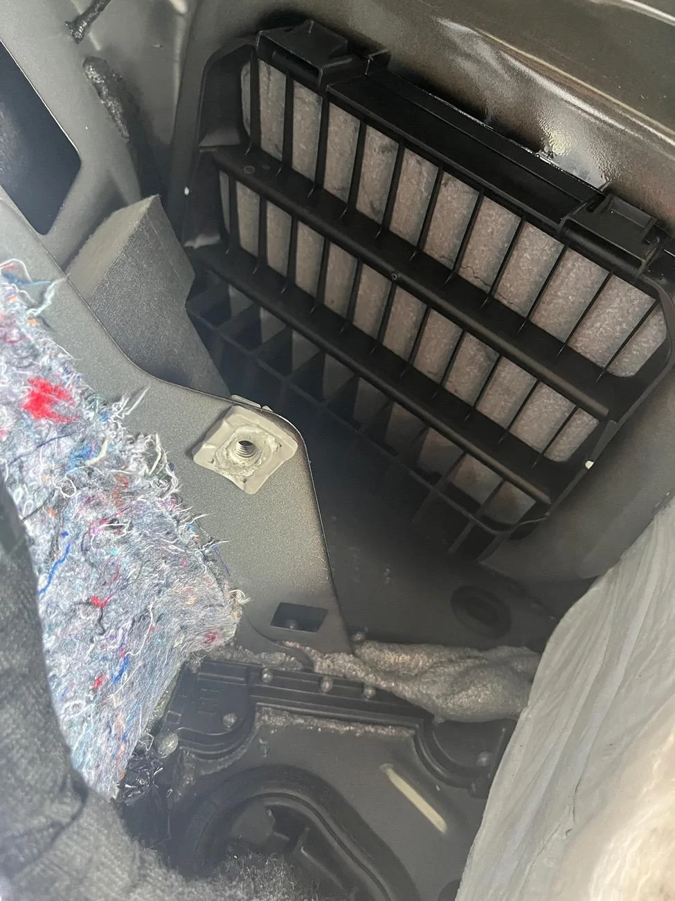

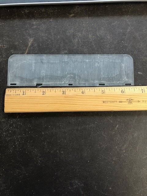

Ever since I purchased my Bronco Sport new, I have experienced an annoying flapping/thumping noise coming from the rear cargo area both left and right side. The noise presents itself when traveling over 40 mph. It was hard to pinpoint the source as I believed it was coming from underneath the vehicle. With it not making any noise below 40 mph, I thought it had to do with something that was flapping caused by wind speed. I focused under chassis covers that are mounted below the fuel tank and extending to the rear fender outer wheel wells. Noting I did would eliminate the problem. Finally, I crawled into the cargo area while someone else drove the vehicle over 40 mph. I located the source of the noise coming from the cargo area left and right trim panels. There are two molded in vents on each side where I could hear the noise coming from. Behind these panels are what is referred to as the "rear Air extractors". These are basically plastic vents with rubber flaps that allow air to exit the vehicle cabin for air circulation. I removed the inner trim panels and a lower exterior trim panel to expose an opening large enough to fit my hand between to access the air extractor. I then pulled on the flaps to tear them away from the vent. There are 3 per each side. They are made of very thin, .018', flexible rubber. What was happening was that air moving over and in between the outer fender wells caused these rubber pieces to flap resulting in this constant thumping/ flapping noise. I put the trim panel back in place and test drove the vehicle, and problem was solved. No more thumping/flapping over 40 mph. In my opinion, this is clearly a design defect caused by using a method to make the function of venting cabin pressure the cheapest way possible with clearly no testing. This should have been caught during design testing. There are so many cheap shortcuts Ford has made to lower their cost and not provide a proper function that I won't go into further in this thread. Regarding the function now of these air extractors without the rubber flaps; it will make no difference without the flaps because the vents are covered behind insulation, so they were nonfunctional anyway. hope this help anyone else struggling with this problem. There are plenty of videos out there that show how to remove the inner trim panels.
Ford Bronco Sport 2021 Ford Bronco Sport Thumping/Flapping noise IMG_5595
Ford Bronco Sport 2021 Ford Bronco Sport Thumping/Flapping noise IMG_5596
Hi. Very informative. Can you please either tell me how you removed it safely or send me the video link showing the same. I don’t want to break anything. Thank ok

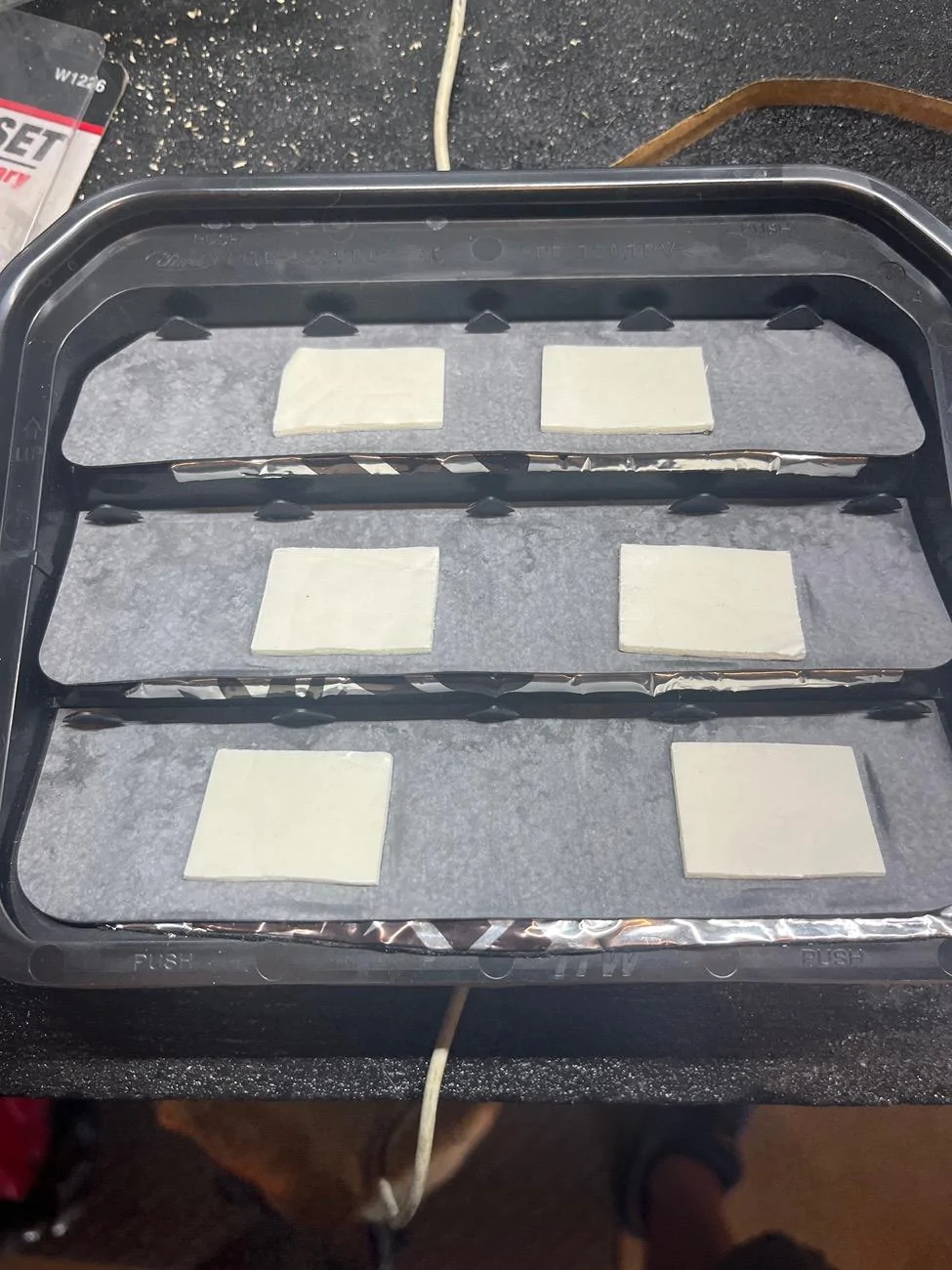

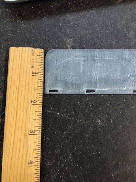

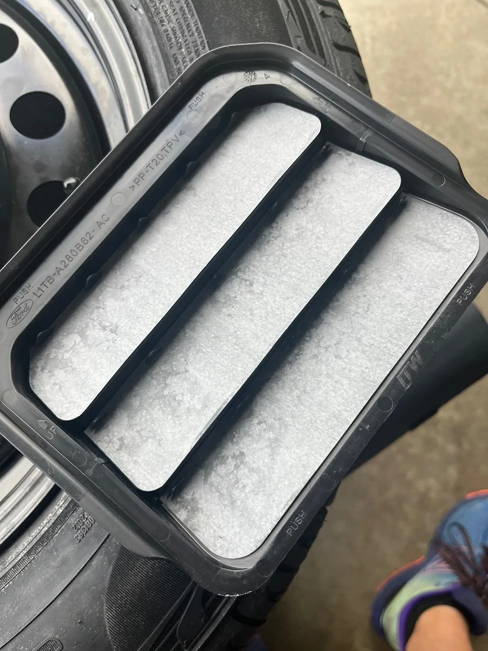

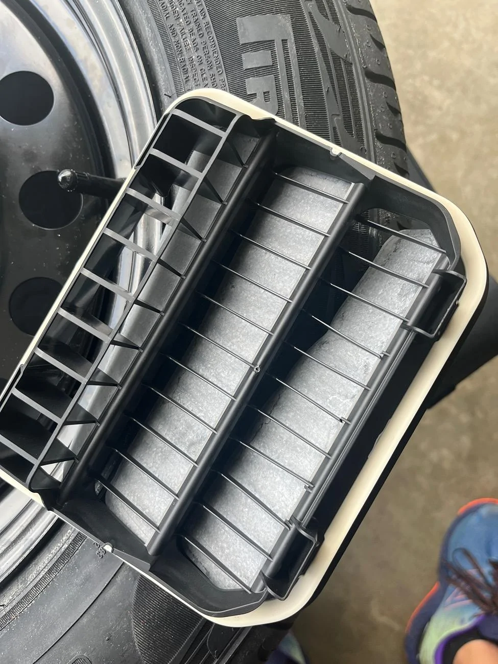

I pulled the vents on both sides and added doubled sided foam tape to the flaps. It adds enough weight that they won’t flap around as easy. No issues up to 80mph, now.
Ford Bronco Sport 2021 Ford Bronco Sport Thumping/Flapping noise IMG_3120
Ford Bronco Sport 2021 Ford Bronco Sport Thumping/Flapping noise IMG_3119
Ford Bronco Sport 2021 Ford Bronco Sport Thumping/Flapping noise IMG_3118
Ford Bronco Sport 2021 Ford Bronco Sport Thumping/Flapping noise IMG_3117
Ford Bronco Sport 2021 Ford Bronco Sport Thumping/Flapping noise IMG_3116

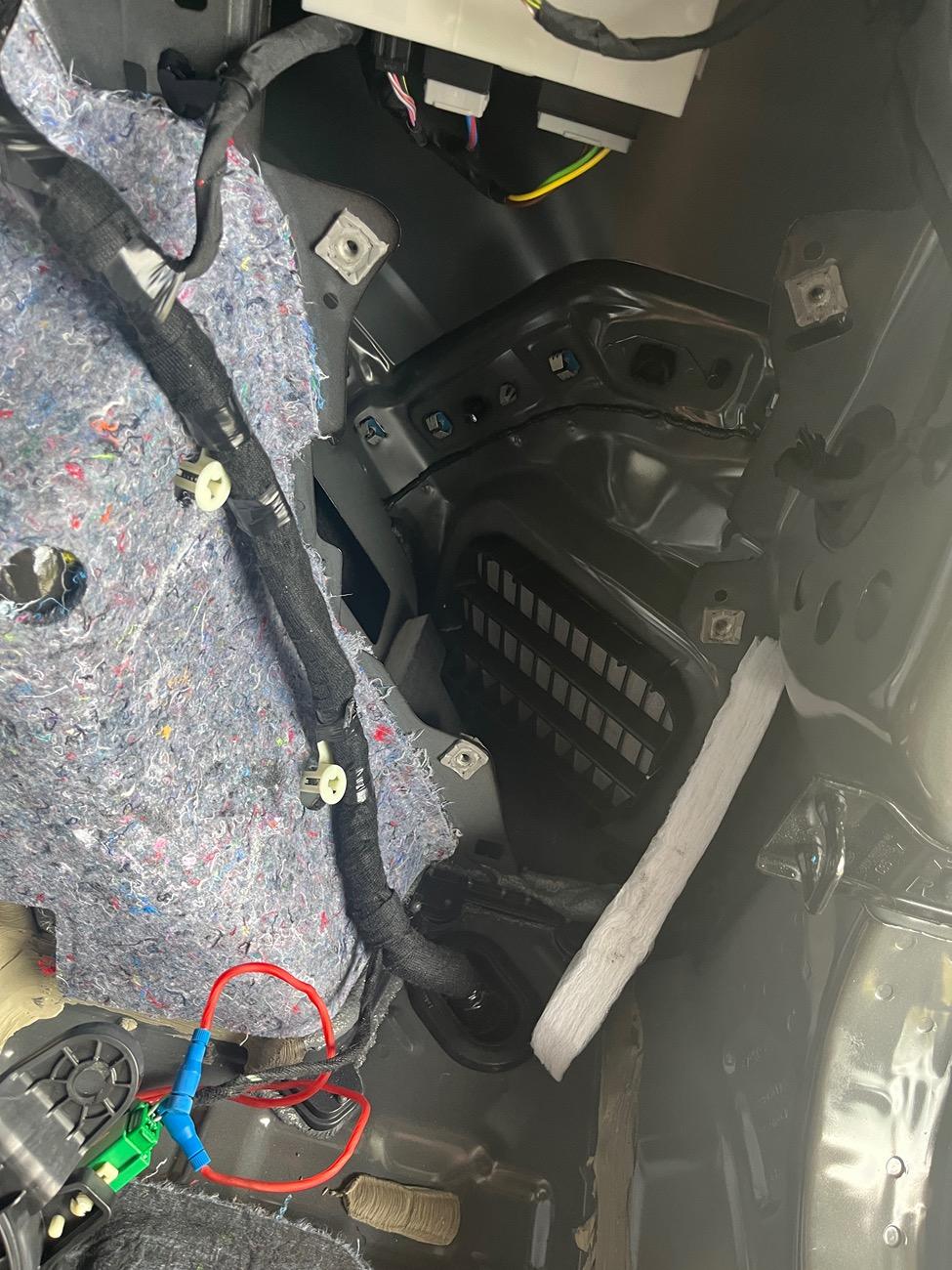

Excellent photos Shumax!
How are the extractors located/removed? Can they be accessed by removing interior panels? It looks like that's the case.
I'm asking because we've had trouble with mice getting into our Badlands and I read somewhere that if a flap(s) gets stuck open they can get in that way.
