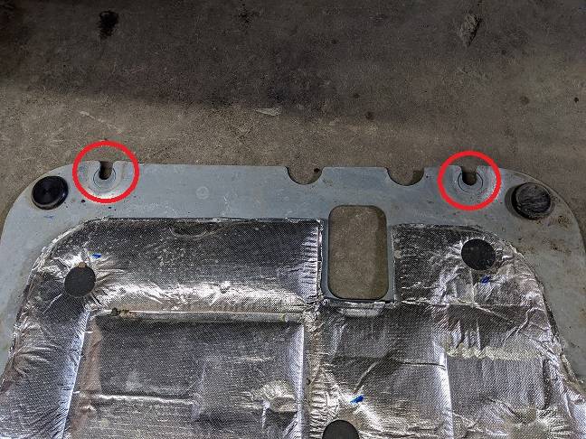

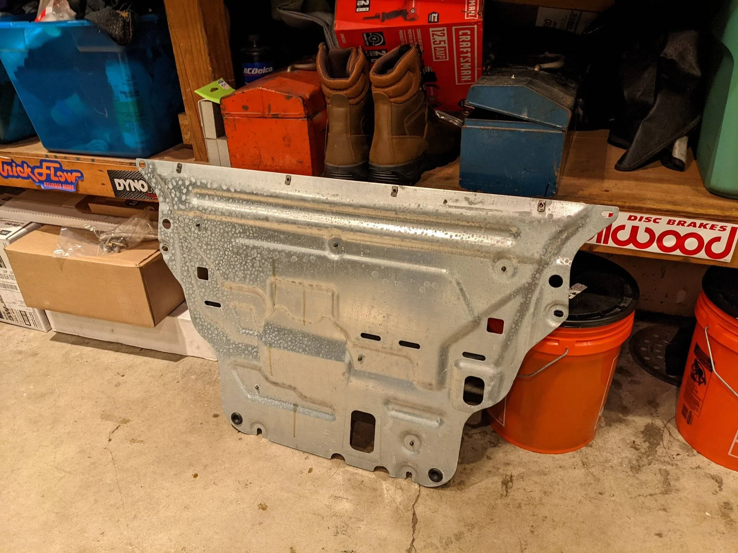

One other thing to add - the back two holes on the skid plate are slotted so the bolts don't need to be removed completely, only loosened about halfway, which keeps the rear of the plate supported while the other bolts are removed. Then the the skid plate can be slid forward off of the rear bolts. I found this really helps when re-installing the skid plate.

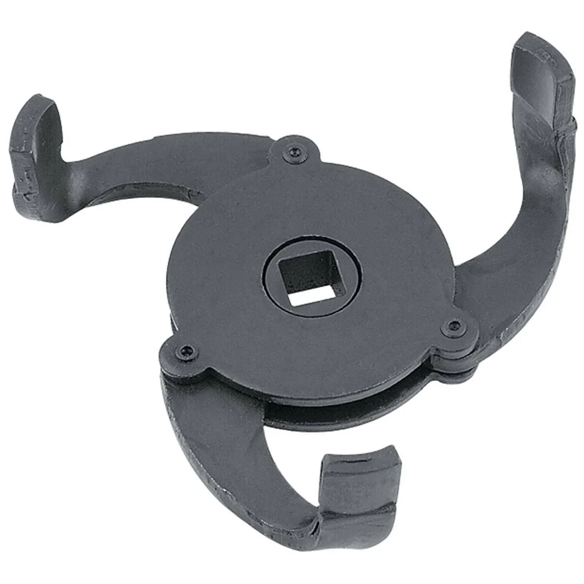

That factory installed filter was a pain to loosen - I think they install them with a dry gasket. I need to find a metal cap-style wrench as the composite one I have was not up to the task.
The three-jaw wrenches work great for removing tight filters. It fits on the end of a ratchet extension. The jaws are held closed by a spring and spread apart to fit different-sized filters. Because of the way they attach to the base, the jaws squeeze tighter when you turn the ratchet to loosen the filter. One caveat, they only work for removing a filter; you can't use it to tighten one.
Great point! I'll add this to my write up. Thanks!

I didn't realize they were slotted until I went to re-install the skid plate. My plan was to use a cutoff wheel and slot them myself....but then I noticed the factory was one step ahead of me!

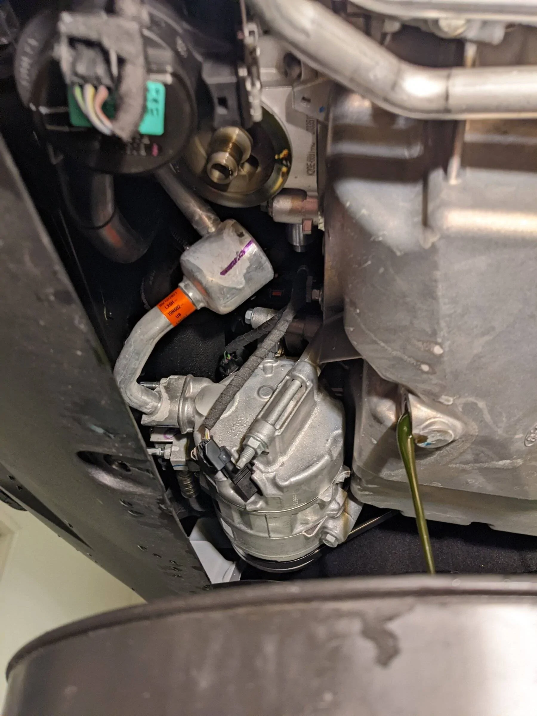

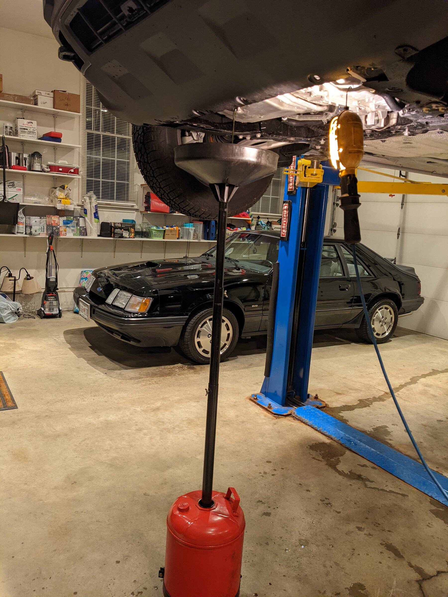

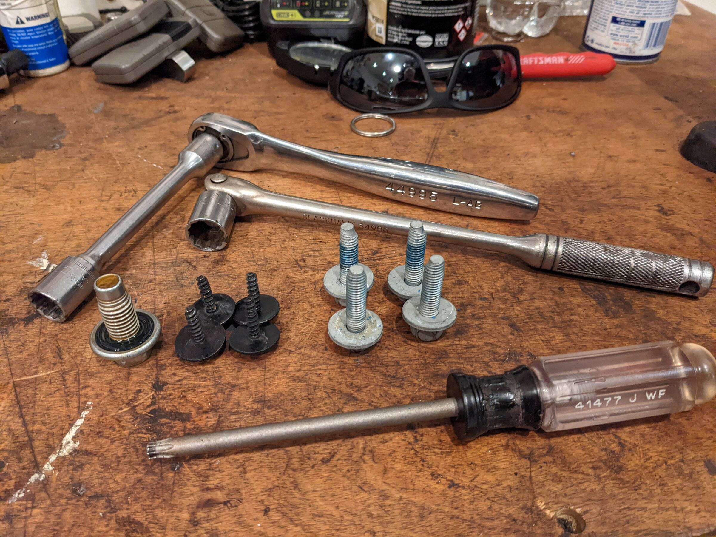

I am at 1,659 miles did oil change today:
Ford Bronco Sport 1st Oil Change on Badlands PXL_20220207_002210868
Ford Bronco Sport 1st Oil Change on Badlands PXL_20220207_005313450
Ford Bronco Sport 1st Oil Change on Badlands PXL_20220207_002914783.MP
Ford Bronco Sport 1st Oil Change on Badlands PXL_20220207_002255437.MP
Ford Bronco Sport 1st Oil Change on Badlands PXL_20220207_002222378
Interesting that only 2 of 4 of the plate mounting bolts have what appears to be Loctite on them.
Also, is there a plastic piece that has to be removed?

Now that's a cool setup. I'd change my own oil if I had that in my garage.
It is nice to have a lift, but sometimes it's almost as easy to just jack up the front end and stick a couple axle stands under there.
It depends on the vehicle -- how much clearance there is and the ease of access to the filter and drain plug.
Take our old RAV4 for example, everything is right there. Getting it on the lift OTOH is kind of a hassle. It has a short wheelbase so it has to be positioned just right to get the arms under it. Then they may have to be adjusted depending upon which vehicle was on there last.
Don't get me wrong, it IS nice having a lift, but there are some things that are easier with a floor jack. Like swapping summer and winter tires. Just jack up one whole side and then the other. No getting the car positioned just right and fiddling around with the lift arms.
Something I need is an oil drain can like that. Then I'd be more inclined to use the lift for oil changes.
On a Badlands once skid plate removed that all that is needed.
