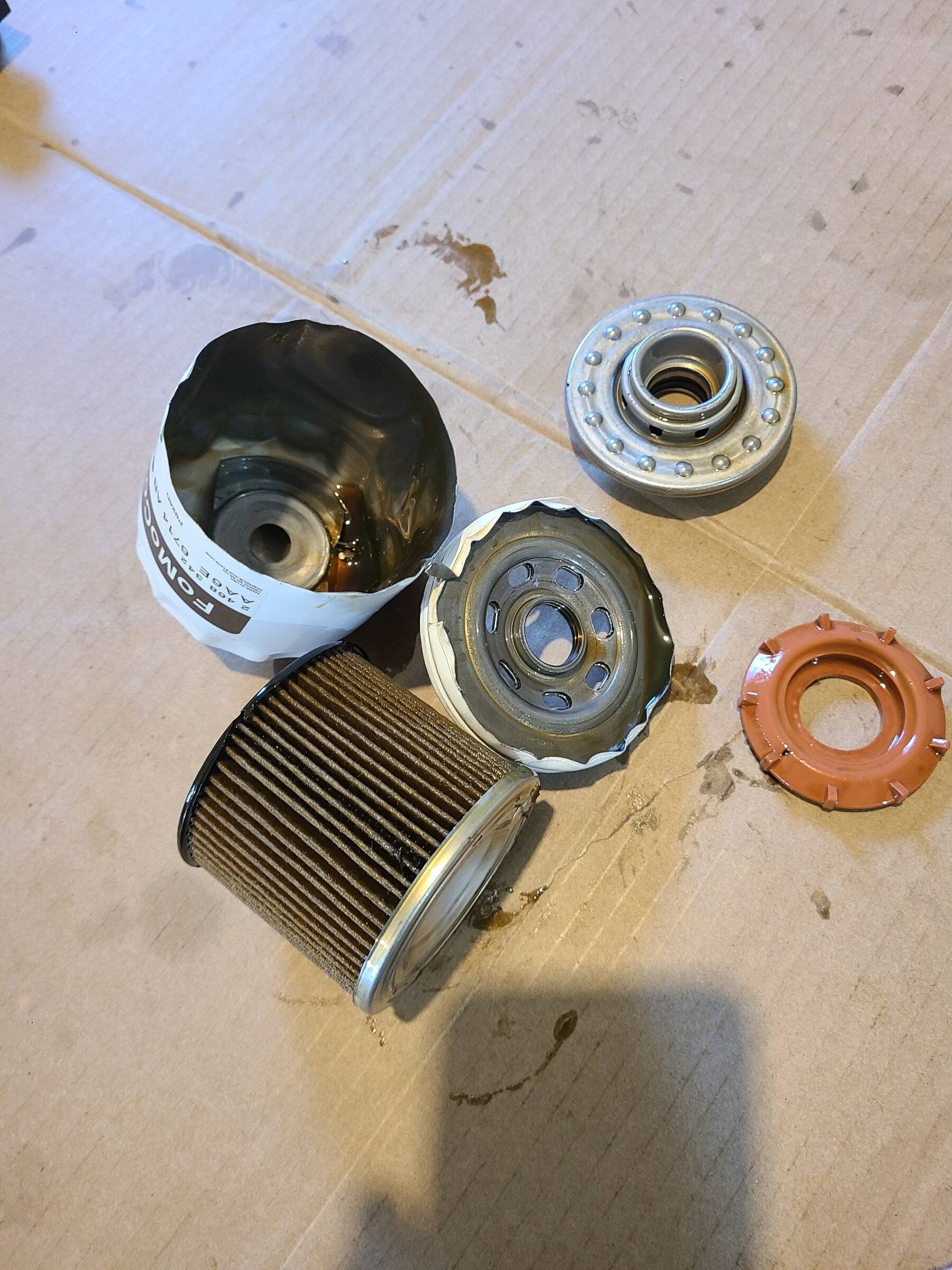

Something I always do on the first oil change is to inspect the oil filter. I use an oil filter cutter to get at the filter media. The series of photos below show the filter in various stages of dismantling. The first is what you see after you cut the end off the filter.
Ford Bronco Sport 1st Oil Change on Badlands 20220125_130332

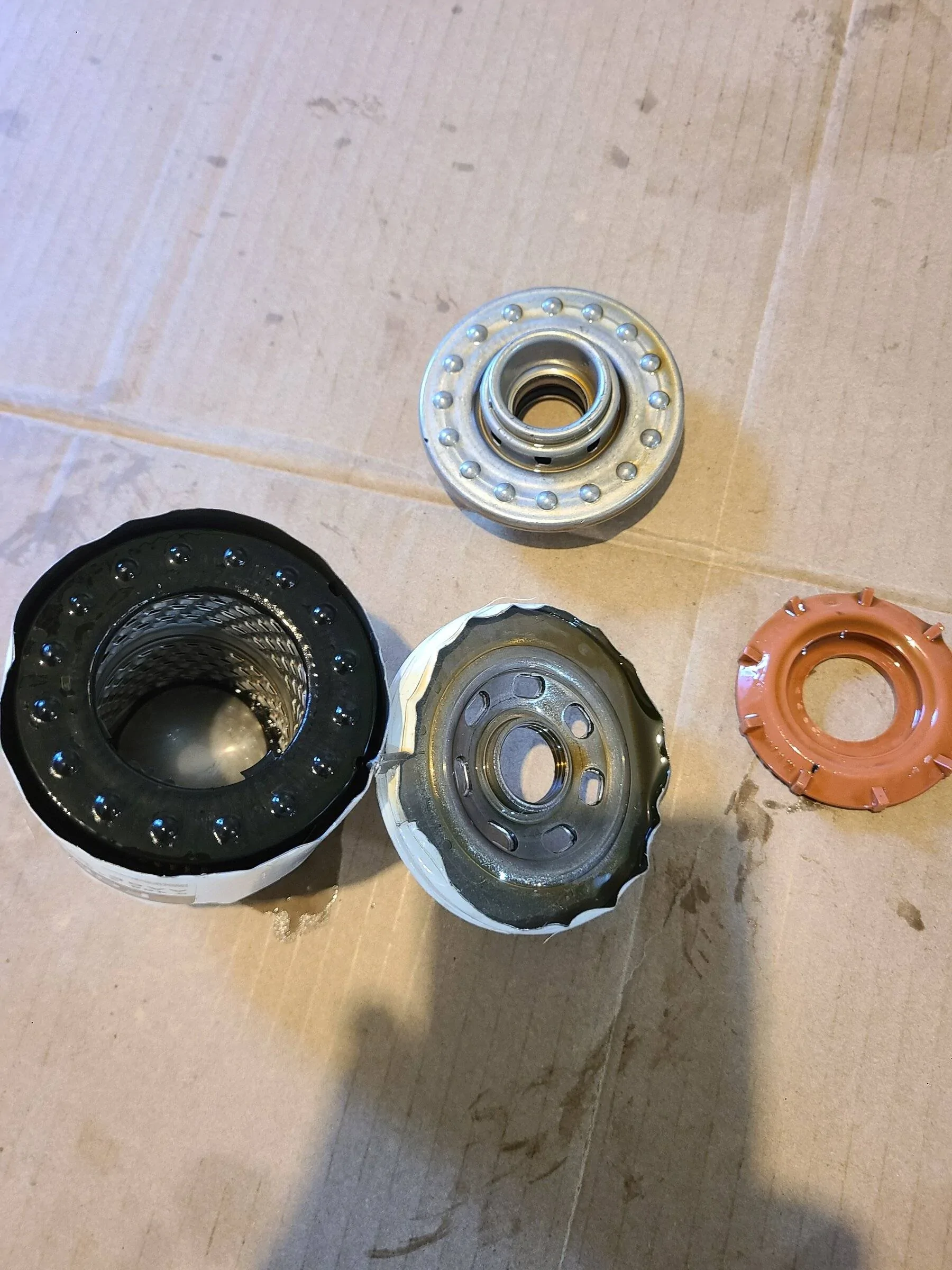

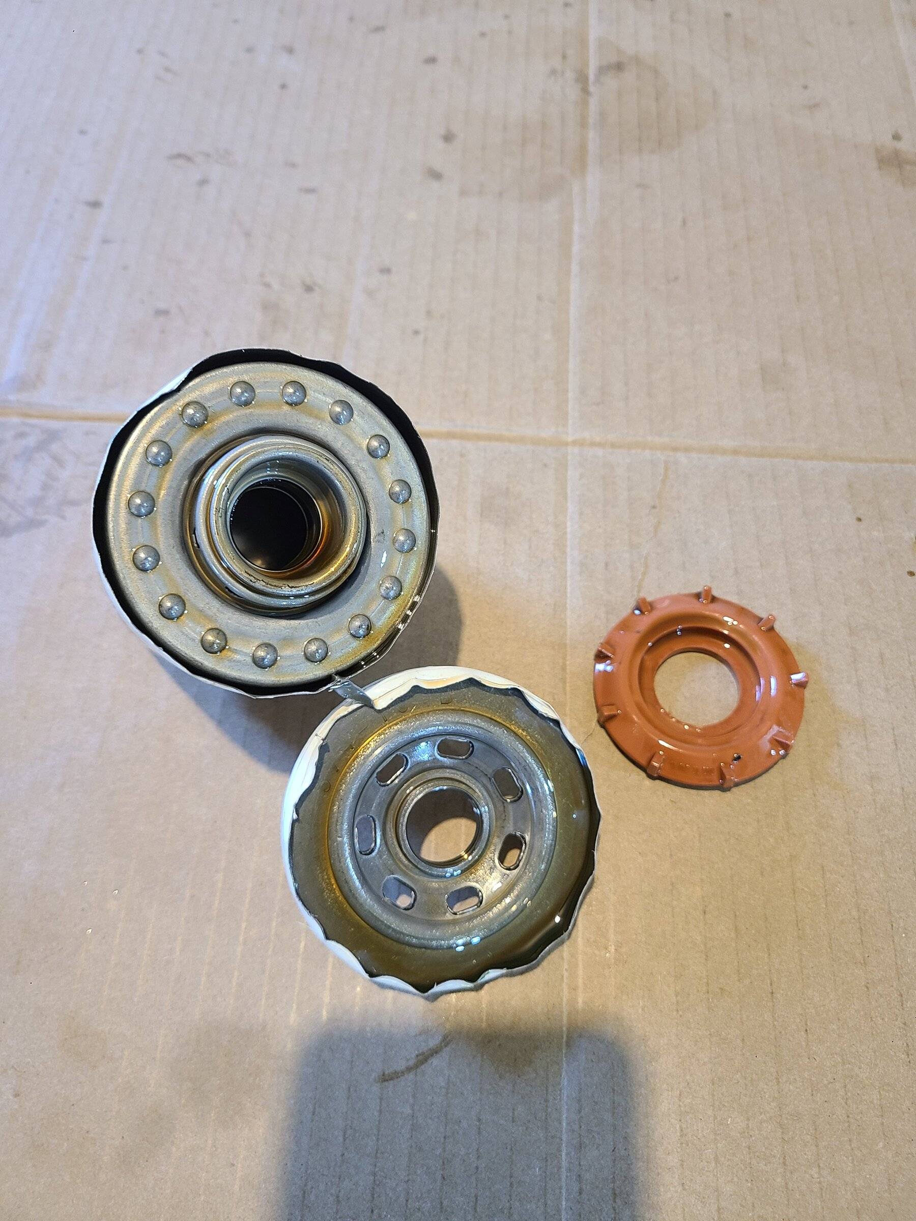

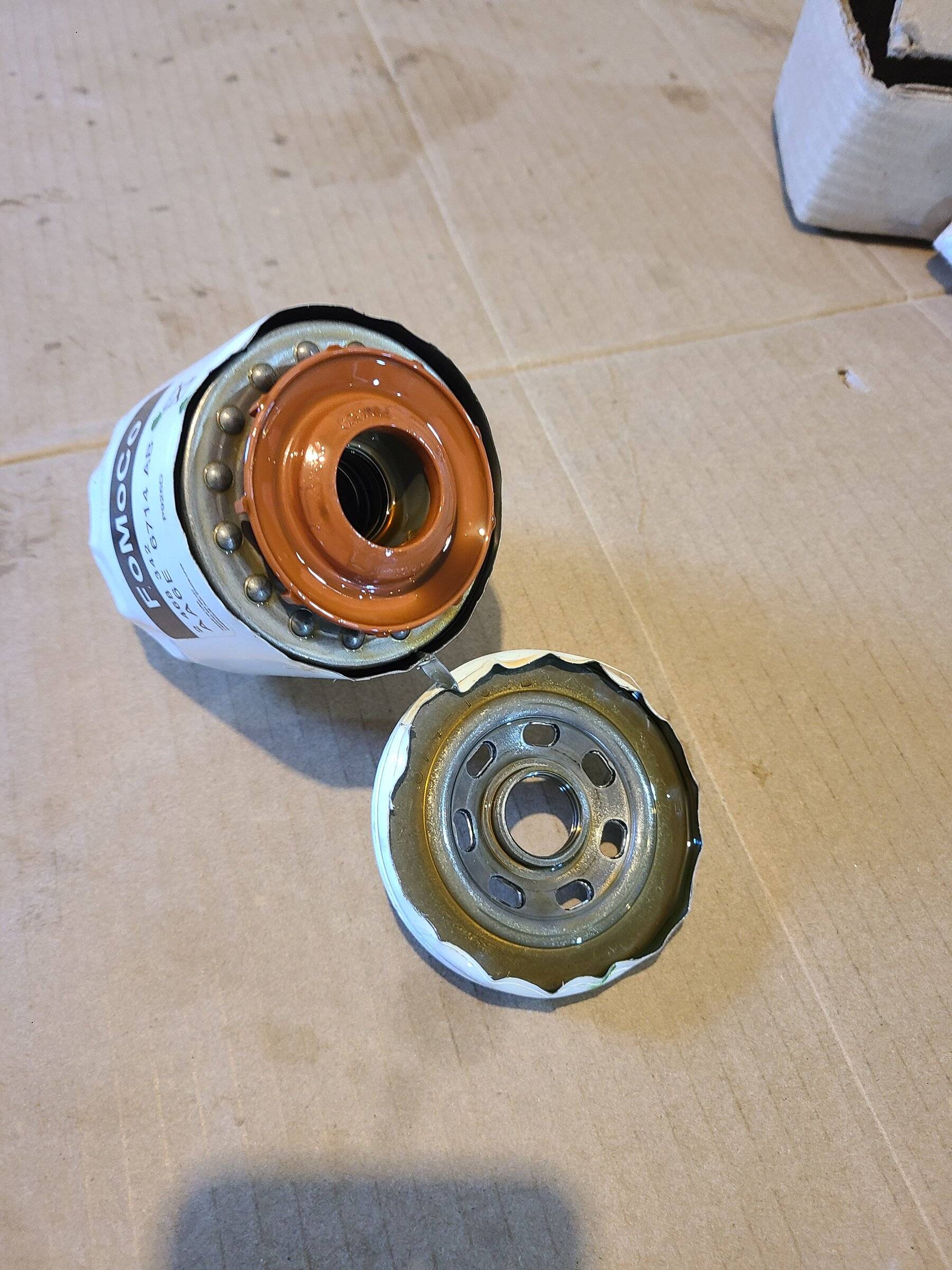

The rubber piece is the anti-drain check valve. It prevents unfiltered oil from draining back into the sump, bringing with it any debris caught by the filter.
Ford Bronco Sport 1st Oil Change on Badlands 20220125_130350
Below that is the media seal and the actual filter media. Oil flows into the filter from the engine, past the anti-drain check valve, around the media seal to the outside of the filter, then through the filter media (see below) before returning to the engine through the hole in the middle.
Ford Bronco Sport 1st Oil Change on Badlands 20220125_130457

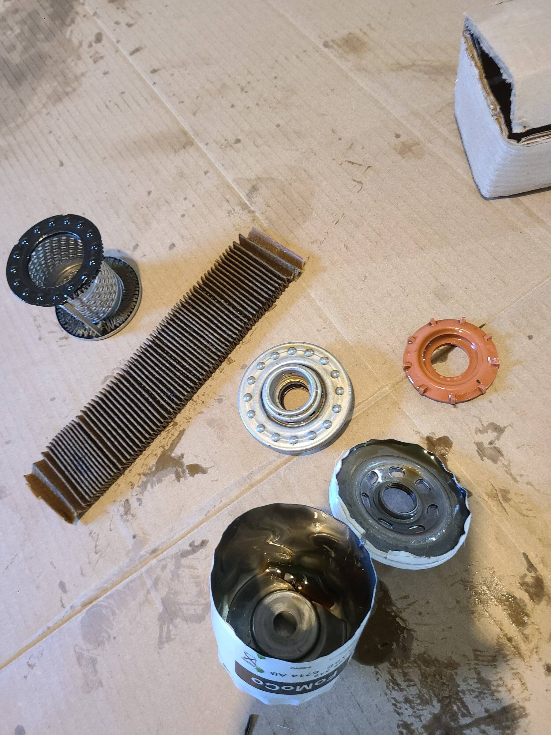

Below, you can see the filter media assembly after removal from the filter. The media itself is typically a paper material that allows oil under pressure to flow through, but not debris large enough to cause damage to internal engine parts.
Ford Bronco Sport 1st Oil Change on Badlands 20220125_130531

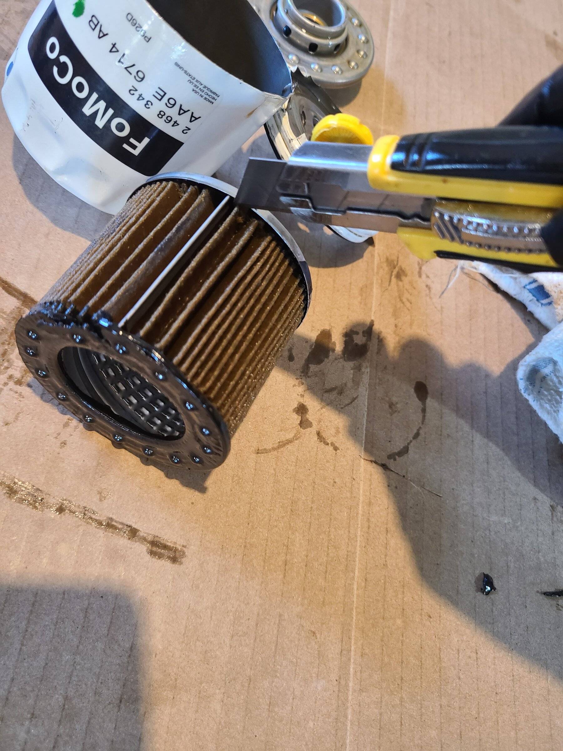

To inspect the media you have to cut it off the media assembly. Use a utility blade (carefully!) and cut around both ends of the medial assembly. After that you can remove the paper media and spread it open for inspection.
Ford Bronco Sport 1st Oil Change on Badlands 20220125_130831
Below you can see the media removed from the media assembly. The assembly core is made out of metal to hold the media in place, otherwise the paper would just collapse in on itself under the pressure generated from the pumping oil.
