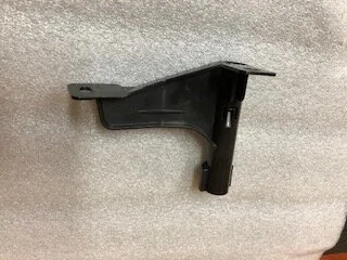

Realize topic has been discussed over and over. Just creating a post that once and for all outlines the situation, parts needed and a simple how to (this would have so helped me).
Beginning mid 2021 Ford stopped including engine covers for BS outfitted with the 1.5 liter Dragon engine (plenty of theories and outrage :)). Besides there being no cover, Ford added a plastic bracket to the right and back of the engine to help hold two hoses in place... Intriguing!
There is a diagram floating around that shows the cover, short metal stud, long plastic stud and a bottom insulator piece. To clarify, diagram does NOT actually represent parts needed to retrofit a BS without an engine cover. Only need 2 of the parts shown and for one of those parts, the short metal stud, 3 are needed.
What you will need:
  • Engine Cover = JX6Z-6A949-B
  • Short, Engine Cover Metal Stud = AA5Z-6N958-A (need 3)
What you will NOT need:
  • Long, Engine Cover Plastic Stud (already installed, used to hold the plastic bracket in place)
  • Bottom Insulator (already installed)
Had followed the diagram and as a result made mistake of ordering ONLY 1 short bolt as well as a long bolt that was NOT needed (noticed bottom insulator was already there so at least avoided that extra purchase).
As for install, it will be obvious where the 3 short mounting bolts go. To remove the bracket, first unclip the hoses or simply cut the zip ties (ties were on tight so left them on and just unclipped hoses from the bracket using a trim tool). Once hoses are free from the bracket, trick will be to pull the bracket out. Easier said than done but it will pop out, just give it a good hard pull straight up. Suggest spraying some WD 40 inside (see pic below) the cylinder section on the right where the bracket is mounted.
And that is it! Hopefully helpful (post is NOT to debate merits or uselessness of an engine cover... nor how cheap Ford is (but they are!) for no longer including one in a $30k+ SUV!) :crackup:

Save the hose bracket....

Parts arrived yesterday and installed today. Very easy. Probably no more than 5 mins. Engine compartment looks good.
Ford Bronco Sport 1.5L Dragon Engine Cover Parts List and Install Instructions 1648415248642
