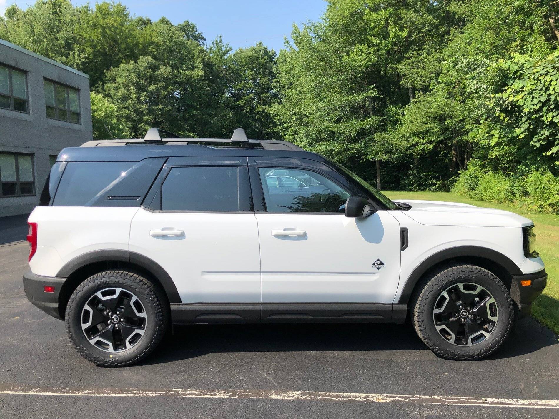

Hey all! I have an outer banks bronco sport, I love the bronco on my wheels, so im thinking on getting them powder coated all black but keeping the bronco center cap, I love the look of the BFG KO2 , but im wanting to see if anyone has a different tire I may like better. I have the 1.5 RC lift, what size tires do you have? and what size works best with the lift? Pics apprectiated

I dont believe the KO2 comes in a good size for the Outer banks.
Best size for the outer banks without any issues IMO is 245/60/18. this tire also fit without a lift.
I tried find the KO2 for our OB but settled on the wildpeak a/t trail

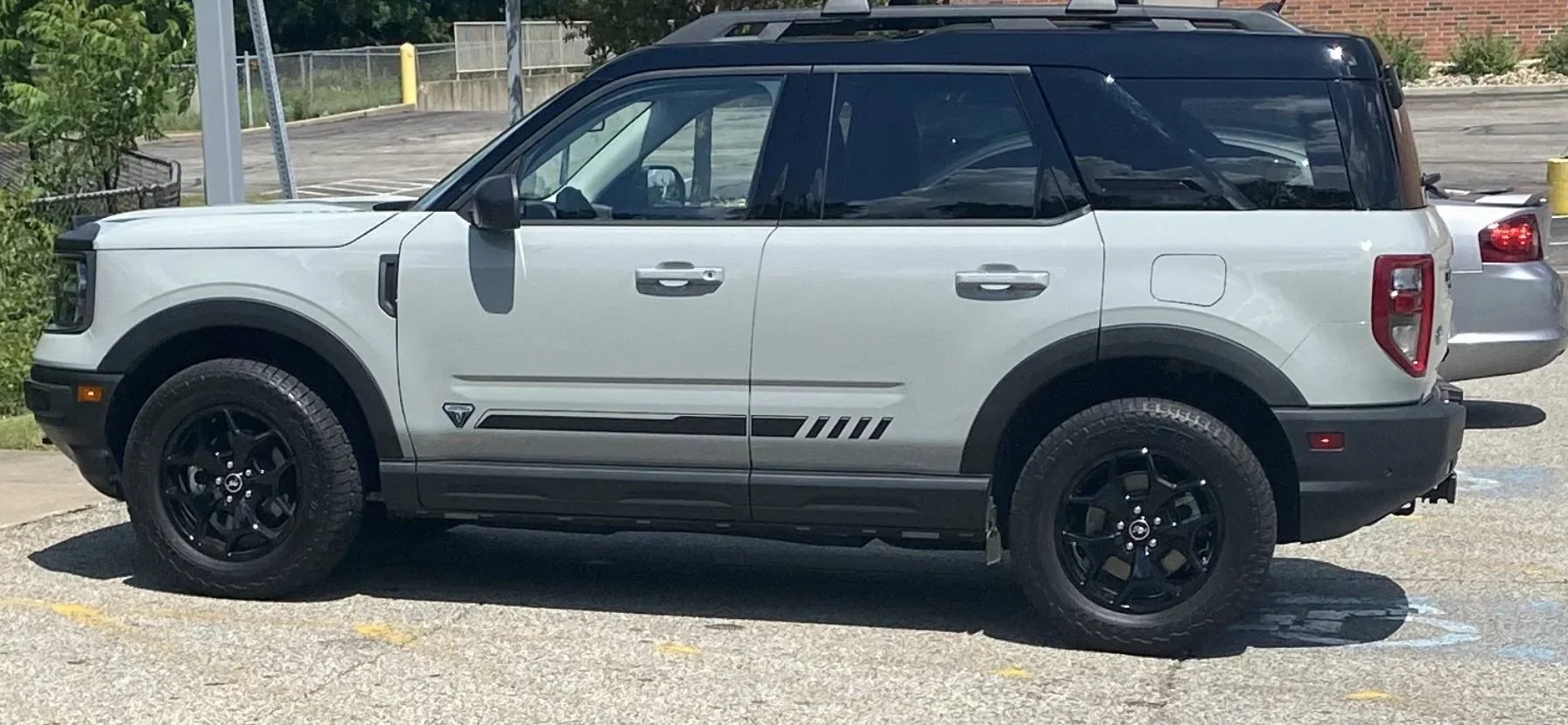

I have the Falken Rubitrek 245/65/17's on my Badlands. I have 4200 miles on them, no issues.

Ford Bronco Sport Stock wheels with 1.5 RC lift tires that best fit Bronco Sport OB CA4121EB-CC9F-47E2-8112-F922782C987B
Ford Bronco Sport Stock wheels with 1.5 RC lift tires that best fit Bronco Sport OB E31A1E78-A018-492C-9A39-28A8FFD4ABC9

From what Ive researched 245/65's are the biggest that will fit with no rubbing, with or without a lift.

Unfortunately with the stock 18 inch rim diameter and the limited A/T tire selection available that would fit the Outer Banks there is not much to choose from.
If you'd be satisfied with the Falken Wildpeak trail tires, they have 235/60/18 and 245/60/18 available which is equivalent in size (245/65/17) to what people have installed on their Badlands, including myself.
With your lift, you shouldn't have any issues, but you should verify.
The next option would be to purchase some 17 inch wheels and gain a much greater A/T tire selection.
