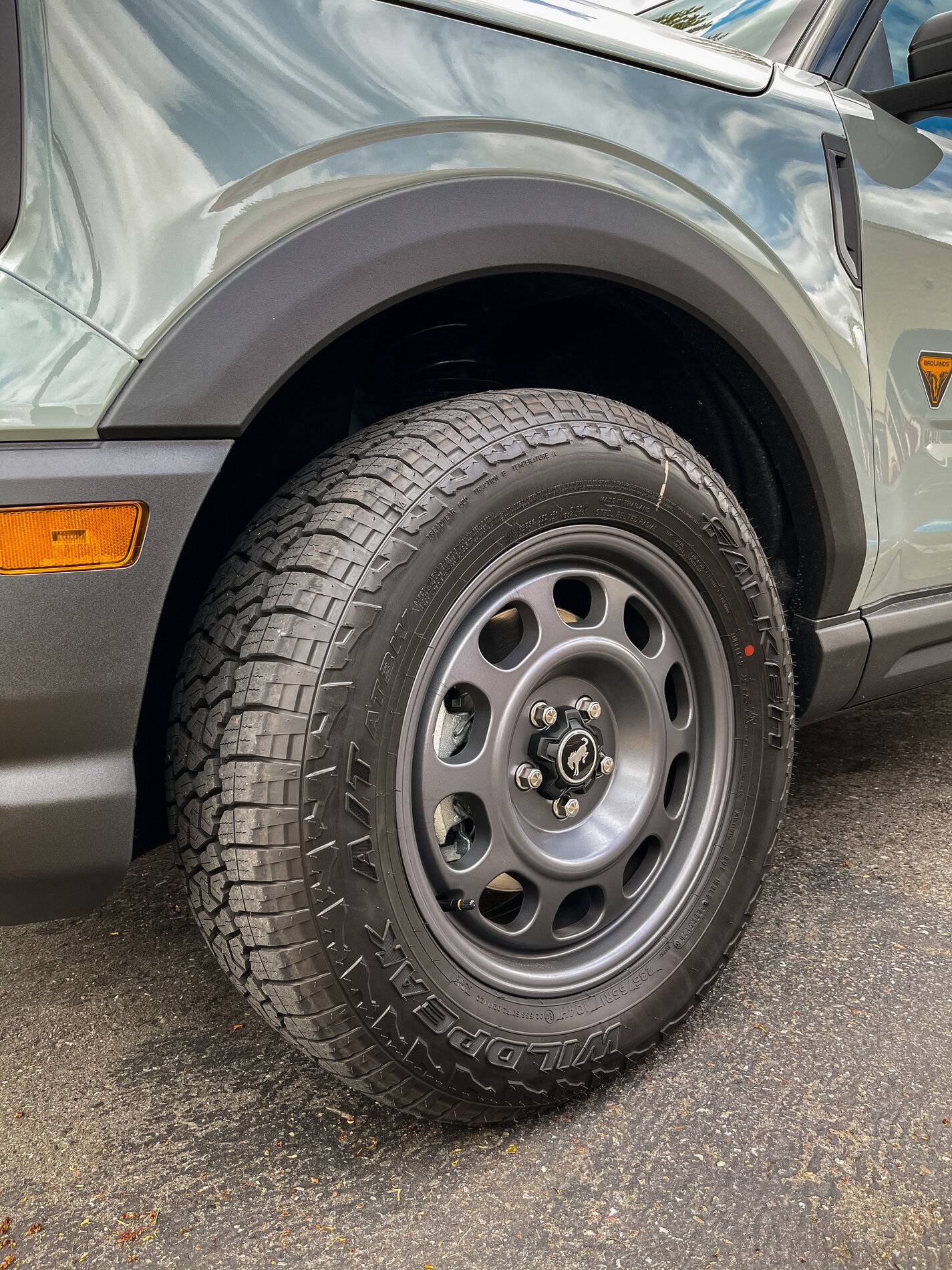

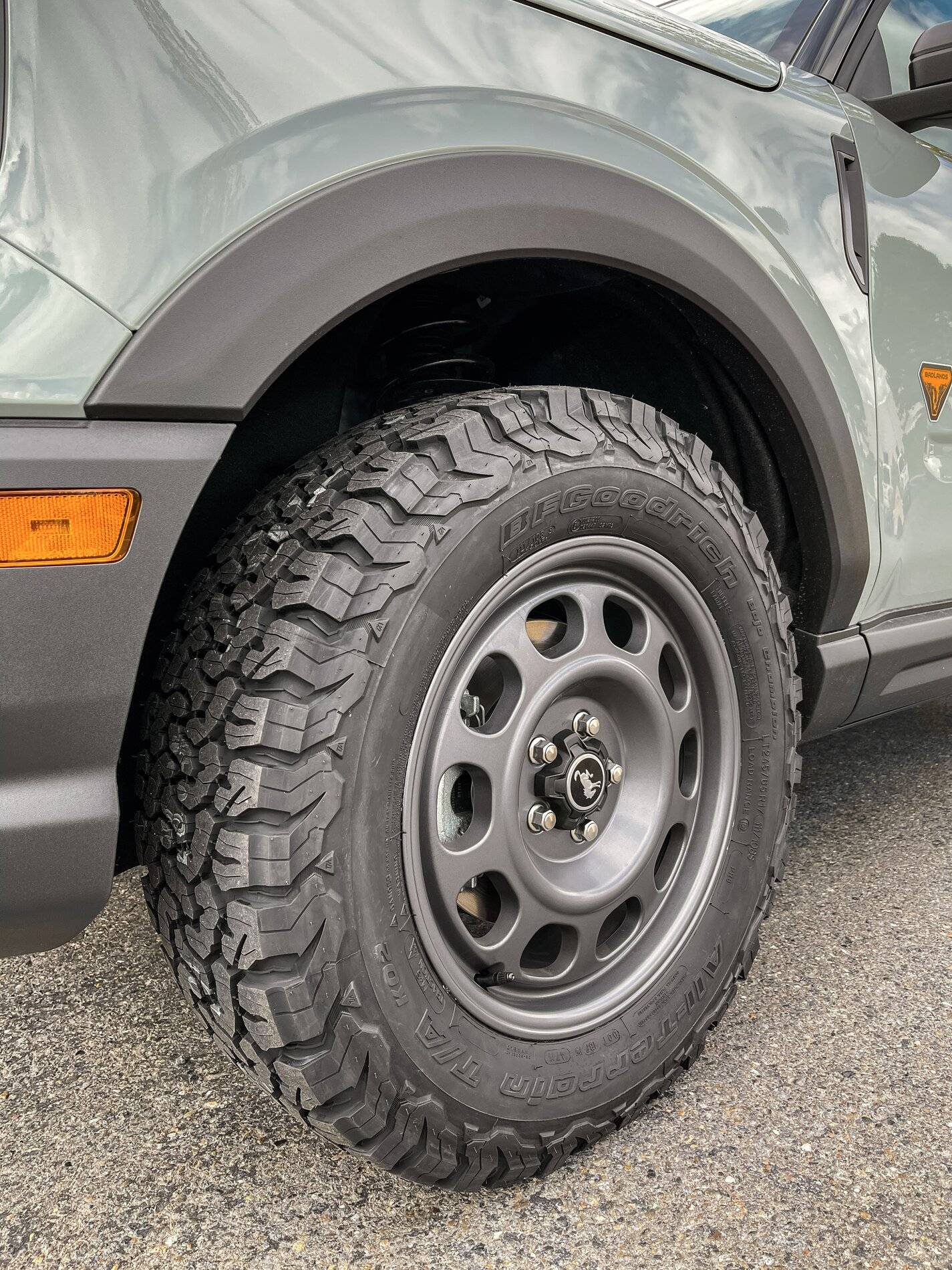

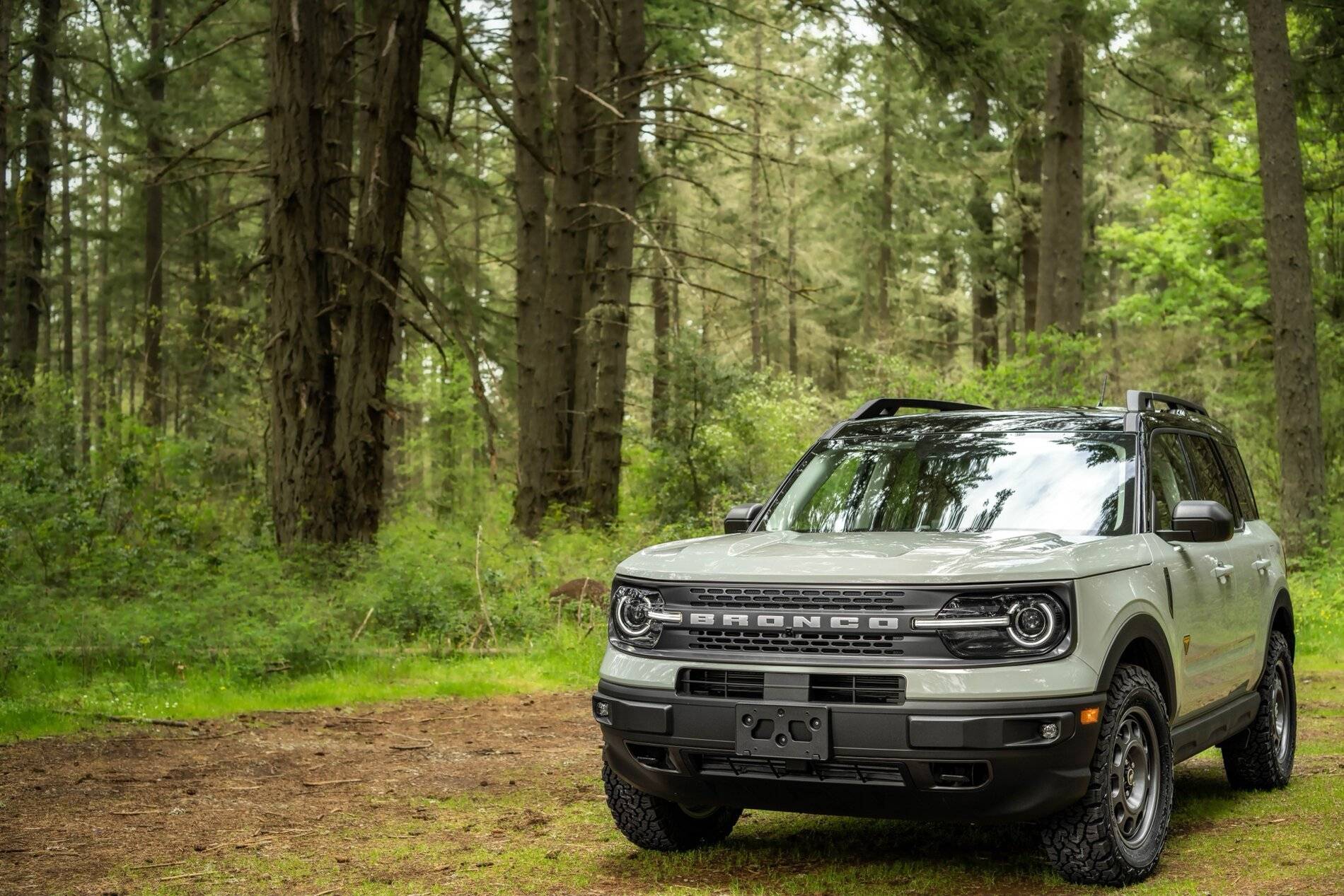

Stock Badlands, suspension/wheels. No rubbing at all. Overall diameter for the BFG KO2 is 29.5” vs 29.1” for the stock Falken WildPeak AT3W.

Does it have a lot of room left or just a tiny room left without rubbing?

Bigger tires look great!

Those look seriously awesome! How's the road noise? Do you think those would fit on the stock Badlands wheels, or are they a different size?

Sorry for the late response. Thanks for all the comments. As far as going bigger, 245/65r17 (or equivalent) seems to be the biggest you can run on stock wheels with stock suspension without rubbing. Eventually, I plan on adding a 1” lift with 245/70r17 KO2s.
