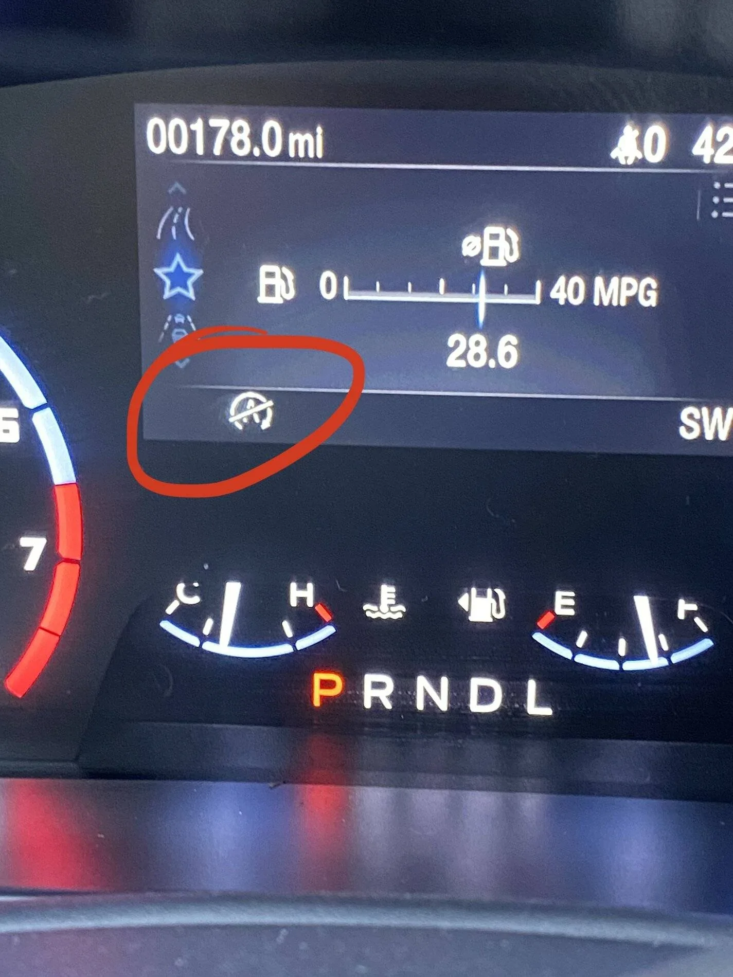

Hopefully someone has some experience with this: My auto start/stop appears to be permanently disabled, no matter how many times I toggle the button. Any ideas on how to turn it on?

In my experience it won't function if the AC or Defrost are running. Check that.

If you are in sport mode, it is disabled.
According to the owners manual, it gets enabled after the following conditions are met:
The system is enabled every time you start your vehicle if the following conditions are
met:
• You do not press the Auto-Start-Stop button.
• Your vehicle exceeds an initial speed of 3 mph (5 km/h) after the vehicle initially starts.
• Your vehicle is stopped.
• Your foot is on the brake pedal.
• The transmission is in drive (D).
• The driver door is closed.
• There is adequate brake vacuum.
• The interior compartment has cooled or warmed to an acceptable level.
• The front windshield defroster is off.
• The steering wheel is not being turned.
• The vehicle is not on a steep road slope.
• The battery is within optimal operating conditions, such as battery state of
charge and temperature in range.
• The engine coolant is at operating temperature.
• Your vehicle is not being driven at a high altitude.
• The ambient temperature is moderate.
