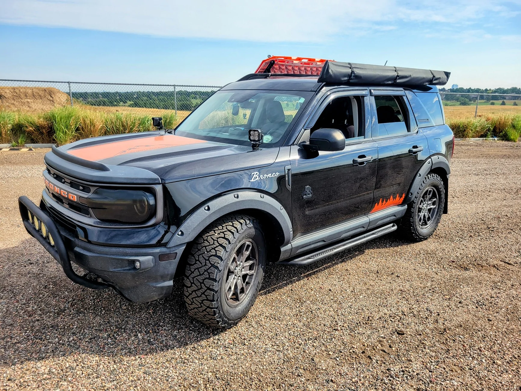

Always felt like the 245s were too narrow β€” I’d slide off rocks too easily πŸͺ¨πŸ˜¬. Terrain matters, but for a soft off-roader, the extra width and grip really help πŸ’ͺ.
The tire size alone gave me about 0.26” of added ground clearance πŸ“.
Paired that with a 1.5” lift using lifted struts and springs πŸ”§β¬† β€” giving me a total clearance gain of about 1.76” overall.

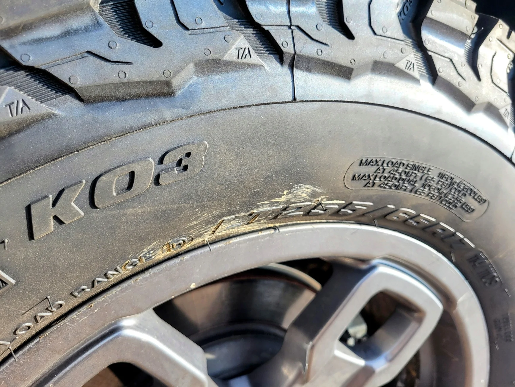

Minor rubbing at full lock πŸ”„, but nothing crazy. Might heat-mold or trim the liners before snow/mud season β„πŸ’¦.
Ford Bronco Sport Upgraded to 255/65/17 KO3 tires on the Bronco Sport 🐎 1000012352

Just sitting there the 255 looks like it's already rubbing.
I have 245/65/17's on my Badlands and they kiss the the front wheel well liners at full lock with the suspension compressed, I would imagine 255's would really rub enough to tear up the liners and even cause contact with the pinch weld which could potentially damage the tire. You may need to make a modification soon than later if you do much off roading.
