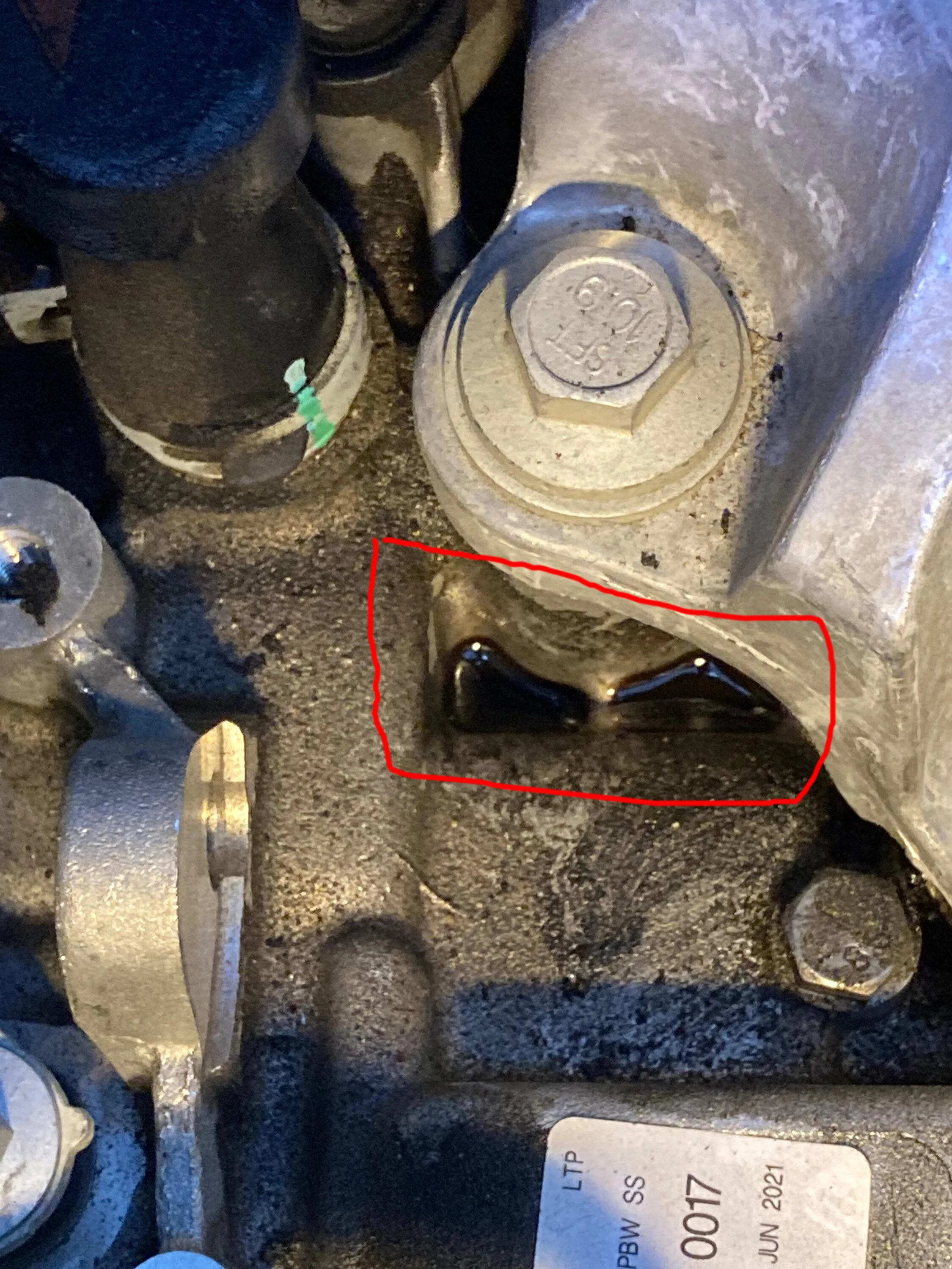

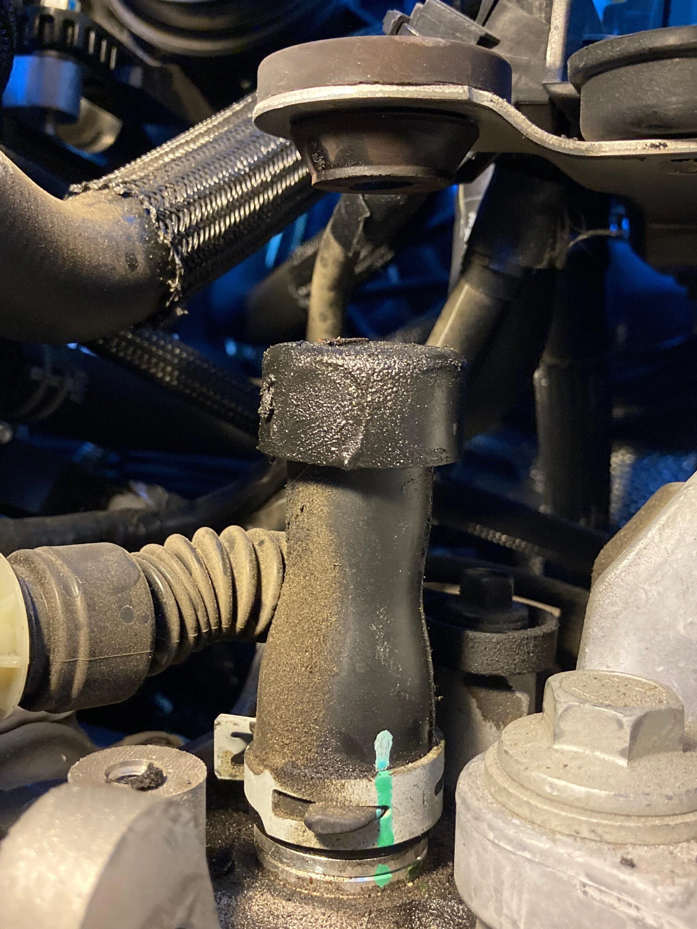

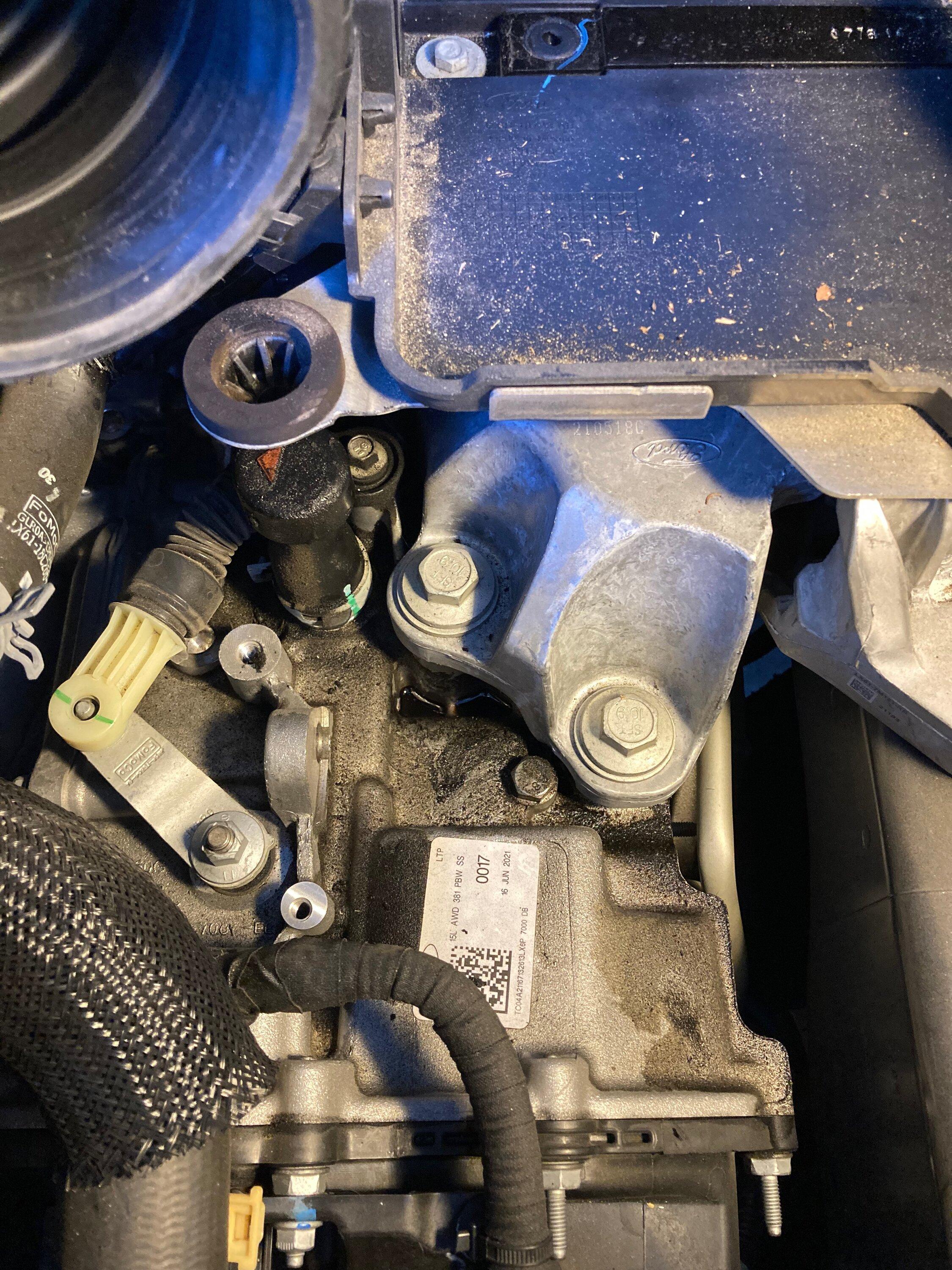

When I pulled the air box out to remove the battery, I found a leak. At first I thought this might just be road grime but everything else around it is super clean. The unit right below the air box is labeled as being the all-wheel drive unit. There is a big area that is wet with oil or grease, this is fresh as it was wet and not dry. I also found some liquid in a couple of low spots, it was very thin, like water and had no smell....it may be water but don't know how water could have got up in there. There is a tube, with a cap, sticking up out of the drive unit which I believe is a breather....I am pretty sure the oil is coming out of it. For those members that have had to change their battery, have you seen this (please see attached pictures) under your air box? There should not be any oil coming out of that breather.

I had the oil in the same spots you have circled in my brand new at the time Dec 21 built 2022 BS OBX. Turned out it was transmission fluid. Believe that item in your last photo is a transmission vent. Though is was concerning at the time, I cleaned out the oil (folded paper towel poked with a screw driver), hit the area with a squirt of brake cleaner & let it dry. It never came back in the 12 months/7K miles I put on my Bronco Sport.
I just figured transmission may have been a tad over filled.
Clean those two spots up, if it comes back then maybe take another look.

As mentioned above, the source of the oil is the transmission vent shown in your picture, (grimy rubber cap with the orange triangle on it). Seepage from it is normal and that amount is probably normal for the age of your vehicle.

The oil residue in your photo looks like it's coming from the PTU vent.

I don't believe it would ATF since it is not red, it also does not have that "sweet smell" that ATF has. In those two little pockets, I believe it is water, maybe condensation spitting out the vent. Maybe they are using some new ATF that is black and doesn't have that normal sweet smell.....doubtful. I don't feel those vents should spit out any oil, they are there to allow the unit to breathe and not pressurize. Could be that it was overfilled at the factory, that would be another testament to Ford's shitty quality control these days......Henry Ford is probably turning over in his grave. I am not going to clean this up quite yet until I send the pictures to the deal.

Since I still have warranty on the vehicle, I reached out to the dealer and sent them the pictures about this fluid leak and the service technician said exactly what you stated "excessive transmission overflowing through filler tube". They cleaned it up and I am going to keep an eye on it. Mainly, I wanted to make sure this was in the vehicle's history in case something happened later down the line, Ford cannot tell me that I ignored it. In my opinion, having transmission fluid overflow from a fill port or vent tube should not happen on a new vehicle but I will monitor it and see if it continues to happen....hopefully this was a one and done and there is not another problem lurking that will pop up when the vehicle falls out of warranty.
