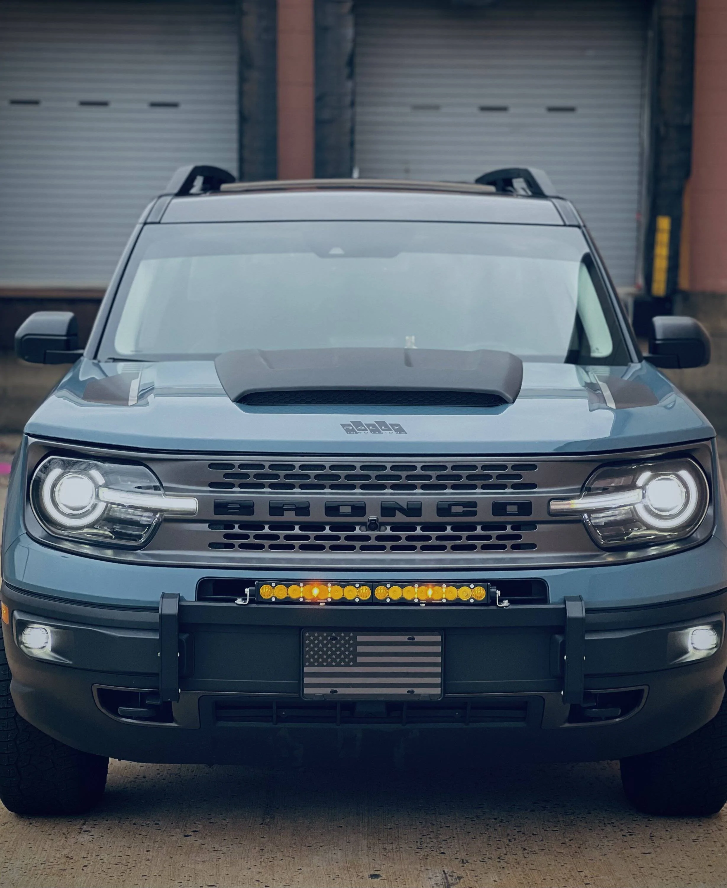

My BS FE came with the OEM hood scoop installed. It’s on there pretty good, question is how good. It’s an eye catcher and sets it apart from other rides but it’s not a functional scoop. I enjoyed it for a while but taking the design a different direction that likely won’t include the scoop.
Has anyone had one and removed it? I’m going to wait for warmer temps to remove and hope it can be removed so I can sell it. I did see one person who had powder coated theirs to match and that was nice but idk I think the novelty for me has worn off. I welcome opinions.

I'm fairly sure it's installed with adhesives. If that's the case, heat and gentle prying will be your best option. If you can get a corner up high enough to get a finger under then you should be able to pull while applying heat. Be careful. The hood--all the sheet metal really--is quite thin aluminum. You risk a dent if you pry against it too hard.

Love my scoop but it goes with the look I am going for. It is stuck on w adhesive. What I will say is it’s pretty sturdy. I would definitely be careful or have a shop take it off. Definitely could damage the flimsy BS hood. I’m fortunate that my local dealership installs stuff for next to nothing. I will have them take mine off if I ever change my mind.

I’ve read recently, a pretty sweet technique to remove anything that’s held on by adhesives, is to carefully use a heat gun than slide fishing line or tooth floss under an edge and slowly work at it that way. Never tried it but might be helpful. Beats any prying or potential damage to surface.

Absolutely! I’ve used fishing line when removing badging on previous vehicles and the all that remains is the hardened glue goop. Even my BBs rim protectors left a nasty residue after removal.
Thanks and be sure some fishing line will be within reach on the one. I don’t want to damage or bend the metal so may line it and settle for the mess that remains.

I love mine, had it painted to match the Atlas Blue Metallic, but like others have said Patience is gonna be your friend for sure, heat gun, fishing line, dental floss, and more Patience. Good Luck Removing Yours.
Ford Bronco Sport OEM Hood Scoop - how to remove? IMG_2547
That’s such a nice blue color too.
