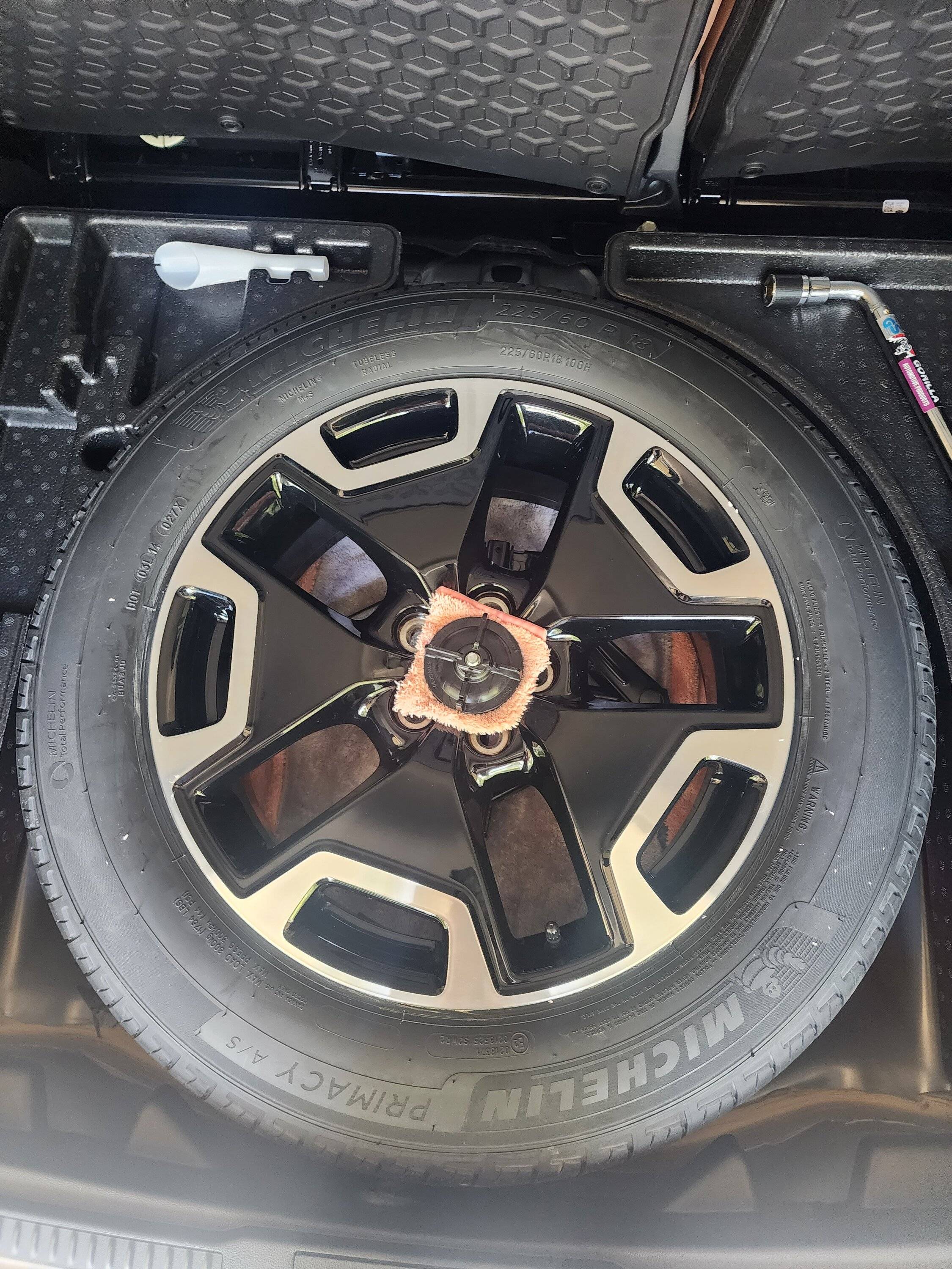

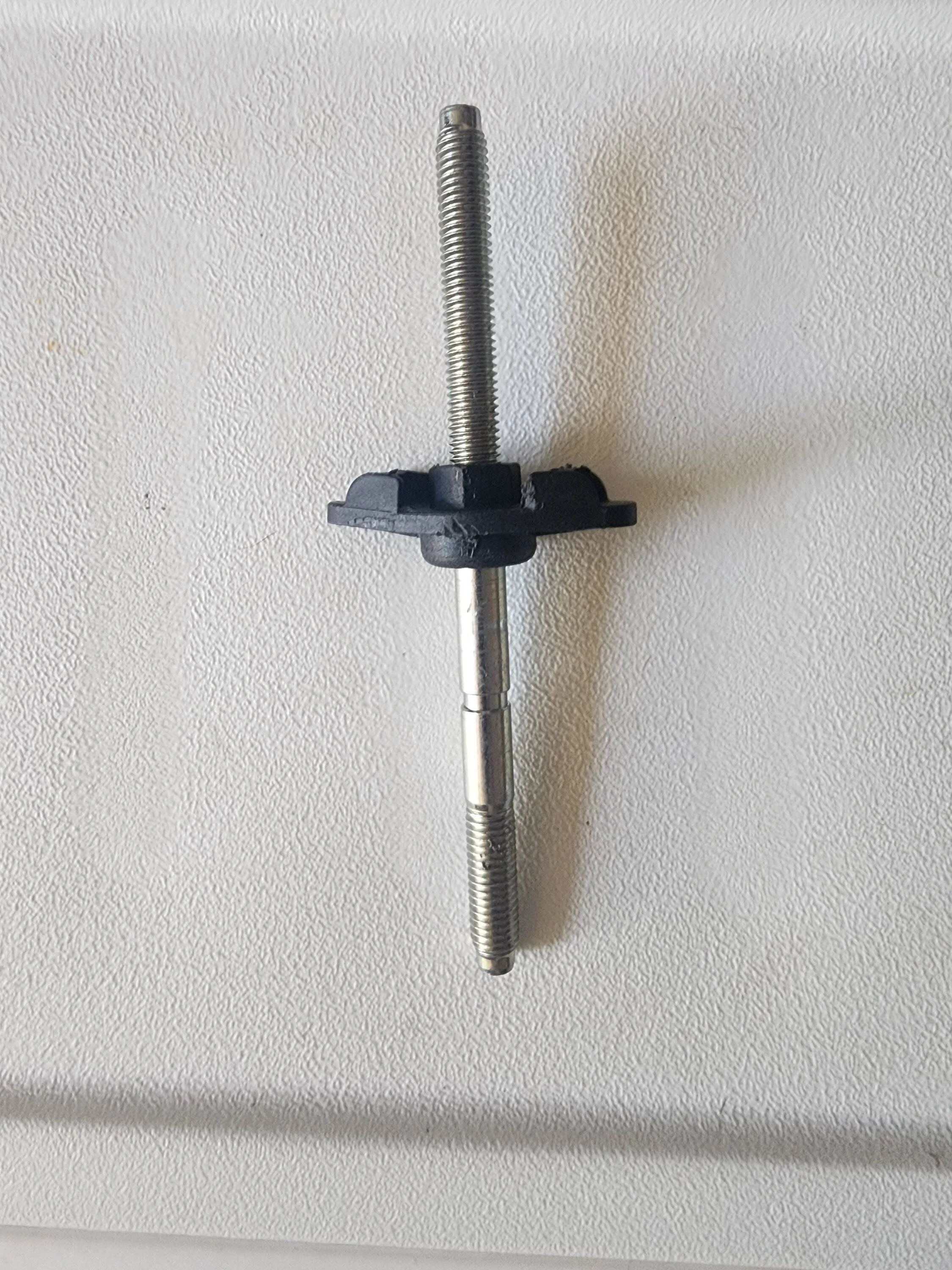

I had the spare tire face down with the standard hold down and it wasn't right to me. I'd rather have the full size spare front of the wheel up so I can check air pressure easier. The pic below is the shorter one in the Outer Banks. I had to buy the longer piece LJ6Z-17091-C Lug wrench stud for the Badlands.
It worked perfectly but I did add a piece of thick microfiber to stop and vibration scratches on the wheel.

Did you get a different floor board or just raise it to the higher position? I'd be curious what the difference is.

I just use the higher position which I like. I never tried the lower position with the full size spare..

A quick question. If you put a full size spare in a Big Bend that has the emergency donut. do you have to raise up the cargo floor. I don't see any slots to use if you raise it.

I have an OBX and used the higher setting before and after the addition of the full size spare. I like the floor being even with the cargo door lower trim. I never tried the lower setting.

Question...when you place a full size spare, the floor board/lid is now supported by the tire on the rear side of the vehicle, correct? Versus the plastic shelf supports when you had a donut in there. When I upgraded to a full size spare on my base model, I noticed that the floor board has no support underneath on the corners at the rear of the vehicle. Is that what you have as well? I'm thinking of adding some sort of 2" rubber bumpers/lifts on the corners to add some support.

No problem with a full size spare here. The rear spare cover is in even with the rear bumper trim. Same as I had it with the compact spare.
