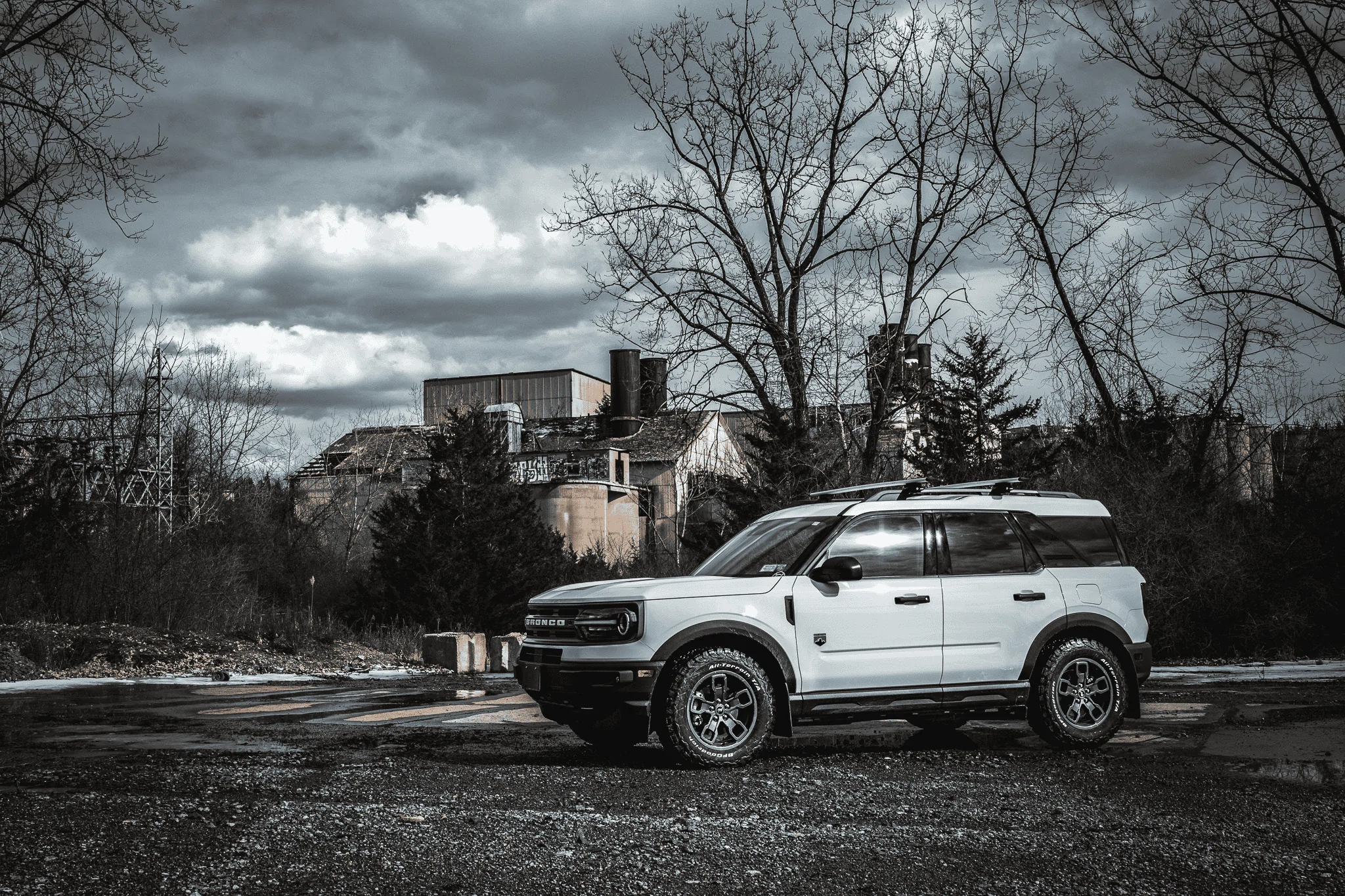

got yelled at today at my local tire kingdom for trying to order a set of 245/65/17 for my big bend. even though I've see multiple posts of people running the 245s on the big bend on stock ride height can somebody reassure me for my sanity that these are the correct Ko2s other owners are getting.
https://www.townfairtire.com/brand/tires/bfgoodrich/all-terrain-t~a-ko2/245~65r17d/52433/
i havent found anybody running the gatorback mudflaps which is my only concern atm.
also im on the grey stock rims like the one in the pic for reference

245/65R17 is not an OEM size for this vehicle. The largest OEM tire is 235/65/17.
Many members here have confirmed 245/65R17 tires may be mounted without concern for interference with suspension parts or wheel wells, but some tire shops balk—likely for liability concerns—at mounting any sizes other than OEM recommended. You may need to find a different shop willing to mount sizes other than OEM recommended.

Well that is my BS in the photo and they are indeed 245-65-17's. I'm not sure what the gatorback mud flaps look like or how they mount but the factory Ford mudflats have been zero concern with these tires for the past 10,000 miles or so.
