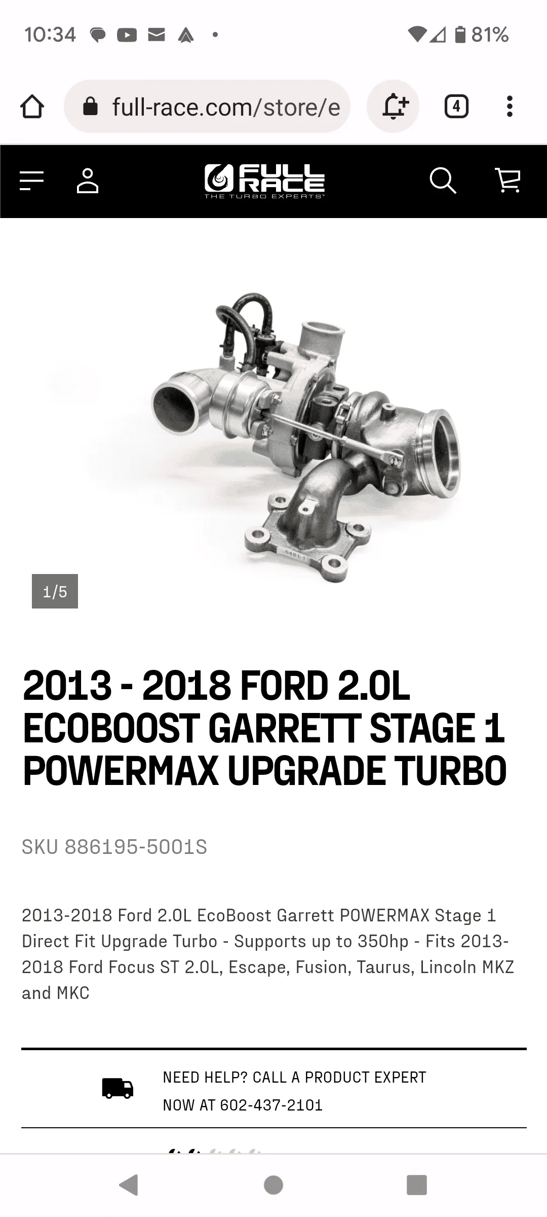

So my budget's not going to permit this for quite a while and I have other upgrades that I want to do first, but I know back when I had my Ford escape 2.0 I was looking at trying to fit one of the focus ST upgrade turbos but it was really expensive. It was like 2200 just for the turbo and then you had to get like an adapter and it was externally wastegated So you had to get one of those too and then you had to figure out how to get the wastegate outlet back into the exhaust pipe routing and it seemed like a big pain.
So I was just messing around looking at stuff. I'd read about a guy who had upgraded his Maverick 2.0 turbo with like a Lincoln one and I was trying to figure out which one and I ran across this where Garrett has a direct bolt-in upgraded turbo for the 2.0. it doesn't say for the bronco sport but it does say it's for like the fusion and stuff and as far as I know it's the same turbo and it looks like the same turbo. And it just seems like a really cool way to increase power.
It says it's rated for up to 350 horsepower at the crank. Of course you'd have to get a special Dyno tune until they become more popular and then maybe some people would have canned tunes for them. But this is definitely going to stay in the back of my mind. Maybe maybe a way for me to waste my 2025 tax refund and void my warranty.
What is your goal? Increasing HP with a bigger turbo like this will almost certainly come at the cost of driveability. The twin-scroll OEM turbo is designed for rapid spool up to provide maximum torque at the lowest RPM. Larger turbos typically require more time to spool up; you'll get more power, but you won't get it until you're higher in the RPM range.
So again, the question is what is your goal? If you're running quarter-mile races, this turbo--assuming it's properly installed and the engine is tuned to take advantage of it--will reduce your trap times. If you're running Baja-style races this turbo will be great; you'll get more power for those long, high-speed runs. For typical off-road trails, however, this turbo will not help. The Bronco Sport doesn't have a granny gear, so it's dependent on the abundant low-RPM torque made available by the twin-scroll OEM turbocharger. Installing a larger turbo meant to produce power at higher RPM and will likely reduce available torque at the RPM range used for most off-road trails.

A lot more than just bolting on a turbo. Fuel trim levels, and boost would have to remapped. Hours of dyno time to get this mod to work reliably.
JMO but the 2.0 has plenty of power for its intended use.

So I'm pretty sure I covered most of that in the post but I know I have terrible writing skills so I understand if you don't want to read my whole post.
I'm not going to be doing this for years if I do it at all and yes you still have to get it re-tuned which at a good shop the going rate is about $1,000 the last time I had one done.
Also, this isn't some huge 88 mm turbo. It's slightly bigger and it's supposedly a direct bolt in so they couldn't have changed very much and it gives you the sizes of the compressor and turbine wheel and they're not that much bigger and you can see that the housings aren't really changed so it wouldn't affect drivability and honestly if you do it right it shouldn't anyways, I mean yeah if you put a huge turbo on there, it's not going to spool up right away but this isn't that.
And no this isn't going to affect the other things that I'm doing to my car even if I was doing it right this second which I'm not. I got my oil catch can line routing figured out I just need to get one more tee fitting and I'm going to be tapping into that line to reference boost off the intake manifold and then I just get a figure out the electronics. I'll make a video showing how I did the catch can too so other people can do it just because I'm also doing the boost gauge and because my catch can is actually from another car years ago. The fittings on it are smaller so I had to do some weird reductions in the vacuum lines so it doesn't look as good.
I've kind of figured out the wire routing too but not the source of power and ground and there's actually two these new broncos sports are weird with the fuse box. There's not just like fuses right there on the top because that's how I've always done it before I just buy an add a fuse from AutoZone for my power and then you can find a ground really easy with a voltmeter.
But basically I have to figure out one for the gauge itself inside the cabin and then you also have to have another power and ground in the engine bay because this is an electronic one so it has. I forgot to word the actual solenoid that reads the boost pressure in the engine bay so you can just run a wire to the gauge instead of running a vacuum line into the gauge inside the cab.
And I know all about how turbo's work and the trade-offs but this one is basically the same size and they just machined out the housings if I understand it right? And so it would still spin up real and still work good for regular driving and going off road things where you're in the lower rpms. Although you can get either an A/R size 0.72 or 0.92 AR, but I'd go with a smaller one because I want more down low power, not at the top of the RPM range.
However, again I have a lot of other stuff that I'm going to do first. I might not even do this. I just thought it was a cool thing and a lot cheaper than the other options that I knew about and it's supposed to be a direct bolton turbo.
Someone mentioned twin scroll. This one is not twin scroll if you look at the exhaust outlet picture, i the shape of it is more of a rectangle and if you look at like the 2.3 which is a twin skull it has more of a weird round shape I think I found a picture of the outlet showing it is a true single outlet but it really doesn't matter. It's not a twin scroll because for twin scroll to work it would have to have the dual exhaust outlets like on the mustang 2.3 and we only have a single outlet because the headers integrated into the head. So even if you put one on our car, it wouldn't give the benefit of a twin scroll.
I'm checking on the twin scroll as I was pointed out and 2015 it says they went to a twin school on the 2 l and from what I've seen of those turbos the outlet is shaped different where it connects to the head and this picture doesn't look like that. So I guess this probably won't work and that's why the broncos sports not listed. Although it is weird that it says it's good up to 2018 if they switch to a twin scroll in 2015, I don't know.
