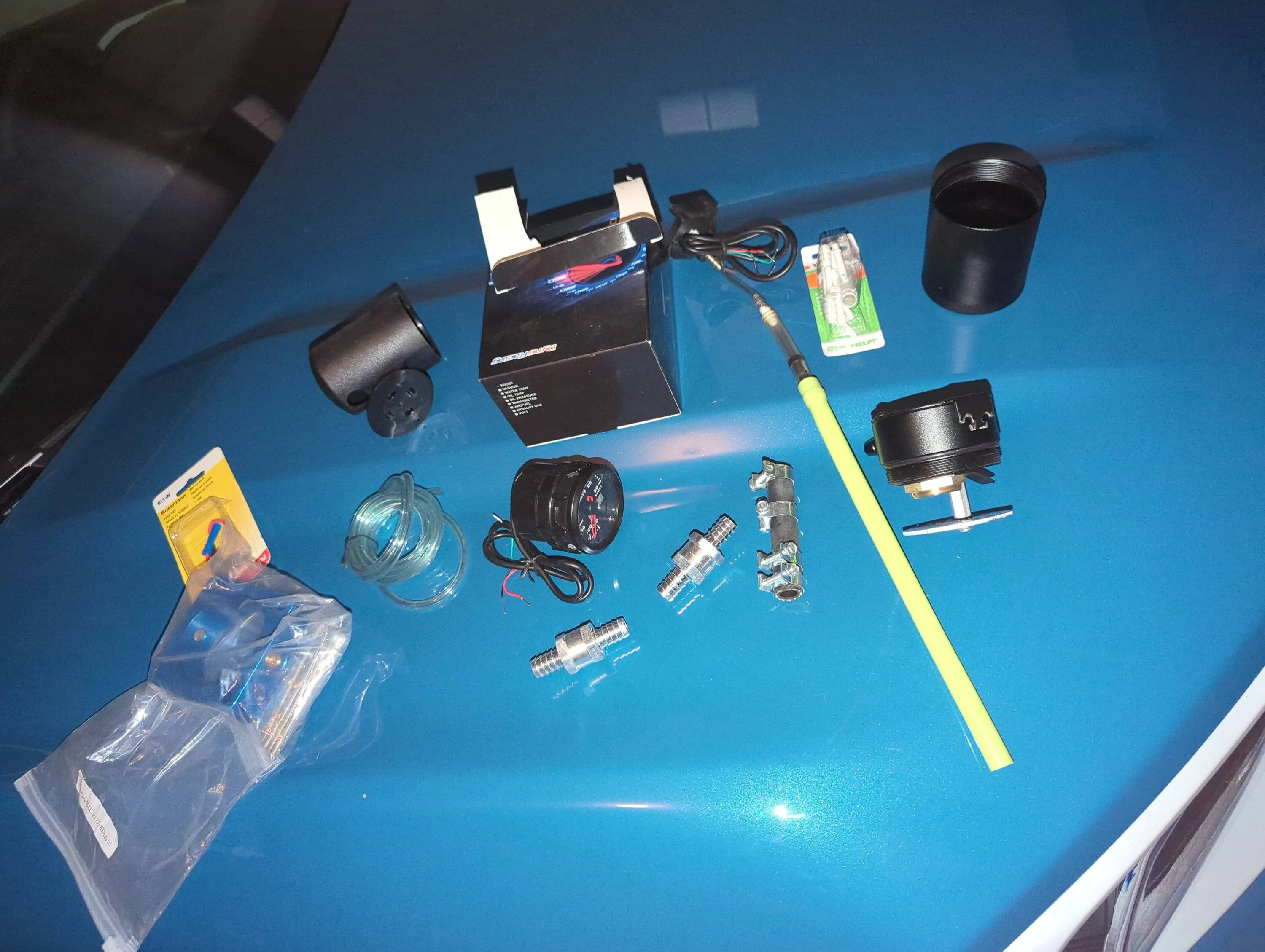

They're not really old parts. They're from like a year ago but here if you want a picture of the parts. I've got them all gathered together except for the blowoff valve adapter because I left that on the full size bronco but it's the same thing that I had on my 22 Badlands and I just ordered a replacement.
And it's not that they're not the correct parts. It's that I'm not going to pay $180 for something that I can get for 30 and I know that the quality is just fine for what it is. Same thing with the catch can sometimes they want over 200 bucks for those when I can spend 20-30 bucks and I just have to do the hoses myself. You know I've got the catch can with a filter and everything. And the check valves, and good clamps that aren't the worm gear clamps, lots of vacuum line with plenty of different sizes.
Basically It just comes down to if you want to spend almost 10 times the price on something so that it just bolts right up or not but this isn't something that's hard to figure out. I mean I've made my own supercharger kids. This is cake and honestly I think it's fun figuring it out myself and then I know that it's designed right and it's going to work right? And I know how it works if something does happen.
But I do get other people wanting to just buy something that's just plug and play and done. But I have more time than money and I love working on stuff like this. So pretty much almost always going to go this route.
And sometimes they're just isn't an option. Like I don't think anyone offers a boost gauge for these and I think that that's a very important thing to have on a boosted car. Going for my 2014 escape and I'm going to do one for this one. If I hadn't traded in my 22 Badlands it would have probably been done by now on that one

So for the actual setup they've changed a few things for 23 2.0 engine so I'm going to have to dig into it but once I have it set up I'll post about it here. But yeah basically I'm either going to have to cut a hose or when I had my full-size bronco I actually made an adapter to use the stock hose hookup.
And so I'm hoping that this has the same size and I can just use that. And so it's all basically plug and play. Nothing had to be cut on my escape because I was actually able to put a spacer between the throttle body and the intake. Which by the way, those throttle body spacers don't do anything for performance, but they had threaded outlets that I could hook a vacuum line up to and that's how I had it on my escape.
But they changed the bolt pattern for the throttle body on these so that blue anodized piece of metal in the picture. That's a throttle body spacer with a hole in it where I can hook up a vacuum line, but that's only for the older version of the 2.0 The bolt pattern on ours actually only has three screws and is slightly different so it won't work.
so I'm probably just going to tee into one of the PCV vacuum lines and I'll probably also use that for my oil catch can as well, but once I have it done I'll make a video and take pictures to show what I did if anyone else wants to do it
it will be interesting to see how it works out. These vehicles are sensitive to what and how something electrical is connected. Take pictures along the way so we can see the progress.
Yeah the electrical part is where I got stuck when I sold it because I wanted to use an add a fuse. You can see it in the picture and the package is unopened for a reason. I couldn't get into the where the fuses were. I was trying to be delicate with it but I have a friend who is very capable with electronics. He's going to help me when his time frees up. I had pretty much everything else already figured out, but since I don't want to cut the tubes and I've made that adapter, I'm going to try and do it a different way now so it might come out different. And the one other thing I still have to figure out is where I'm going to mount the boost gauge and getting the wires to the boost gauge without it looking hacked up because I had it temporarily mounted but the wires were going behind the trim near the screen and it just didn't look that good . But yeah I'll definitely post everything. It's not going to happen this weekend because my mom's pool cover broke and they want like $1,000 to fix it so I I got to get my MacGyver skills out and make a bracket to fix it so she doesn't have to buy a whole new cover. But I'm going to Yellowstone with the sport in May and I want it done by that so it shouldn't be too long from now.
