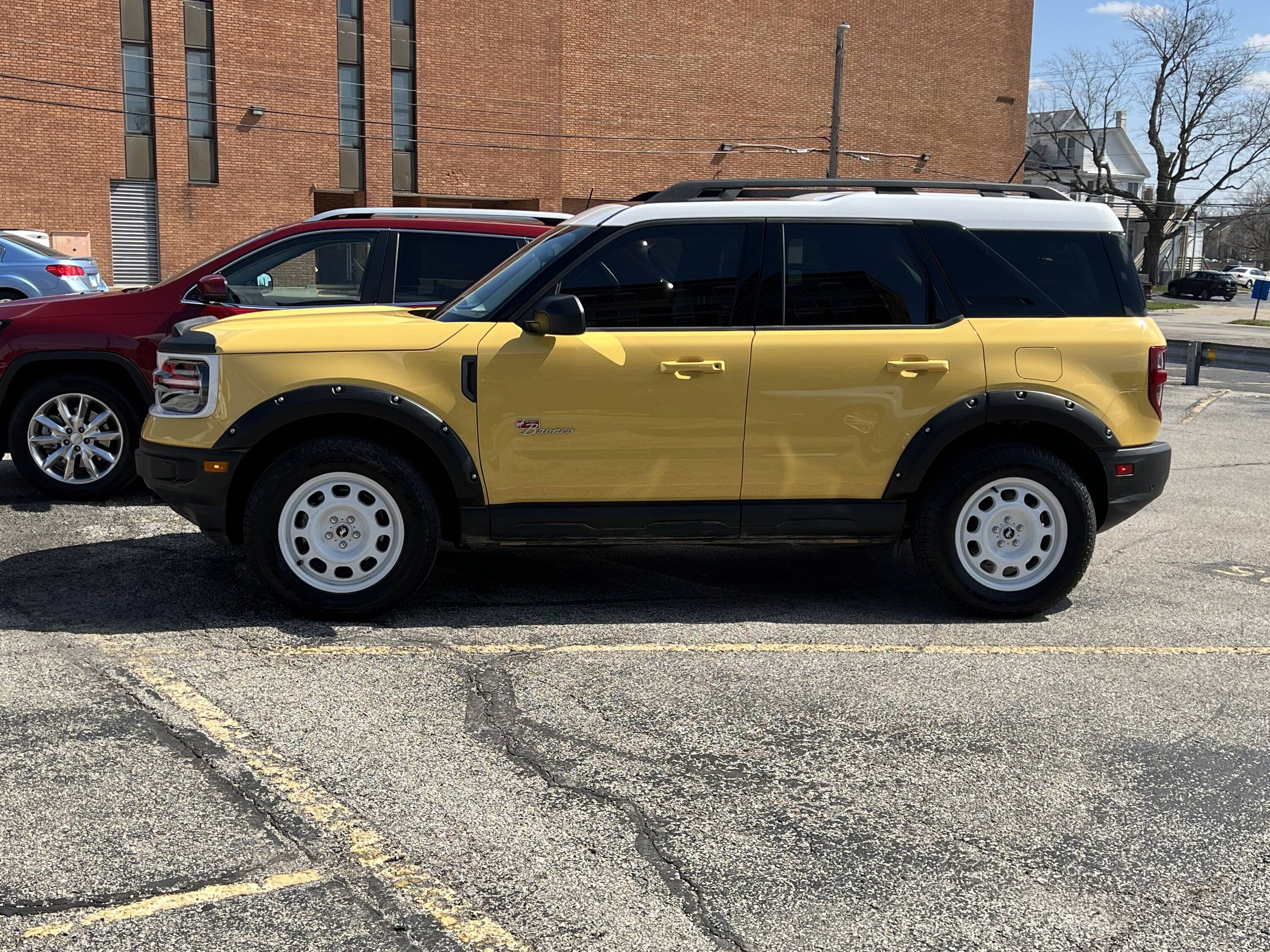

If you are entertaining the thought of purchasing a Heritage Limited, I'd check the pricing of lower level full size Bronco models as well and see what the best fit would be. MSRP wise, they aren't that far apart.
Thanks -- I LOVE the big Bronco and it would be ideal on the dunes but it won't work for me in the city (where I live 8 months of the year) or on the 250-mile trip to and from the wilderness house. I need something with a good highway ride and not-terrible fuel economy that I can park on a city street.

And to add my agreement with RSH, there are some ā€˜22 Bronco Outer Banks still on the lots by us. You can get one with nice options for the price of an HLE Sport and one main benefit is ground clearance, which you stated you might need.
GORGEOUS. Yeah, I think the HLE Sport is my car, worth the cost. Can't do the big Bronco, unfortunately.
Living in the city it just wouldn't work. I can only manage one car and it has to do everything -- road trips, fit into parking spaces, etc.
Plus this color hits a nostalgic chord for me (see yellow Willys pics I posted earlier). And in the hot sun the white roof will keep the car from turning into an oven.
