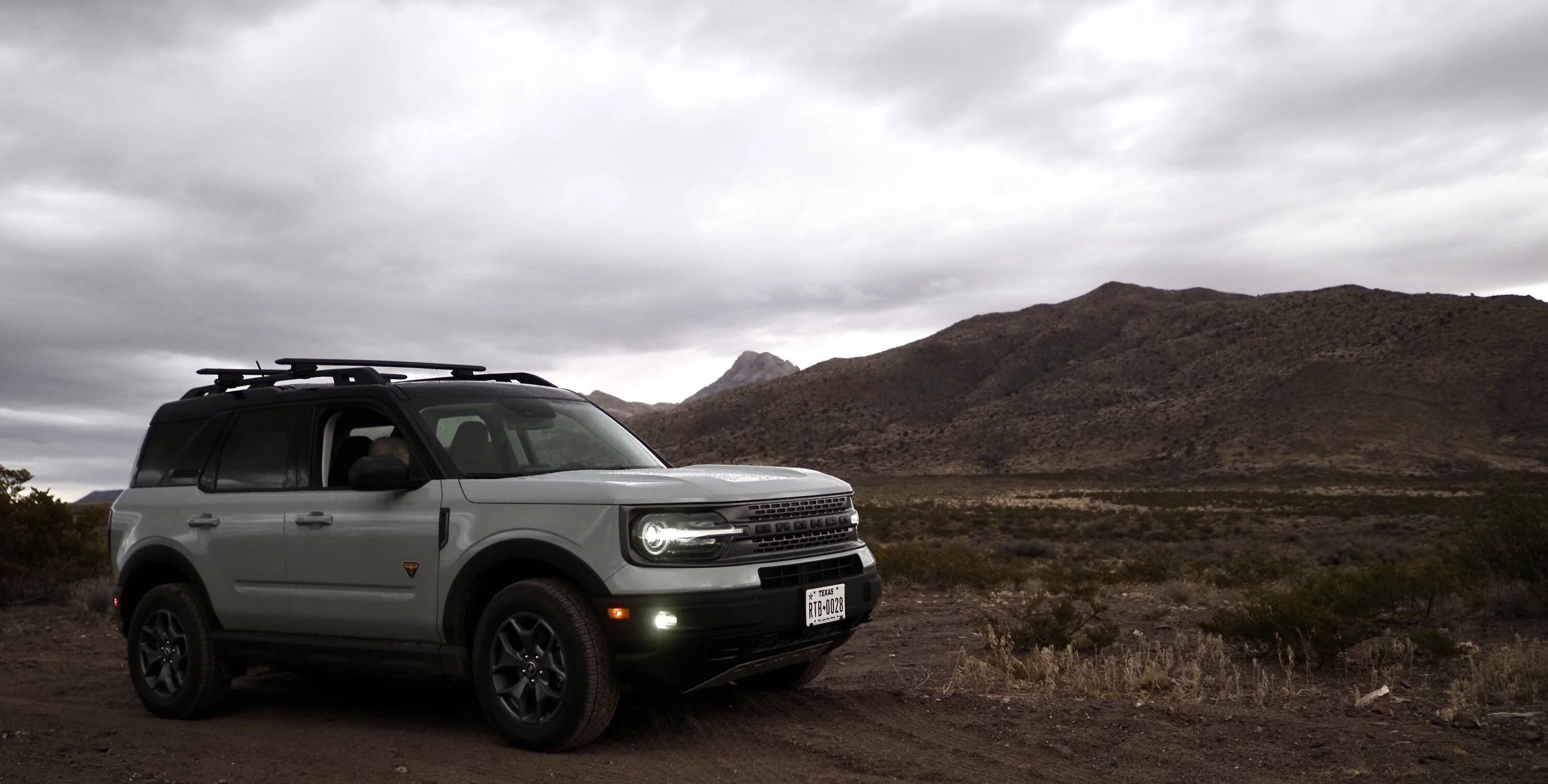

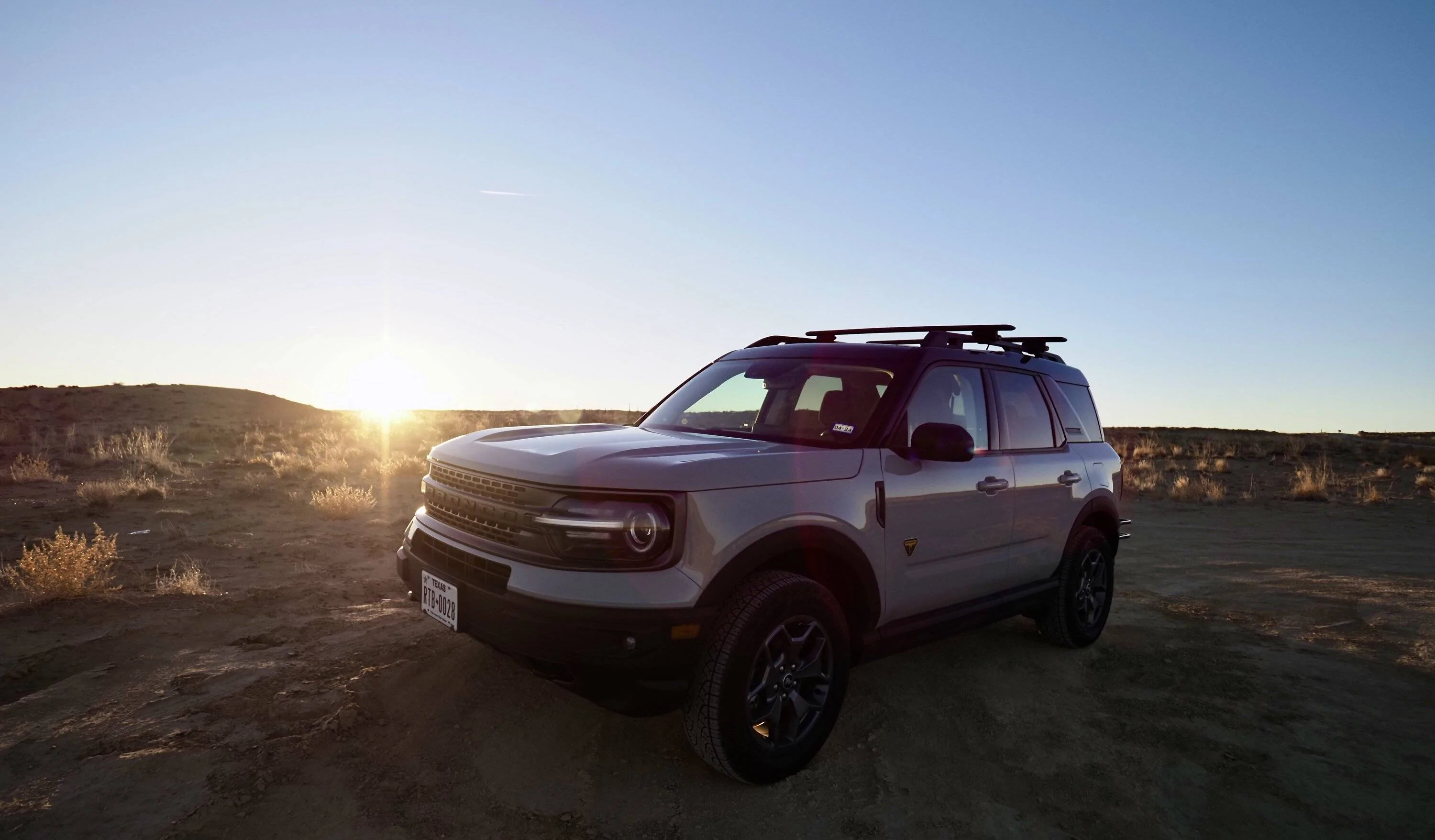

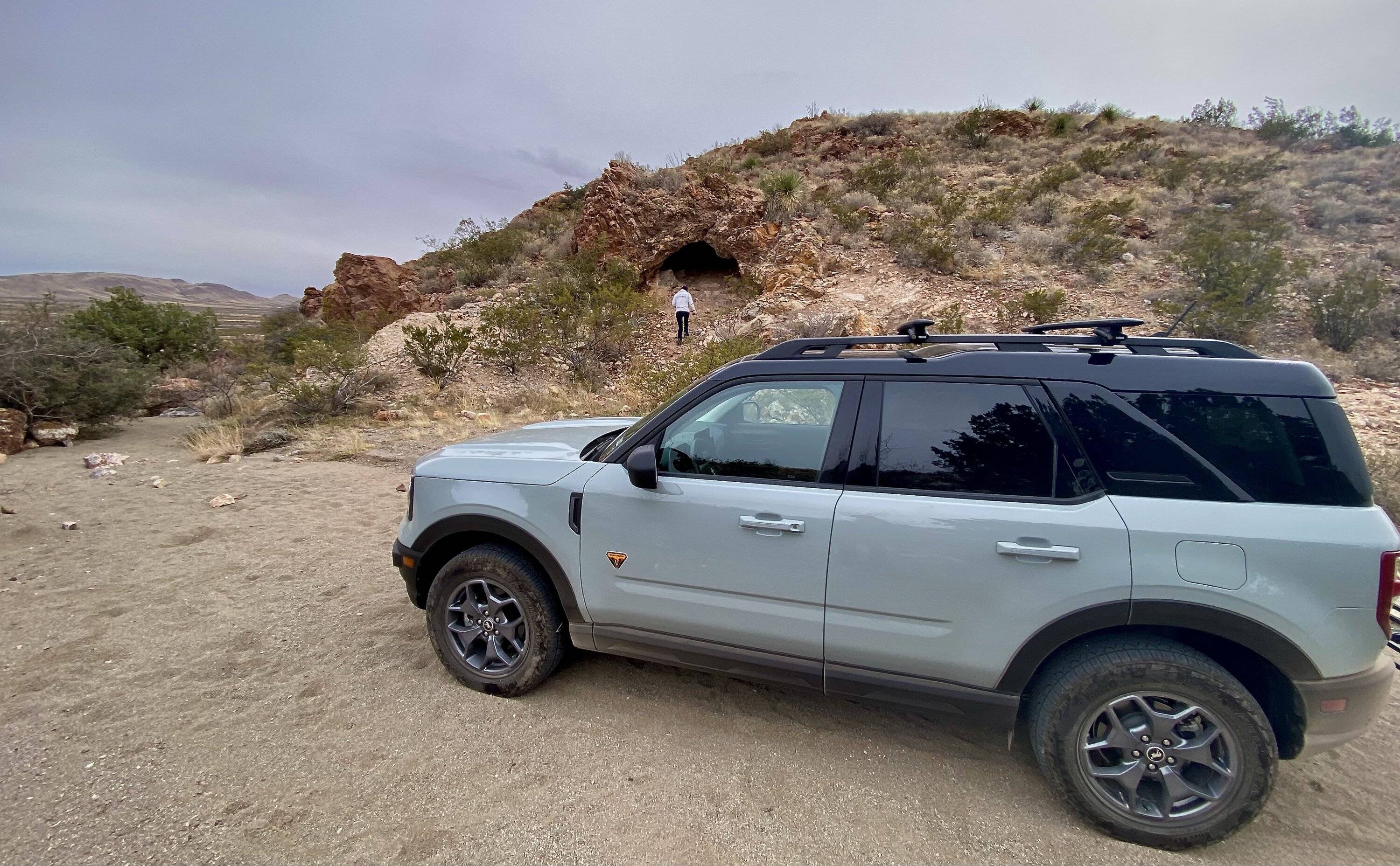

Not much sand where I drive... but I have driven on very sandy river beds with my OEM Pirelli Scorpion ATRs ( not the more aggressive Plus version) and they did just fine on rocky and sandy desert type terrain. I'll admit I was surprised and did not even air them down. I think once you've taken delivery of a BS you will be able to make your own determinations quite quickly.
I would not imagine overall clearance should be an issue on what I imagine is a sandy beach... meaning flatter than the rocky stuff I often contend with : )

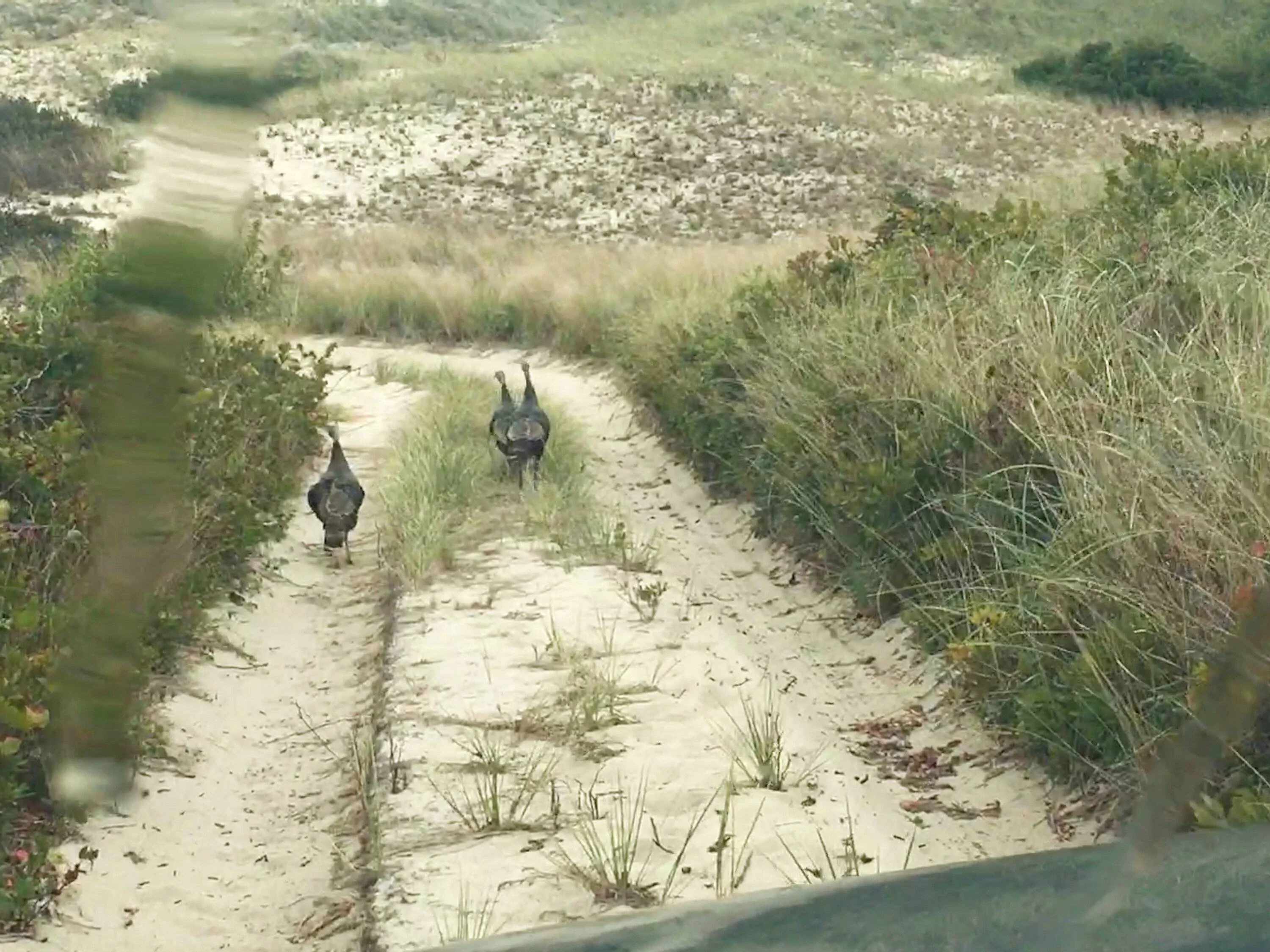

Turkeys in our road. You can see the hump -- it gets way worse than that. Every summer I have to get the bash plate of my Rav-4 re-attached. Finally I just gave up and left it off.
