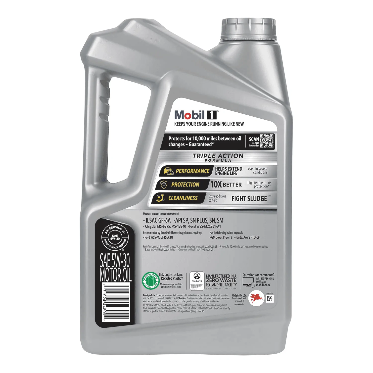

This is the back label on a 5 quart jug of Mobil 1 5W30:
Ford Bronco Sport Synthetic vs. Conventional Oil 1679601612498
I'm curious as to why it says:
"Meets or exceeds the requirements of" Ford 961-A1
But then:
"Recommended by ExxonMobil for use in applications requiring" Ford 946-A, B1
I'm assuming "Recommended by ExxonMobil..." is the oil company saying (essentially) "This oil is not officially approved by the vehicle mfr, but we are certifying (pinky swear) that it would get approval if it were submitted to them.
Does that sound right?
Next to that is says:
"Has the following builder approvals": and there is Dexos1 Gen3 and Honda HTO-06.
So that's 3 different claims -- only the last of which clearly states that has mfr (GM and Honda) approvals.
I'm not overly concerned about it but it does seem odd to have the different language.
BSBL owners who want to be absolutely sure to comply with 961-A1 might have questions.
