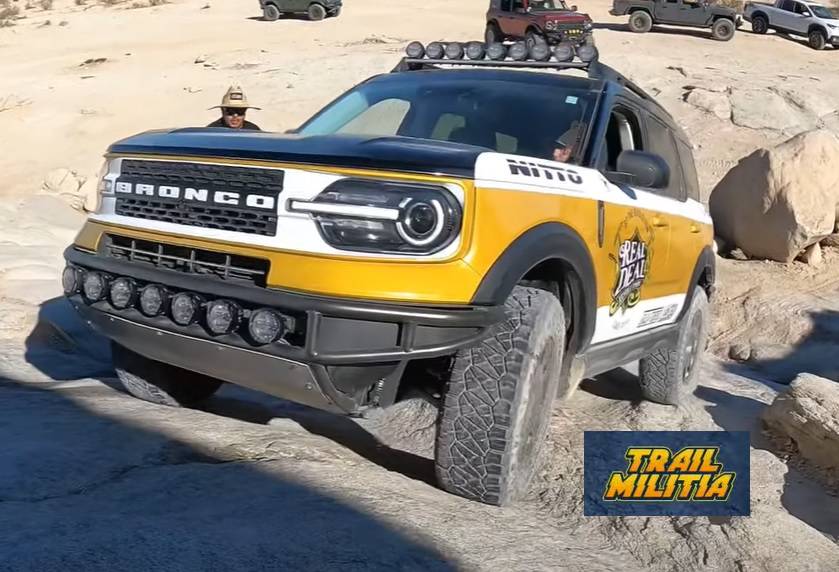

It all can be done...this BS/BL has steel replacement front and rear bumpers
Ford Bronco Sport Skid Plates BS front
Been several sports out there with steel tube bumpers but no vendor has offered ones for sale yet. So at some point we may see them and if so they will sell....
I think if you watch that video, the woman driving the BS says that they are not going to offer that bumper for sale because of how hard it was to relocate the ECU.
