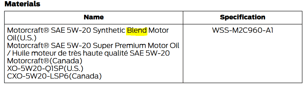

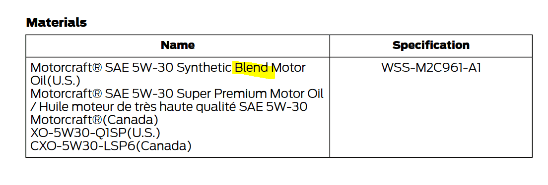

let's address the oil recommended by Ford
2.0 liter eng per owners manual
Ford Bronco Sport Boomba Racing Blow Off Valve (BOV) adapter; Vent to Atmosphere on BL 2.0 1654189030271
as you can see no full synthetic
not unless you head into the extreme cold operating ranges
1.5 liter eng per owners manual
Ford Bronco Sport Boomba Racing Blow Off Valve (BOV) adapter; Vent to Atmosphere on BL 2.0 1654189183409
once again no full synthetic until extreme cold climate
so the average owner will most likely be running a blended oil at best
non-synthetics as you can see are recommended
*recall err on the side of caution*

I was imprecise, and you caught me! I was using the term "full synthetic" as a proxy for "API SP." The important factor is the API quality rating. The only oils capable of meeting API SP (or ILSAC GF-6) standards are either full synthetic or synthetic blend oils. Either way, oils used in our engines (and most modern, small-displacement turbocharged engines) must meet the standard for NOACK volatility testing, which is a strong predictor of coking due to heat.

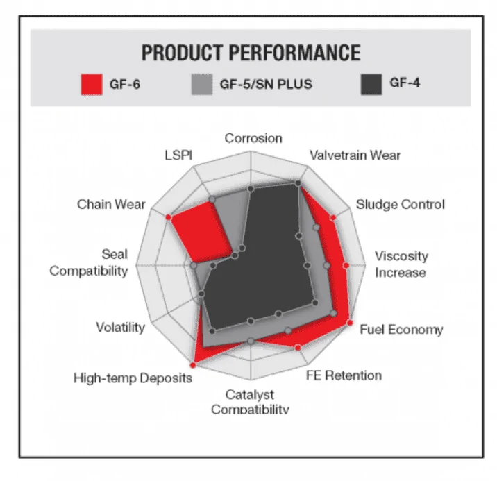

Ford Bronco Sport Boomba Racing Blow Off Valve (BOV) adapter; Vent to Atmosphere on BL 2.0 1654209883031
Of the 12 categories half show gains were accomplished for the GF-6 (A)
notably in the hi-temp deposits
and largest gain in chain wear
so does the chart boundary just terminate there
has hi-temp deposit met the final goal
somewhere I ran into a GF-6A comparison wheel to the GF-6B
boundary of the wheel expands outward indicating potential for improvement
I'll gladly acknowledge the improvements done in the last couple years
I'll still be wary of any hard shutdowns after a workout
