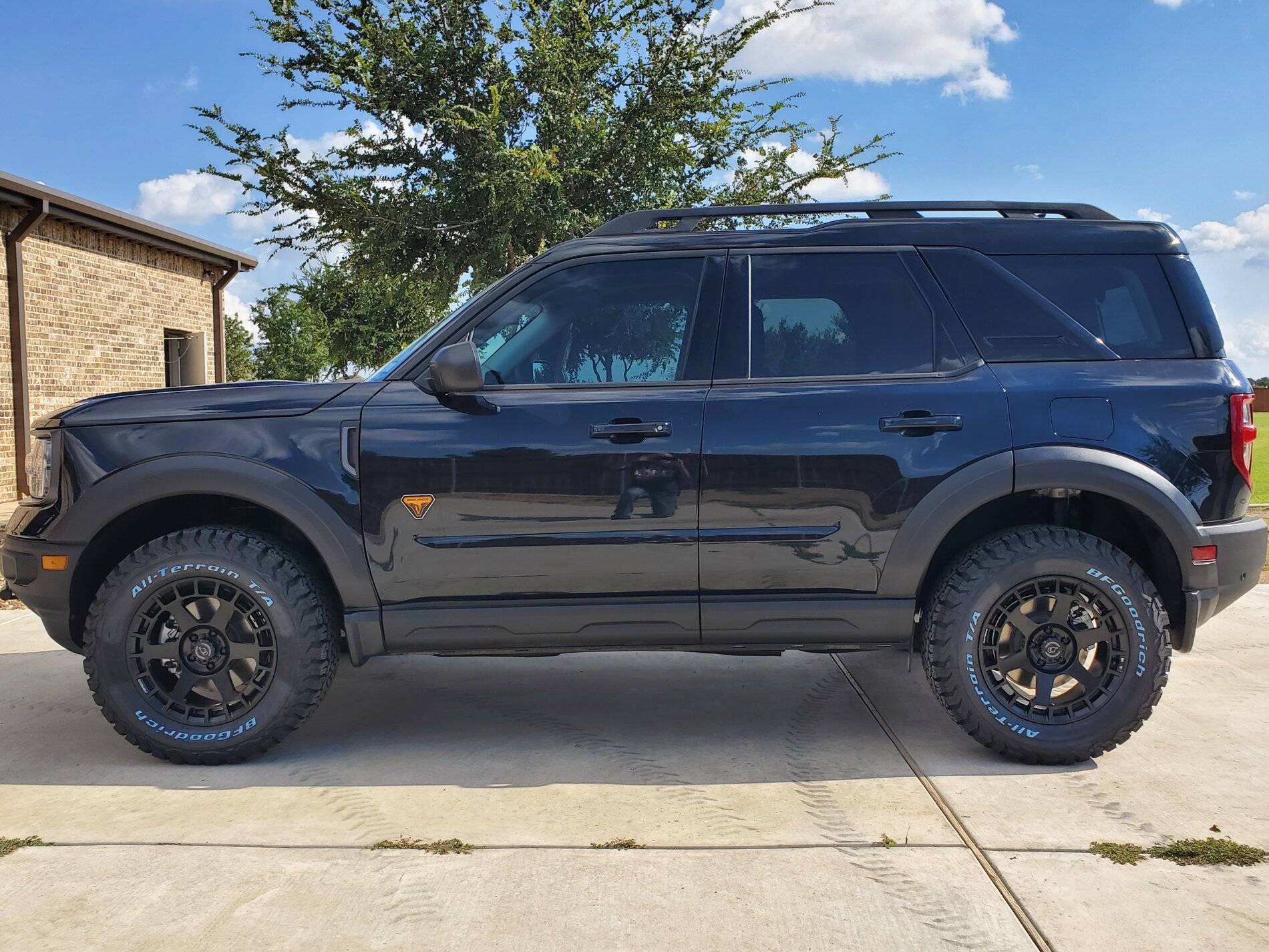

I love the look of those Methods as well. I too installed the Woolworth lift. Went with 255/65/17. rubbed on the felt liner but not metal. I used a grinder to take a little off the pinch weld to give it a little more space and trimmed the liner. I made a thinner liner out of Kydex and thermoformed it into the fender well. Works great.
Ford Bronco Sport Woolworth lift, Method 701 wheels, Toyo OC ATIII tires on Badlands Bronco Sport 20210815_172018
