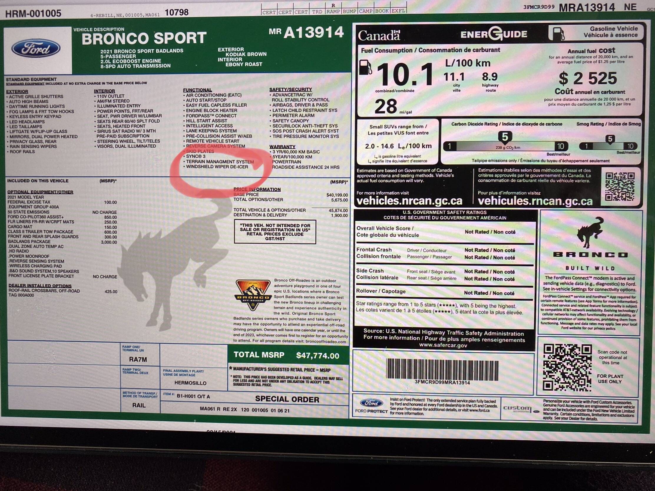

Assuming that Lethbridge is Alberta, Windshield Wiper De-Icers are standard in all trims of the BS in Canada, at least in the 2023 model year (I believe this was true for 2021 and 2022 MY as well, can't speak for 24). This also assumes the vehicle was originally ordered (retail or custom) for shipment to Canada and not the US. The windshield wiper de-icer is on whenever you hit the rear defroster button to on.
i believe you are correct.

The cowl area in my 21 BL is heated. I’m in Canada.
