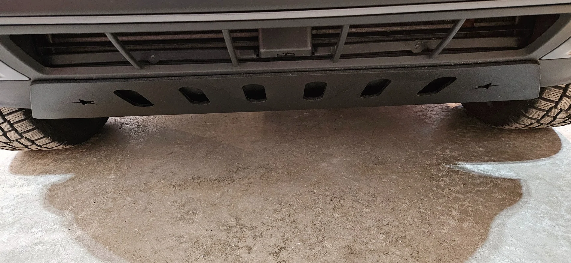

Installed the JCR engine skid on my BL a couple months ago. It's a pretty nice piece. There were some minor fastener issues, but I worked through them and JCR sent me some extra washers at no cost so I'm pleased with their customer service. I upgraded to the version with the oil change access door so I didn't have to remove the entire plate to do an oil change... something Ford should have done, in my opinion.
For Christmas, I asked for and received the HRG bash plate. I read on one of their sites that that they work together, and I guess they do......BUT, the HRG bash plate covers up the oil change access door on the JCR skid. I wish I would have known that before I ordered the JCR engine skid. I think I'll cut a hole in the bash plate to allow access to that door.... otherwise, I wasted my money on the upgraded version of the JCR skid AND I'll have to drop the entire HRG bash plate to do oil changes.
Also, I'm not entirely pleased with the fit of the HRG bash plate. It hugs the fascia in the center but leaves a 1/4" gap on the outer edges. I can make the passenger side fit better by loosening the rear most bolt on that side but I can't get the driver's side to do the same. Even if I could, I would be concerned the bolts might work loose. Also, HRG provides standard bolts and the hex heads are fully exposed. I'd be concerned that these might be damaged in heavy use. They provide spacers to put under the bolts. I wish they would have just welded in recessed pockets to make the bolt heads flush. In addition to eliminating potential damage to the bolt heads, it would have eliminated the need for the spacers. If I get real ambitious, I might try to fix this too.
I'm going to add these to my list of things to improve. I'll report back if I have any success.
Well, I said I would report back if I fixed anything, so here goes. By playing around with the provided spacers and some creative metal forming, I was able to get the HRG bash plate to fit nice against the front fascia. 1 problem down....2 to go.

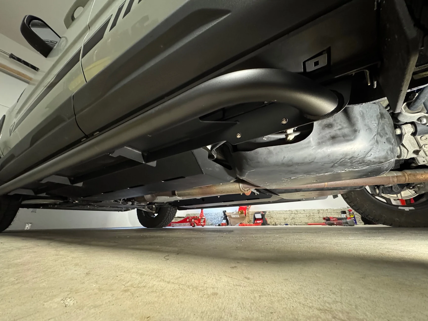

I have the EVAP/Floor Skids + Engine Skid with additional Bash plate from JCR... After banging these things around a bit, I can say the Engine Skid and Bash plate take most of the beating, I would start with those.
I can also report that drilling through the pinch seams for the EVAP/Floor Skids was really tough and required lots of drill bits to complete! Definitely buy the best metal bits your hardware store has and buy several.
