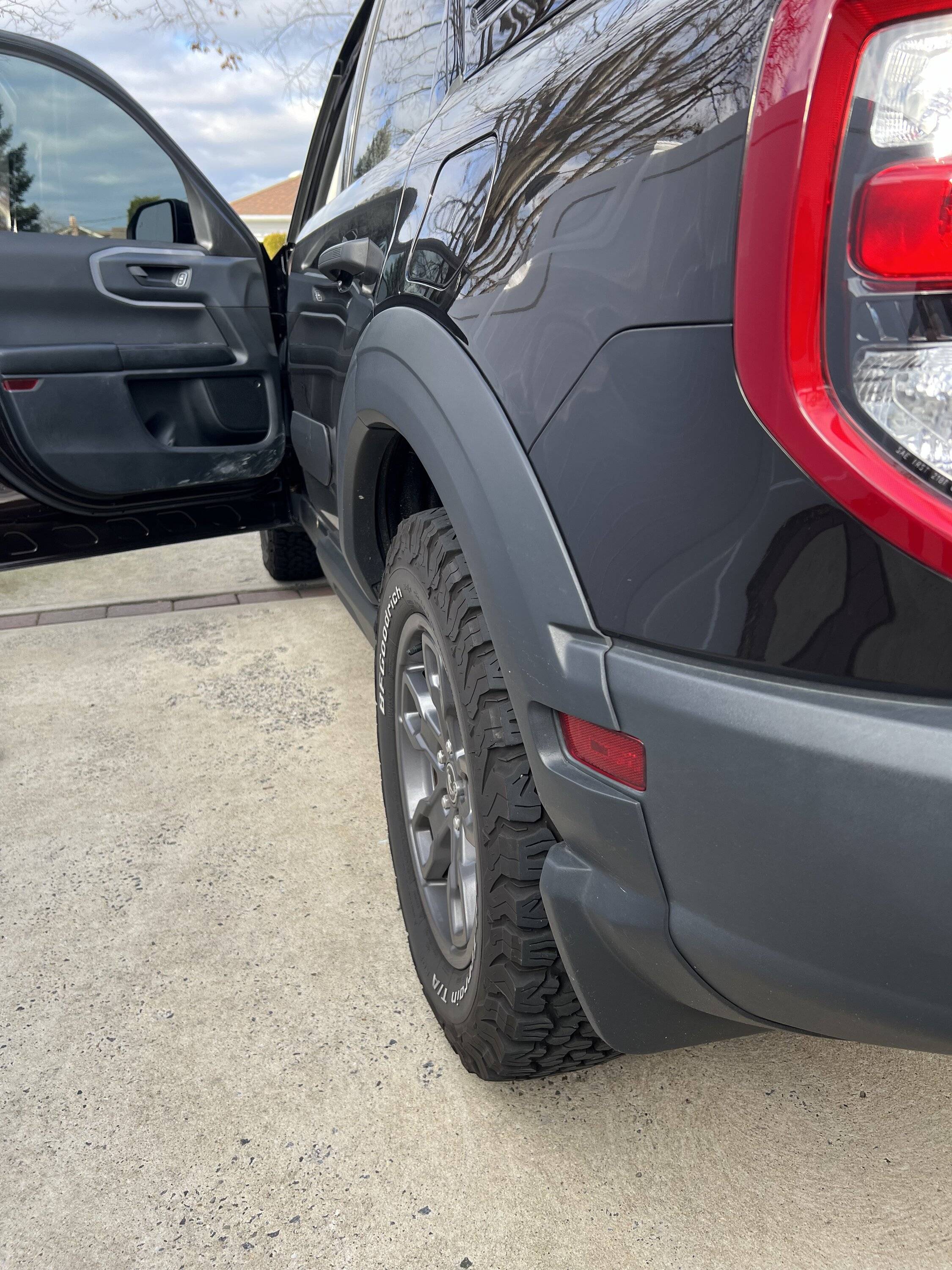

Looking to get some wheel spacers to space out my wheels to match my fender flares what are your experiences with spacers and brands? Any advice would be greatly appreciated thanks
Ford Bronco Sport Wheel spacers IMG_4573
If you’re thinking of going down that route then I’d recommend not cheaping out on spacers. It can be very dangerous. Get a reputable brand like Bora. Also maybe watch a couple videos on YouTube on how to properly install and retorque etc.

The point of the flares is to keep the mud and debris in the wheel well instead of on the side of your vehicle. Moving your wheels out defeats that purpose.
If it is just for looks, you might want to go with a wider tire.
