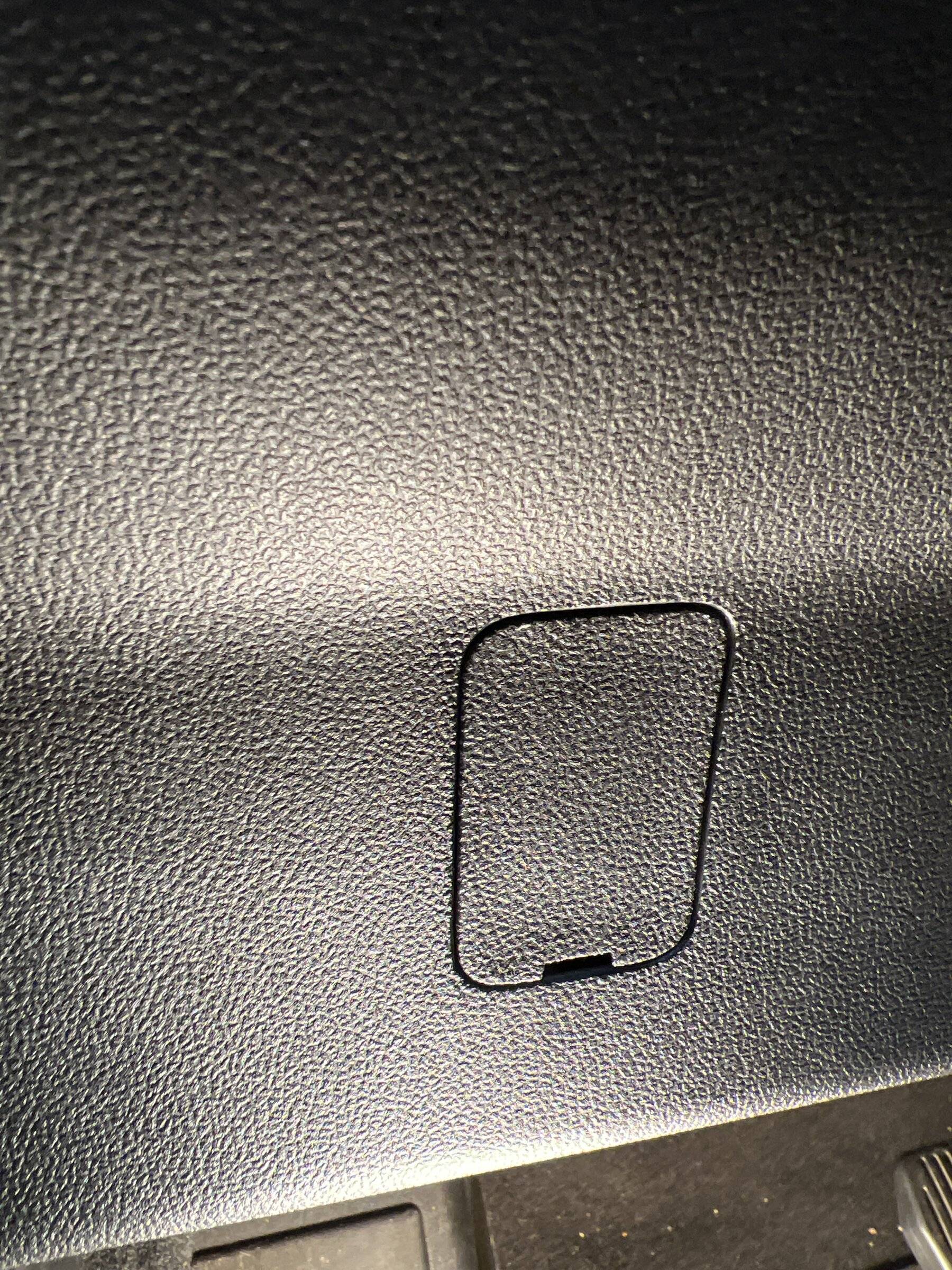

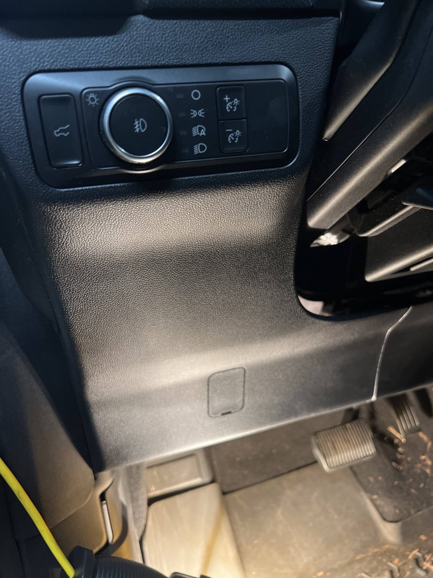

I was working on installing some lights on my bronco sport and popped off what I thought was a switch slot below the light controls but it was divided into 2 sections and had a red pull string behind it, does anyone know what this is?

Isn't that the manual release for neutral? Like when your battery is dead?

  1. Locate the manual park release cable access cover on the lower instrument panel dash to the bottom left-hand side of the steering column.
  2. Using a tool or the key blade, carefully open the access cover.
Note: Do not pull the tether until you are in the driver seat.
  1. Switch the ignition on, but do not start your vehicle.
  2. Once in the driver seat, fully press the brake pedal and hold. Do not release. Pull the orange tether towards the driver seat until the tether gets locked in the override position. Then leave the tether.
  3. If done correctly, a message on the instrument cluster displays Park Not Available, Transmission Not in Park, or Shift System Fault.
Note: Your vehicle is now out of the park (P) position and is free to roll.
  1. With your foot still fully applied on the brake pedal, disengage the parking brake. See Electric Parking Brake(page 175).
  2. Your vehicle remains in neutral (N) for emergency towing purposes.
  3. Switch off the ignition.
10. Once safe to do so, and there is no risk that your vehicle will roll, disconnect the negative, black, battery cable from the battery. If the vehicle rolls before disconnecting the battery, the electric parking brake could apply. You may need to release the parking brake again. See Electric Parking Brake (page 175).
Returning Your Vehicle to Normal Mode
  1. Once it is safe to do so, reconnect the negative, black, battery cable to the battery.
  2. Apply the parking brake. See Electric Parking Brake (page 175).
Note: If vehicle battery is dead, for example, no electrical power is available, you could use an external power to apply the parking brake.
  1. Fully apply the brake pedal and hold. Do not release. Pull the orange tether outward toward the driver seat to release it from the override position.
  2. The cable releases and retracts back to its original rest position.
  3. Stow the manual park release cable tether back inside the instrument panel dash hole, install the access cover by pressing it back in position.
