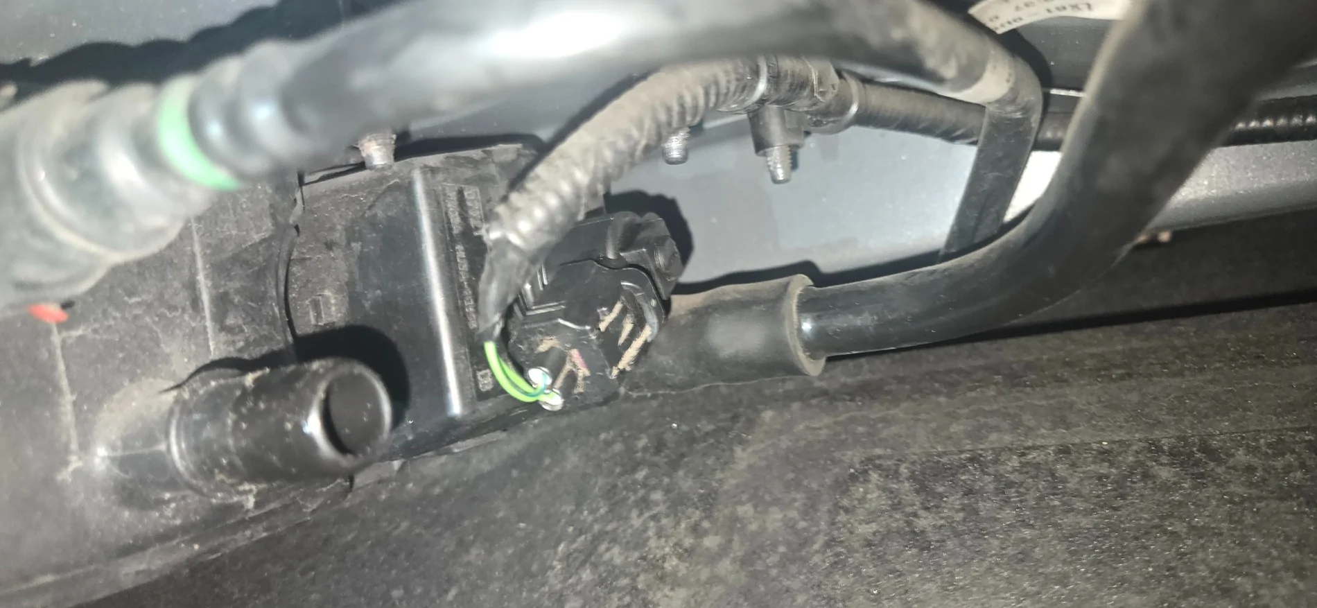

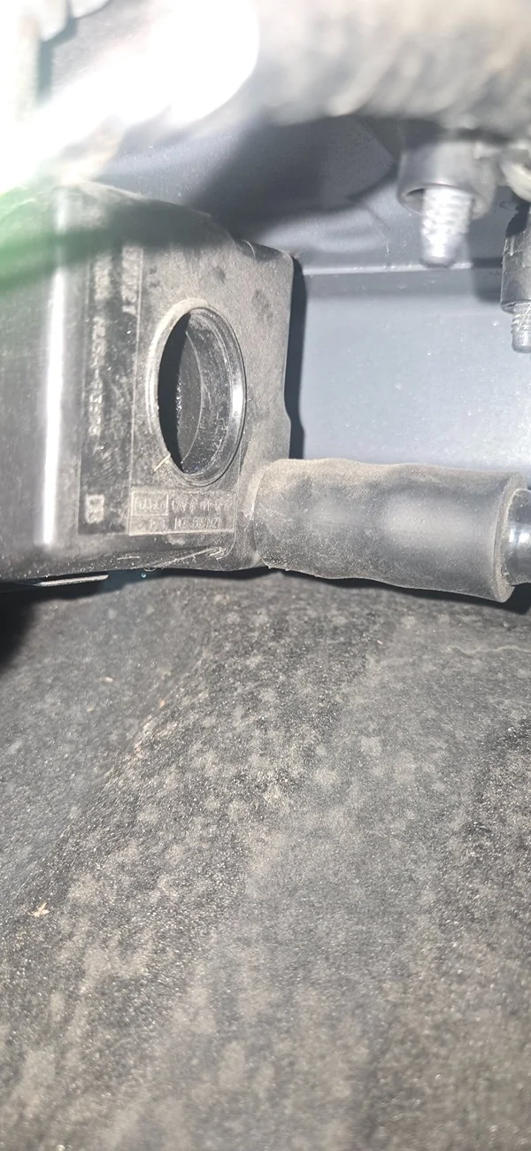

I'm replacing the vapor canister vent solenoid on my 2022 Ford Bronco Sport 1.5 L Outer Banks, and I cannot get it "seated" back into the carbon canister. Nothing is clicking it back into place, so the component is just placed loosely in the canister. Any guidance?

Questiions:
I have never heard of a vapor canister vent solenoid failing on the BS. I have replaced my EVAP purge valve assembly twice.
What code were you getting to determine this was an issue?
Can you post a photo of the old vapor canister vent solenoid?

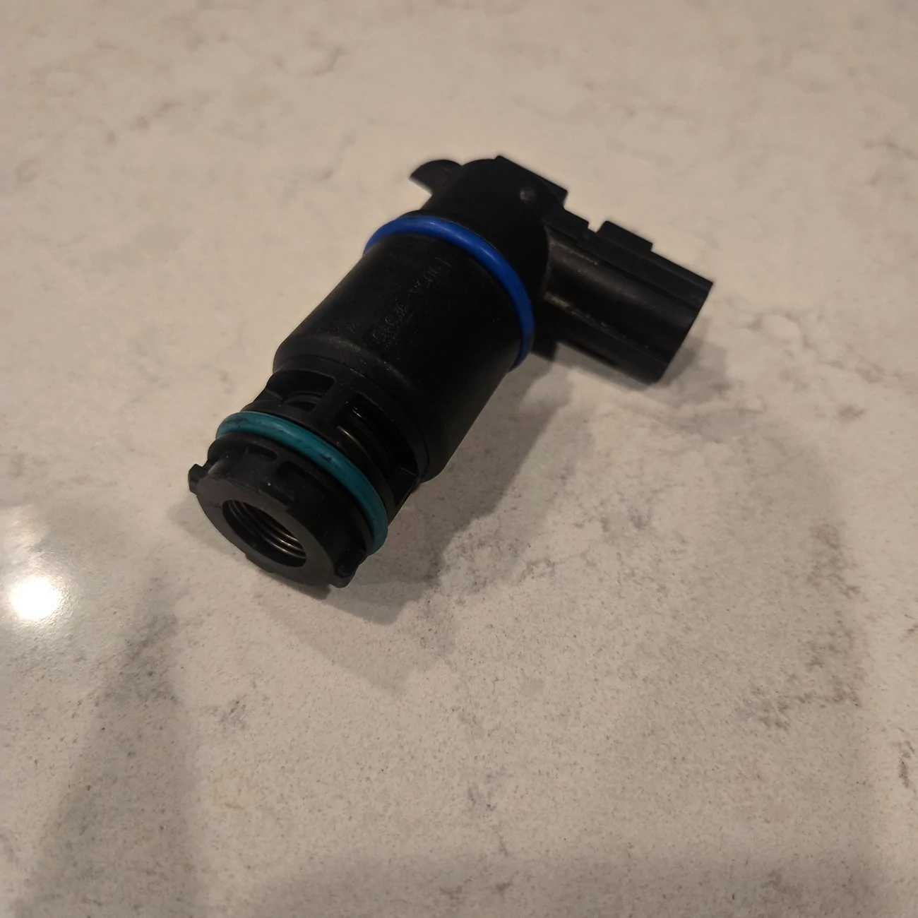

I'm getting the P0456 code. Here's the component:
Ford Bronco Sport Vapor canister vent solenoid 1000009010
I just can't get it seated properly in the canister even when twisting in reverse of the way I removed it.

The “instructions “ say
• Align the orientation tab/flat side on the solenoid with the canister port.
• Push firmly straight in until the retaining clip engages (or until stops on the grommet)
Probably doesn’t help huh?
It's odd because nothing's engaging (and I've tried replacing the old component without any luck). I'm hoping I just need to get a better angle on it.

My first guess is the part needed to make the solenoid seal is now on the inside of the canister

Looking at the diagrams of the charcoal canister assembly I think you'll need to remove the canister so you will have complete access to install the vent solenoid. Then reinstall the canister and it's connections.
Hopefully the canister isn't damaged where the solenoid connects to the canister. Good luck.
