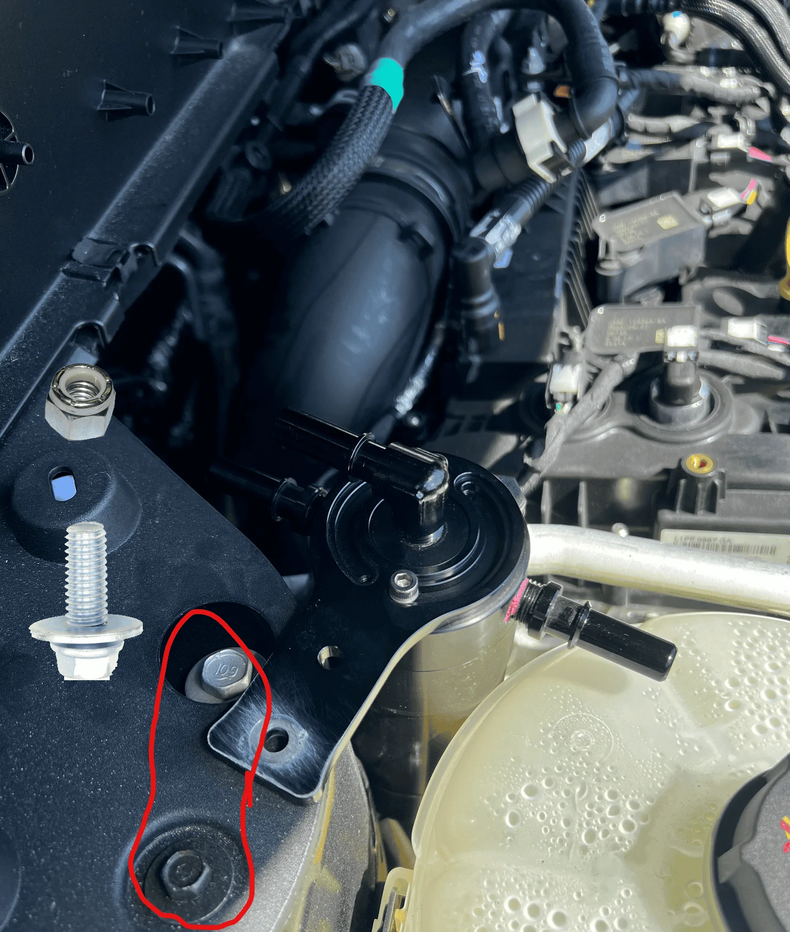

What about using that vestigial mount on the strut tower cover? I always thought a lighting relay or extinguisher mount or something else belonged on it.
Ford Bronco Sport Understanding the 2.0 PCV system. 1685111334921_2
I feel the plastic won’t really secure the weight of the can, especially if I’m off-roading. Seems like the can would be knocking around a bit in that scenario.
But I do appreciate the insight! If anything I’ll model it and see if there’s something there.
there’s a few other good options for mounting. I have more pics. But I’ll provide a fuller update when I actually order everything I need.

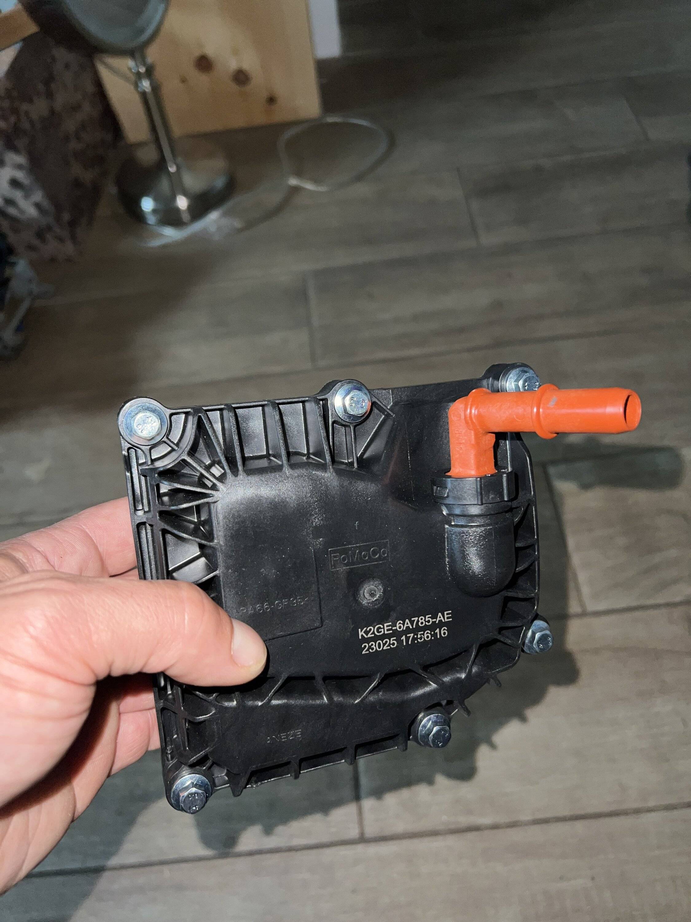

So this thread was created when I first purchased my BS BL, because I knew I instantly wanted to put a catchcan in a GDI car and I wanted to do it right. The JLT or JSC or whatever they wanna call themselves now, is not a well done can in my opinion, for reasons I've already highlighted. Boomba Racing also makes a plugnplay can for the Ford Maverick so Im sure it would also work for the BS BL. But it also has the same drawback of keeping the OEM check valve in place, and then pressurizing the can everytime you go into boost. Their can is much better qaulity material and build tho.
So I can confirm that the 2.0 block has changed since its 2020 and earlier predecessor. The PCV plate is different and the Radium plate will no longer work.
Ford Bronco Sport Understanding the 2.0 PCV system. IMG_4550

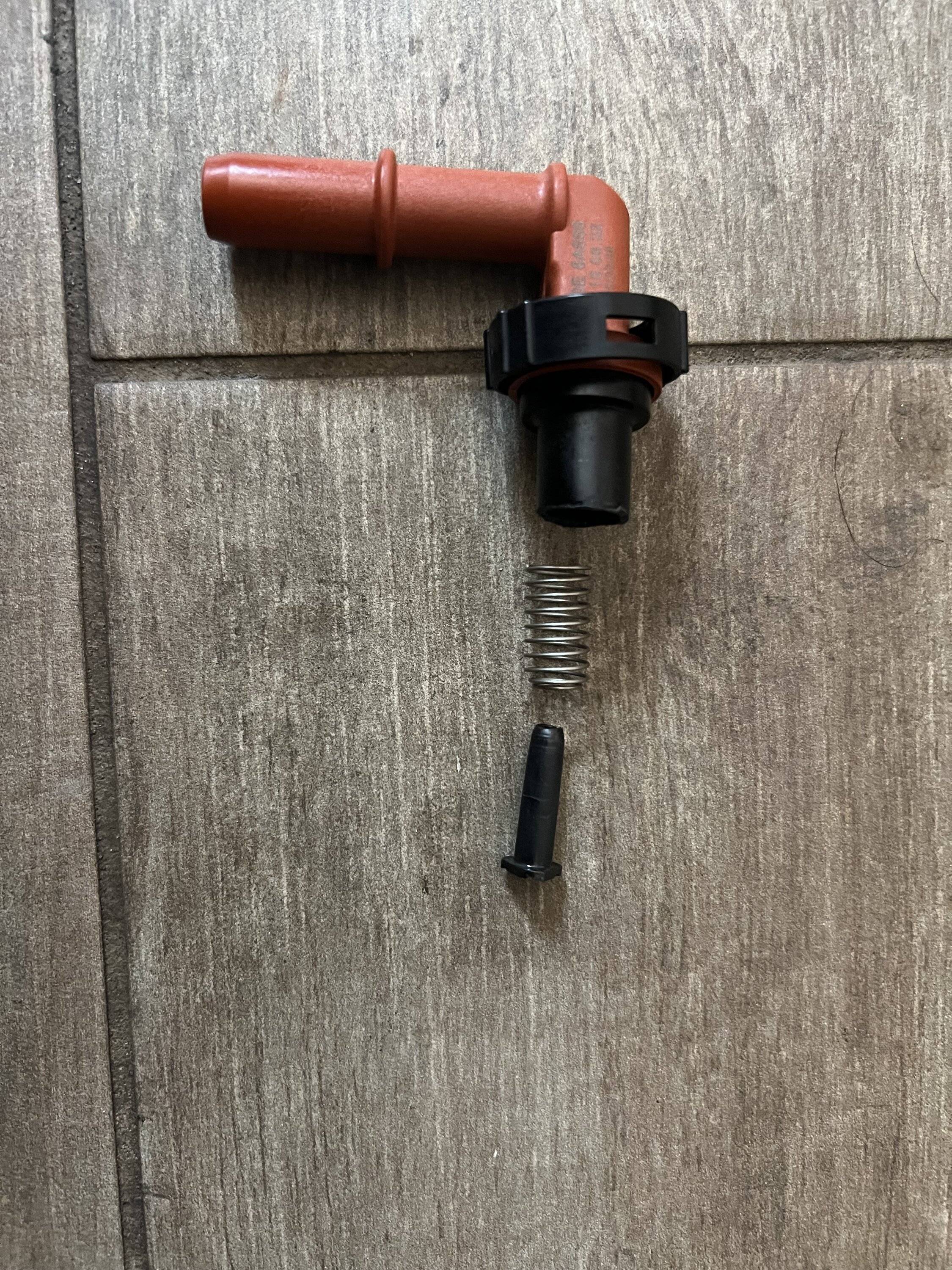

So my only option is to gut it. Not a big deal. Ordered one online for $50. And let me tell you, I can tell that the valve is heavy from the minimal airflow I get on suction. I felt it worse than the the old OEM plate. I can also tell you that the valve leaks from the tiny, tiny, seepage of air when blowing into it.
Here is the valve/plunger, and spring. The valve on my 2.3 was made completely out of ceramic. This one SEEMS to have a ceramic core with some sort of metal anodization that gives it some weight. It is much heavier than the valve on the old plate. I imagine that they started anodizing these valves to make them more durable from the thousands upon thousands of poundings it will take going back in forth in the chamber.

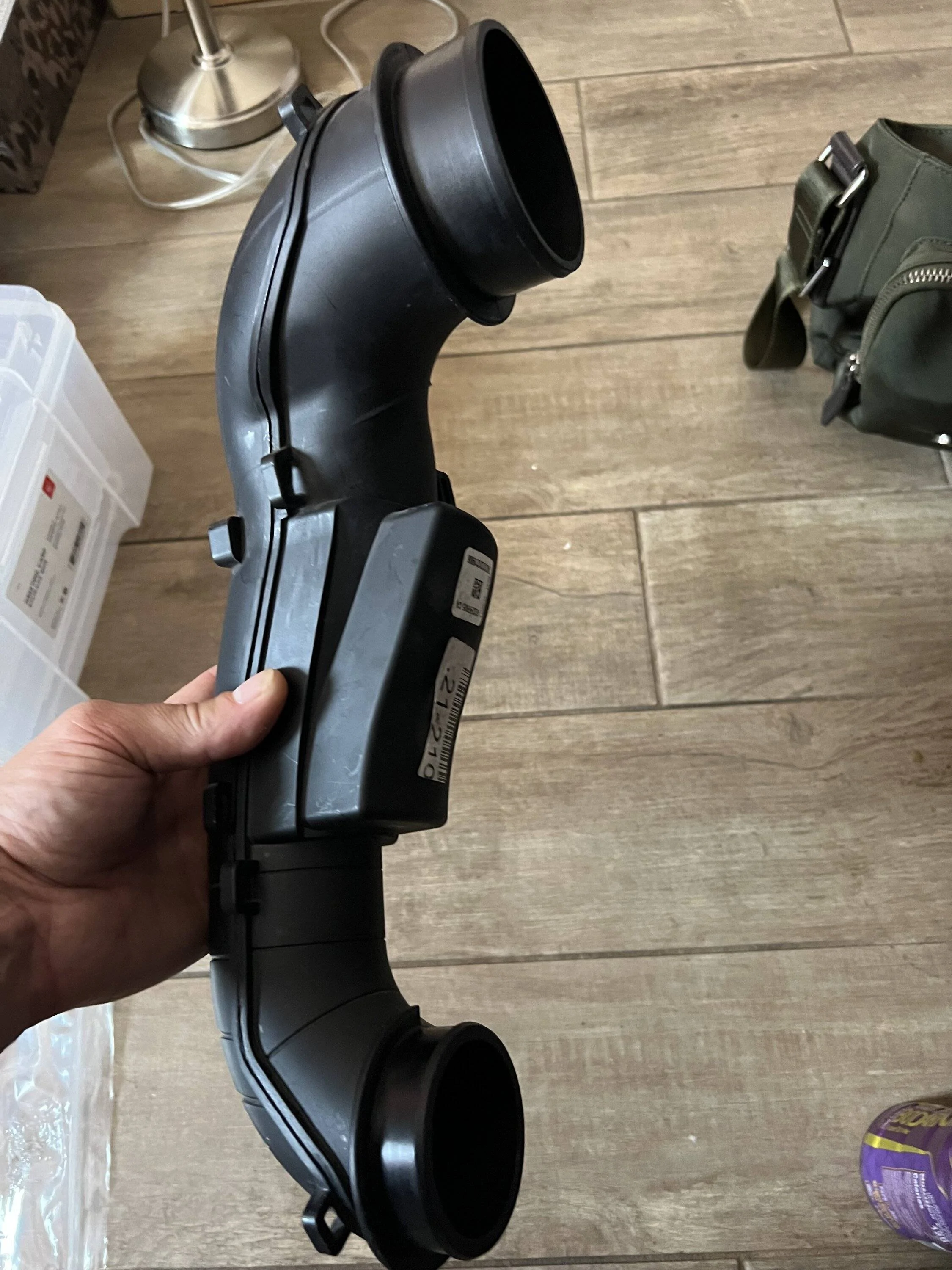

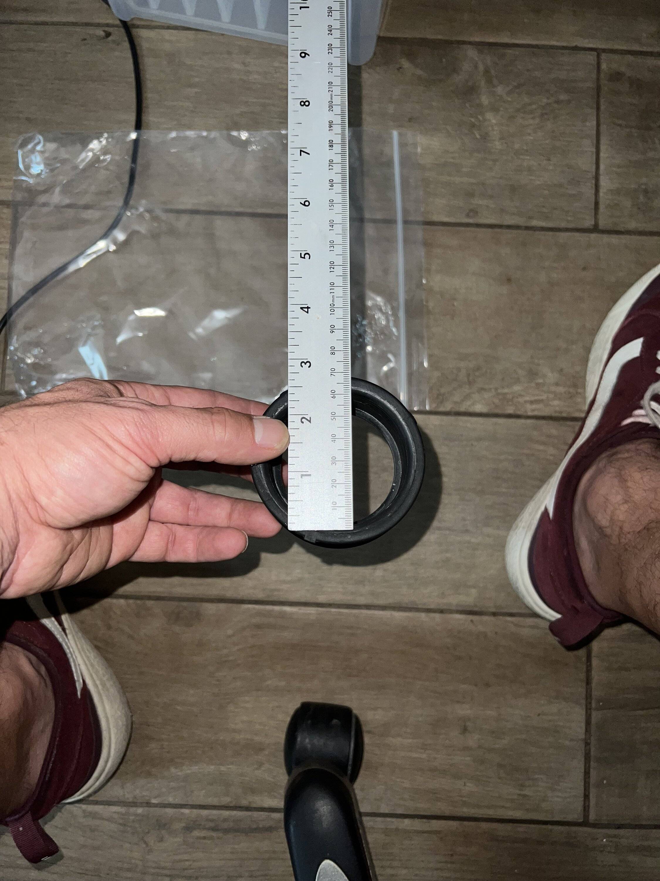

Lastly, I was able to confirm the turbo inlet OD, and I only did that buy finding the air intake pieceoff a wreck and measuring the coupler that would go into the turbo. So I had to sinkg another $50 into fact-finding, but well worth it, once I get my setup. The info online about our turbo, in particular, since they stopped making the Focus, is very minimal.
Ford Bronco Sport Understanding the 2.0 PCV system. IMG_4568
63mm aprox
Ford Bronco Sport Understanding the 2.0 PCV system. IMG_4572

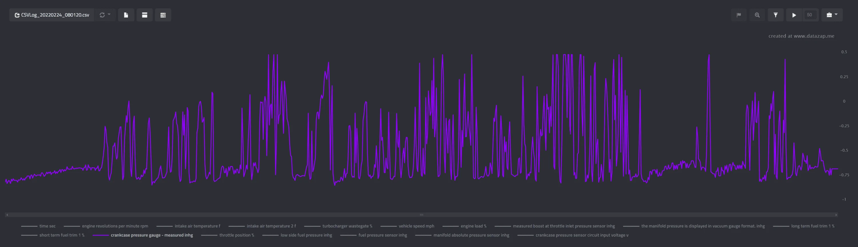

So I just did a test and took the oil catch can and the check valve out of the vacuum lines so it was just lines like normal and my boost gauge didn't show any change and I waited. Made sure the engine was up to full operating temp on both of them. Now the smallest point in the lines I guess would be the check valve but they're still 1/2 of an inch so they are decent size. I don't know if you thought I was running a lot snaller lines and that's why it would cause the drop in vacuum.
Also, I was trying to think about it in the abstract and the vacuum is coming from the pistons up and down and just cuz we're adding another line to the manifold. I don't think that should really affect the total vacuum of the engine. Whether the line becomes a restriction to the PCV or not, it might affect the PCV vacuum in the crankcase, but I would think that the total manifold vacuum would stay the same because it's not causing a leak and it's not like it's changing the cam timing so there's not like extra overlap like if you had a big cam which can lower vacuum. But if I missing something please let me know. It is something I'd never thought about before and it's pretty interesting topic.
Please don't take this the wrong way, because I appreciate the engagement, but its very hard to follow your posts.
Google 'valve cracking pressure'. The pressure/vaccuum on one side of the valve will not be equal to the pressure/vaccum on the other side of the valve. Put two valves, in-line, serially, which is what you are describing and the vaccuum being drawn at the throttle body will NOT be the same as the vaccum being drawn out the PCV plate.
You also will not notice this on your analog gauge. The increments on vaccuum in the cranckase is way too small. Further, Ryour analog 'boost gauge' is measuring the pressure at the manifold AFTER the throttle body (I would assume even though I'm not sure what you used as a boost ref for it). This won't change no matter what you do to the PCV. What you want to measure is the vaccuum coming out the PCV plate. That is DIFFERENT.

So I guess what I'm not following is at first you were saying that this could cause an issue with my idle vacuum at the manifold but now you're saying it's not that it's just the vacuum at the PCV valve. And I guess if the changes in vacuum are so minute, they won't even show up on my gauge. It doesn't seem like it's something that would matter.
Also with that valve cracking pressure, I'm not sure how much that applies at least for me because it's only for the very first instant of a valve opening and closing. And I mean sure that happens a lot on these where it's going from vacuum to boost, but it's for such a small amount of time doesn't seem like that's something we would want to measure and monitor anyways even if we could. It seems to me what we're really wanting to see is the equalization of pressure throughout the whole system which is still pretty instant. Because it's you know it's like water. It travels to the path of least resistance until it equalizes in the whole system. Whether it's a 1 inch wide hose or a 1/8 inch hose, it should still equalize and read the same and that seems to be. That's why we usually use. I mean I'm just thinking about a fox mustang that my brother had and the vacuum tree and it had all kinds of different line sizes and it was able to function okay so I guess I'm just not understanding how this would cause issues.
And yes, I monitor boost from the manifold after the throttle body because that's what the engine is actually seeing. My boost gauge references the off of the PCV line from the intake manifold before the check valve because it was after the check valve it would be useless once boost pressure hit and it wouldn't see anything but that's how mine is set up.
