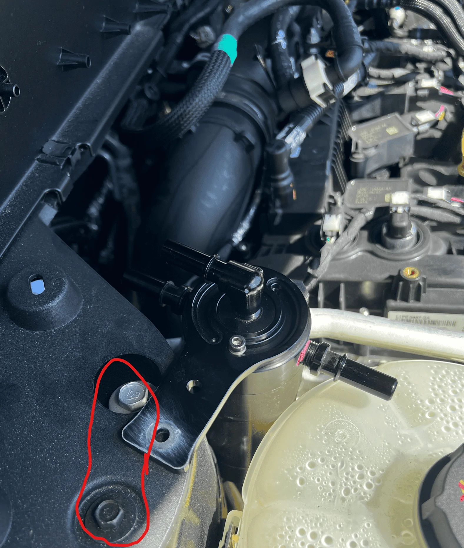

So I've been working with UPR to build a catch can kit.
Question for the forum:
Can anyone tell me if either of the below bolts are suspension critical? I feel the one on the bottom is probably just to keep the plastic on, but unsure about the recessed silver one on top. Ideas?

The silver one holds the strut top (1 of 3). The black one just holds that plastic cover in place.
That's what I thought. The black one it is. Thank you! I'll have more details to follow soon.
