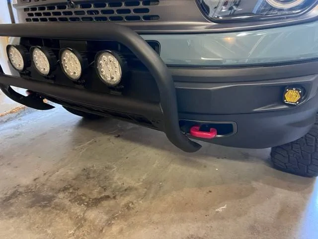

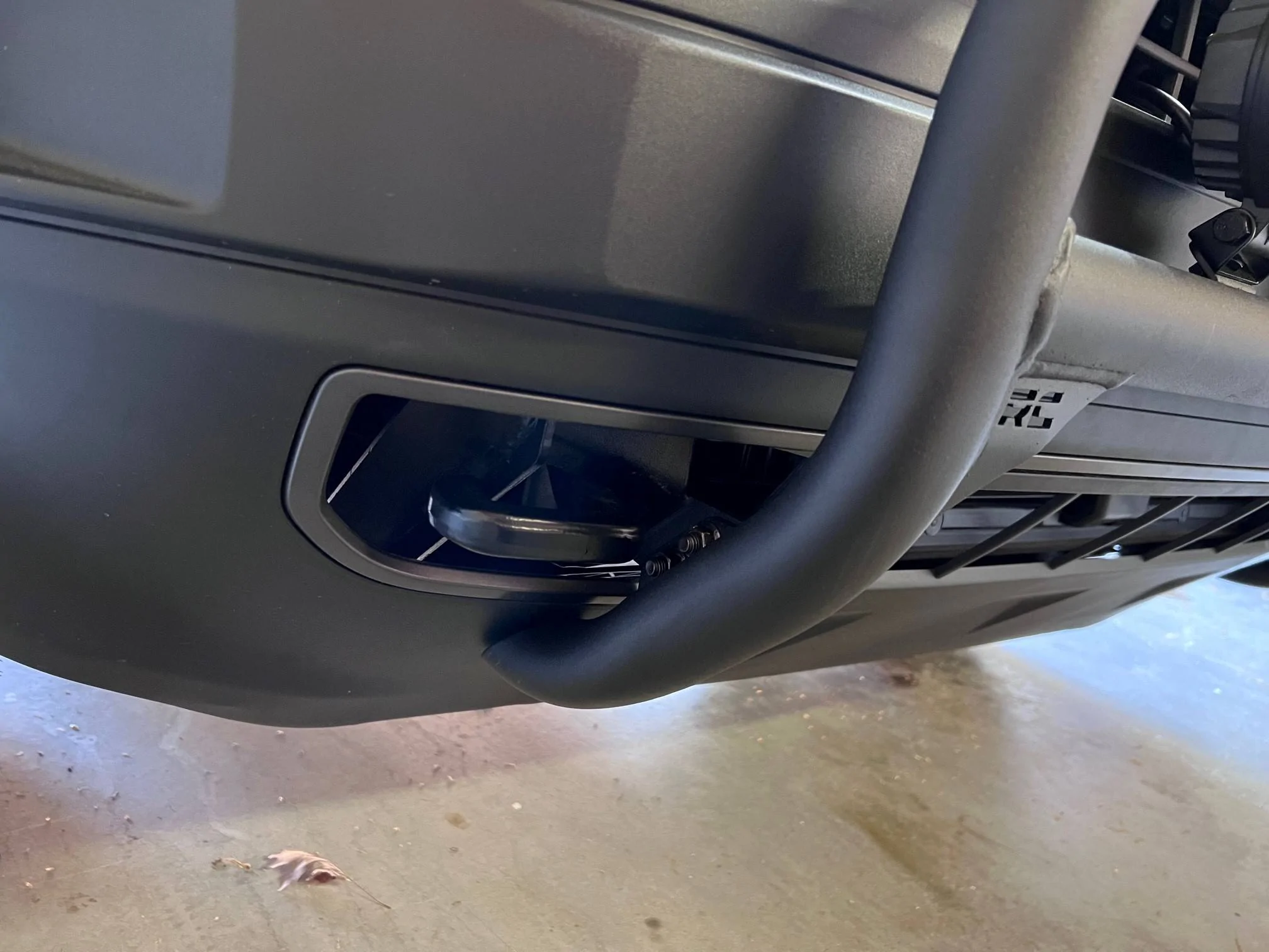

Yes! You can have you cake and eat it too. RC Nudge bar and tow hooks. Just need to notch the bracket and lop off the whole bottom of the bracket because it's dead weight and doesn't line up with anything. This install is on the 2023 Badlands. I was determined. I also had to paint the hooks red to show off that they are really there. haha

Yes, it IS possible. I have it done and still have the hooks! I even painted them red so you can tell that I still have them. haha

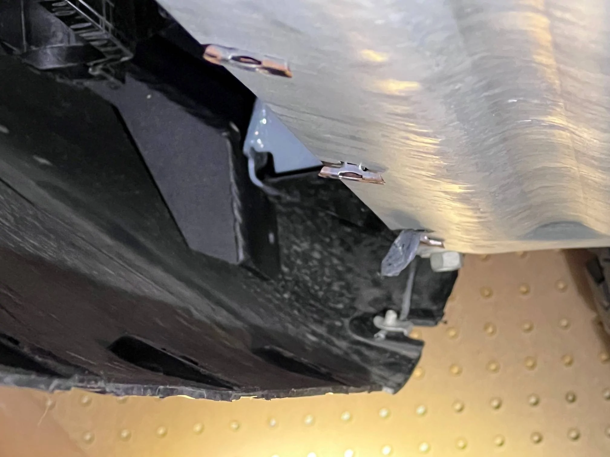

There is a crossbar that isn't on the BL, but even with it (yes, I even ordered it in case it would work), it doesn't line up. The lower section of the bracket was just dead weight, so got it cut off.
I was denied installation by several places, but one Ford dealership took on the task and so glad they did.
You can see from the last picture that the frame and the RC bracket don't line up. It wasn't worth trying to weld them together somehow.
Rough Country claims that one day they will one day have one made for the BL, but I didn't want to wait.
