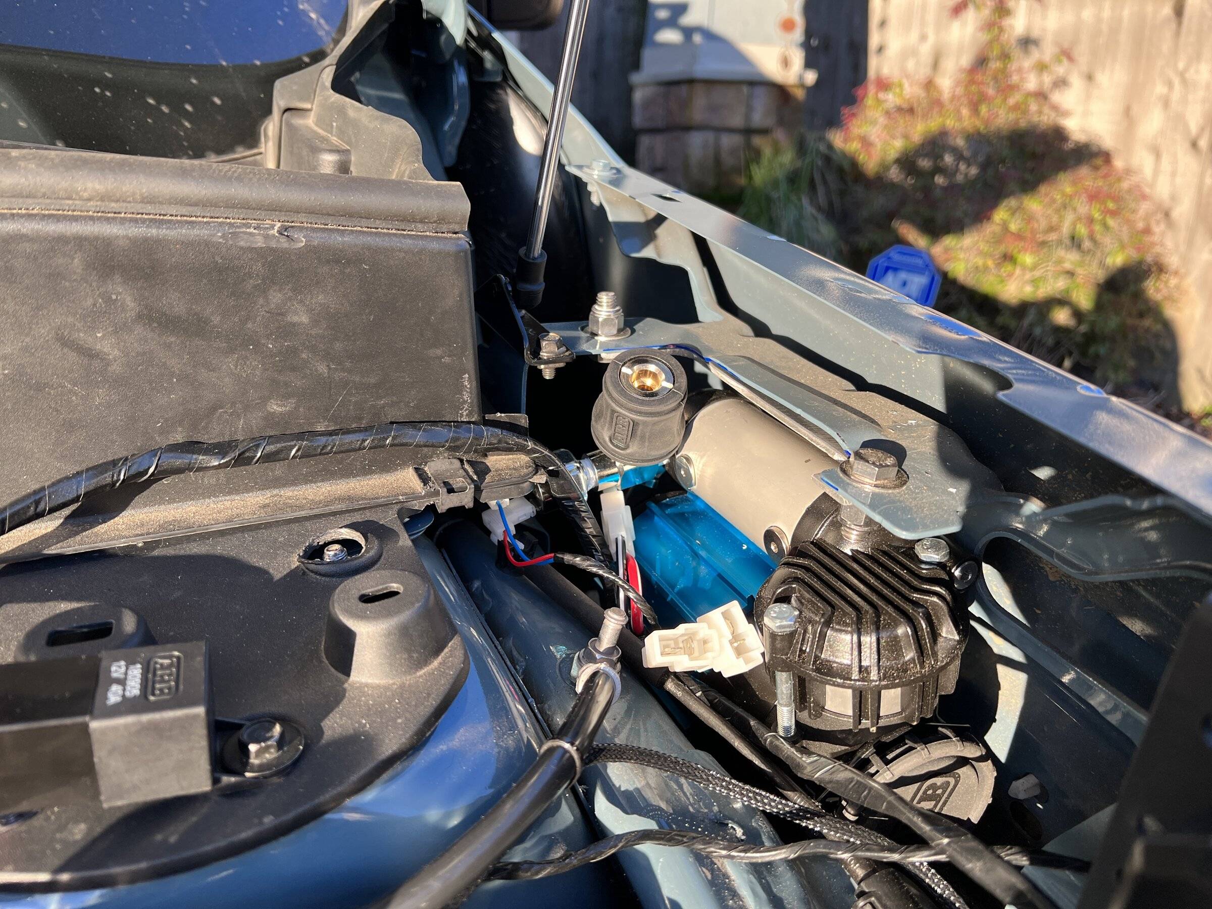

And it's in! ARB on-board air compressor installed in the Badlands!
ARB 4x4 Accessories might not want to support Bronco Sports but when you know an awesome sheet metal worker willing to help out and build a custom mounting bracket you can get it done yourself. Perfect location front of driver with easy access to air hose connection. Getting it mounted was a little tricky as it is a pretty tight fit but in that location it isn't rubbing or touching the fender or any parts inside the engine bay. Wired it into Rough Country controller which is also supporting my auxiliary lights on the brush guard.

Do you have a picture of the mount for the compressor?
