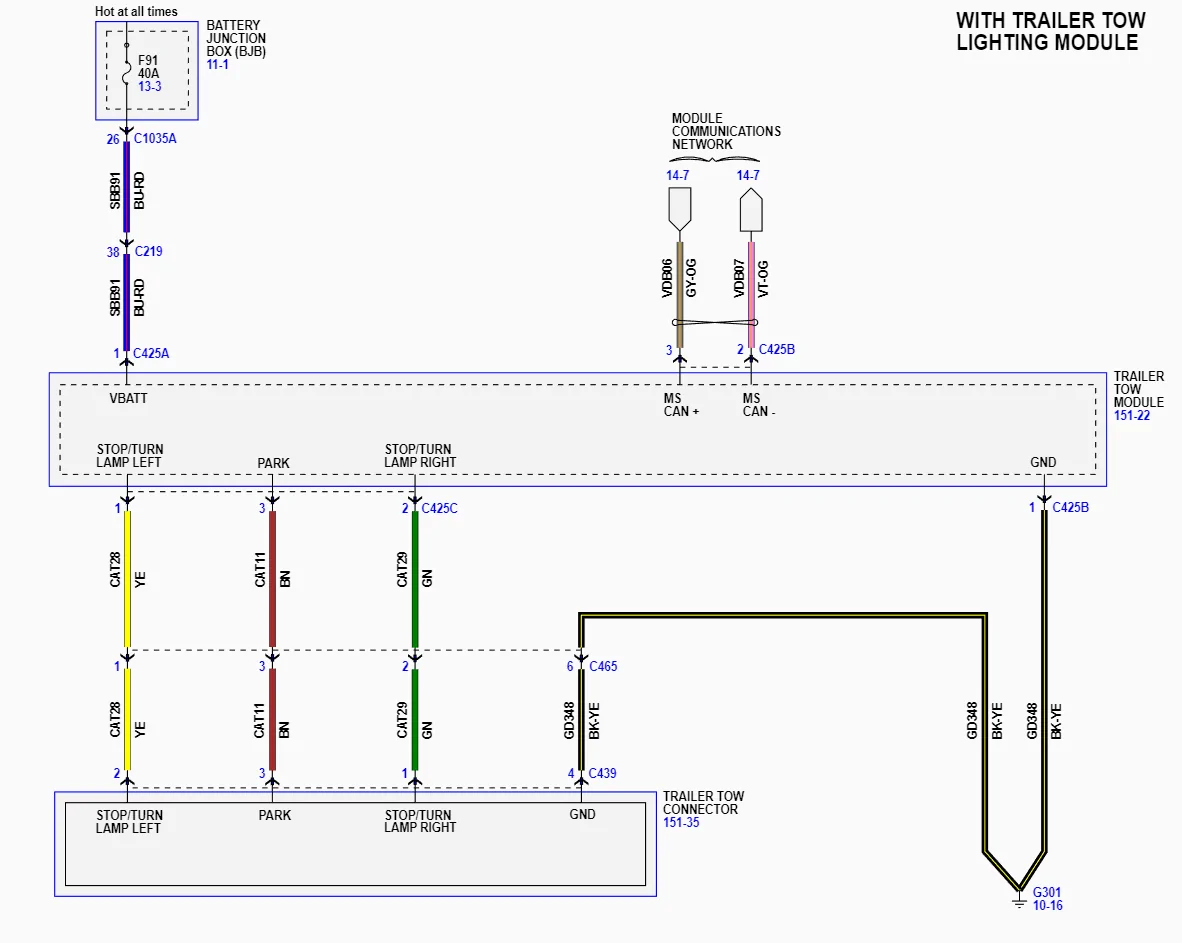

Since the research (Part One) gave me good hope that I would be able to use Ford’s pre-existing 40 Amp Trailer Circuit and the included 10 Gauge wire through the engine firewall and into the passenger compartment/wiring channels, I put together the following parts list for the installation:

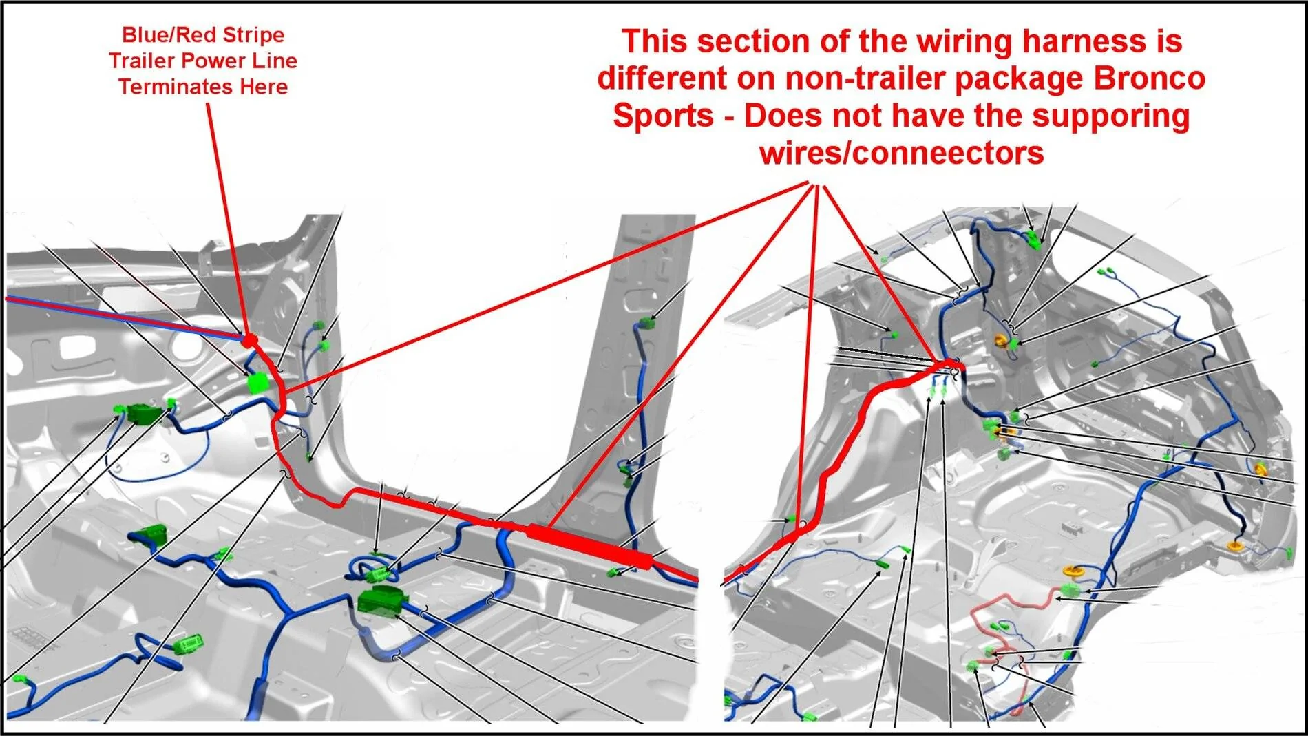

WIRING – 10 GAUGE LINE
Ford provides a 10 gauge copper-stranded line with a 40 Amp always-on fused service off the Battery Junction Box that was designed for the Trailer Tow Module. While the Tekonsha trailer lighting module requires far less oomph (15 Amp, 16 gauge line) to power a 4-way trailer connection, I wanted to make sure I could make use of the robustness of that circuit later on if I upgraded to a 7-way trailer service. Doing so meant that it was necessary to keep the thickness of the 12V+ line and connectors at 10 gauge for the entire length of the run to the rear of the vehicle. Fortunately, by using the already-existing circuit, I was able to avoid making any additional entry-points through the engine firewall and was able to keep all of the power and fusing of the line internal to the vehicle and not exposed to the elements.
Making this connection meant splicing into the Ford circuit. Ford marked this line using a Blue cover and a Red stripe, which on non-factory trailer package equipped Bronco Sports runs from Fuse #44 in the Battery Junction Box through the engine firewall, ending at the socket that connects to the plug/center section of the passenger side (right) wiring harness:

Locate the wire harness plug behind the glove box/passenger well. The correct plug will look like this:
Ford Bronco Sport Trailer Wiring Install for Bronco Sport Using Factory Power Circuit (Part Two – Installation) Connector Behind Glove Box Wiring 1
Once the connector is separated, you should find a heavy (10 gauge) wire going into the socket side of the connectors, with no corresponding lead coming out of the plug side. Additional confirmation that this is the correct wire is you will find the harness also has 10 gauge wires that are Violet/White Stripe, Gray/Violet Stripe, and 12 gauge wires that are Yellow/Brown Stripe, Green/Brown Stripe.
Using a pair of wire cutters, very carefully cut the 10 gauge Blue/Red Stripe wire from where it enters the socket side of the harness.

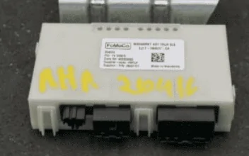

Since this is the side that the Tekonsha lighting controller will be installed on, at this point all of the critical wiring has converged on this spot.
Ford Bronco Sport Trailer Wiring Install for Bronco Sport Using Factory Power Circuit (Part Two – Installation) Left Tailight 1
Taking all the wires that have now been successfully brought to the area between the left wheel well and left taillight, reconnect and solder all color-matching wires back together and after testing/confirming continuity, (optionally) fabric-wrap the wiring to complete the interior wiring work.
The Tekonsha Trailer Lighting Module ground wire (white) was attached by removing the torx bolt from the cargo area metal tie down attached to the rear hatch frame, lightly sanding the area immediately under the tie down, and placing the ground line-eye through the bolt and between the tie down and the frame.

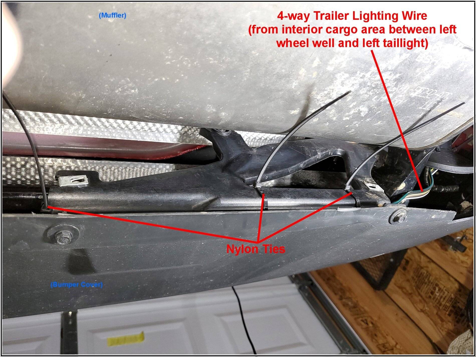

WIRING - 4-WAY CONNECTOR UNDERNEATH VEHICLE
The 4-way trailer connector wiring was run from the grommet to the space between the rear plastic bumper cover and the bumper cover support and secured with nylon ties.
Ford Bronco Sport Trailer Wiring Install for Bronco Sport Using Factory Power Circuit (Part Two – Installation) Underside wiring 1

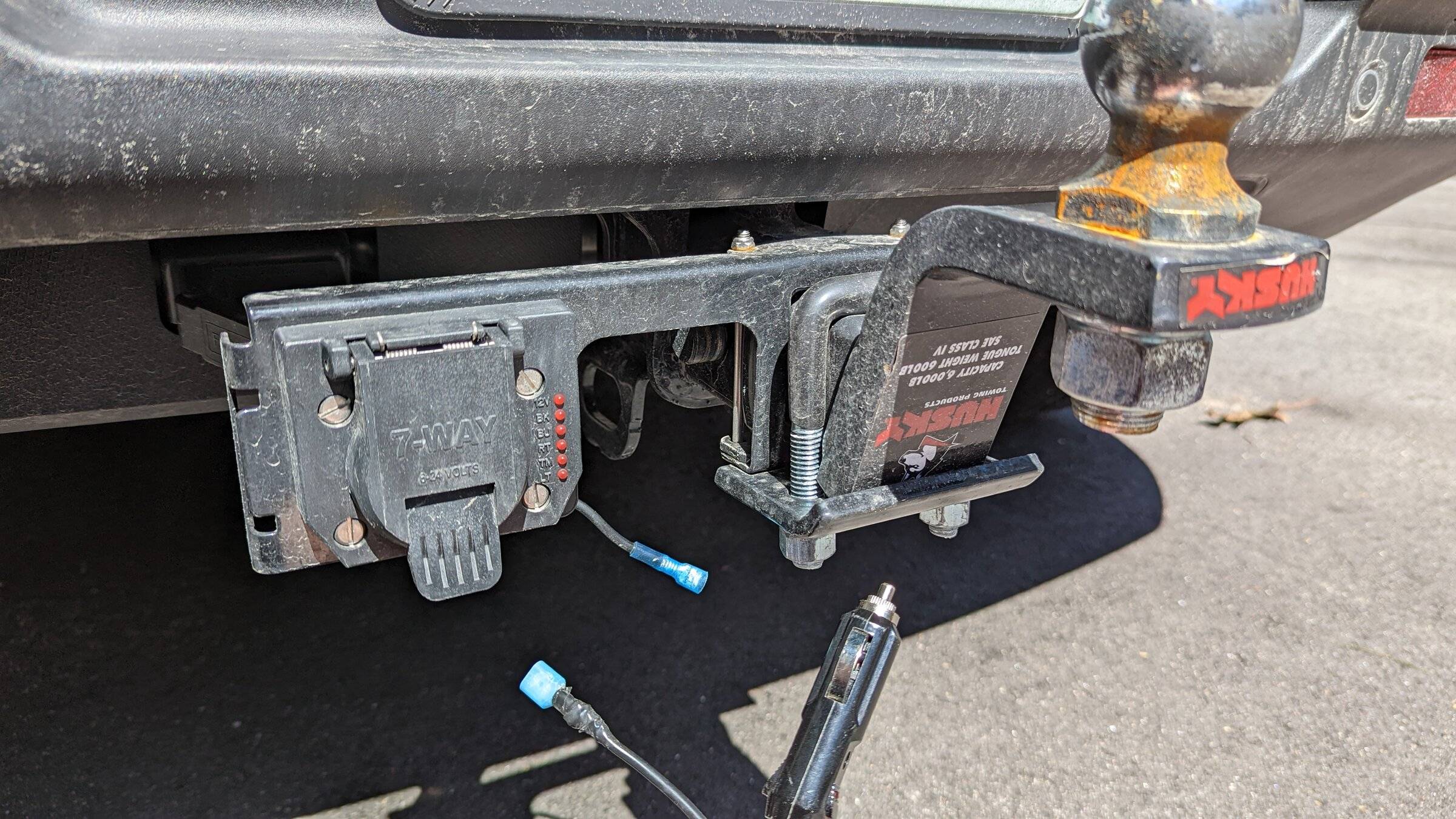

I'll try my best, but bear with me as the Bandlands and I are separated by about 2,200 miles at the moment...
The wiring for the 4 pin connector was pulled through a preexisting rubber grommet located between the driver's rear wheel well and the back hatch (once the trim panel is pulled it is pretty easy to find) and then run in the cavity between the aluminum heat shield and the rear bumper (heat shield has been removed in this pic):
At that point the wiring/plug is simply exiting next to the receiver. I also purchased Ford's Bronco hitch plug/cap as it has a built-holder for the 4-way connector. It is a little difficult to see it, but the plug is in the holder in this image:

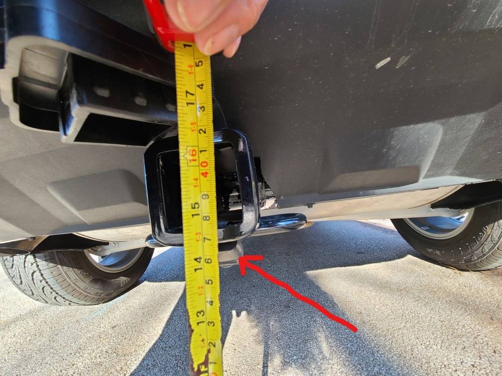

Ford Bronco Sport Trailer Wiring Install for Bronco Sport Using Factory Power Circuit (Part Two – Installation) tsy0jpET-504713 (2)
(Apologies for the tape measure being in the way, this was actually a pic my wife took this morning as I needed to know the receiver height ahead of a planned long distance move in a coupe of weeks)
Given that the OEM 4 pin connector opening is on the driver's side of the rear bumper and I routed the cable from the driver's side rear of the Bronco Sport, I can't think of any reason you couldn't run the connector to that opening instead. There certainly should be plenty of wire for that as the distance would be a bit shorter.

This leads me to asking for your advice. My badlands has the tow package (ordered in Aug 2020 - not long after you, funny yours didn't get it and mine did) and I converted the 4-way to a 7 to pull my teardrop camper. For power, I just use the rear cigarette lighter for now - I connect/disconnect to the harness power with a spade connector. Means I close the hatch on the wire - not a big deal, but this is sloppy and temporary.
Having the tow package, is there already a dedicated power line to the rear like you wired manually do you know? I'm trying to determine the best/easiest place to make a dedicated 12v run to the 7-pin. Removing panels terrifies me haha but I realize I'll probably need to for this.
Ford Bronco Sport Trailer Wiring Install for Bronco Sport Using Factory Power Circuit (Part Two – Installation) PXL_20220411_170045266
Apologies for not getting back sooner @Rane. Been off the board for a bit...
Since you got the factory tow package, you should have the 10 gauge 40 amp line all the way to the back:
Ford Bronco Sport Trailer Wiring Install for Bronco Sport Using Factory Power Circuit (Part Two – Installation) Wiring 1
The line is deep blue with a bright red stripe. The shop manual shows the line "should" run all the way to the Trailer Tow Module, which states is "located under vehicle, near rear axle". That line runs directly to the battery junction box and should provide the tap you need if you can find it.
Good luck - Michael

If anyone happens to have already found the tow module please share where it is - I'm not seeing it. Course, I don't have a lift and I'm guessing this thing is likely shielded behind something else.
Apparently this is what it looks like according to this listing.

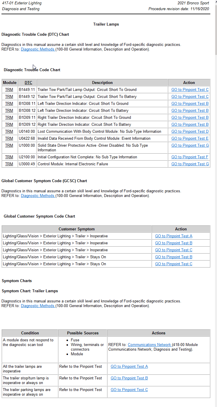

Someone was asking me for the part-number for C219 in the glove box. Unfortuniouly, ford stopped putting the connect part numbers in the Connector view section. I was not able to find it. If anyone is looking for a graphical image of the TRM, here are the sections of the service manual that I could find.

View attachment bronco-trailerLights-Troubleshooting.pdf

Hey all, I'm gonna revive this thread...

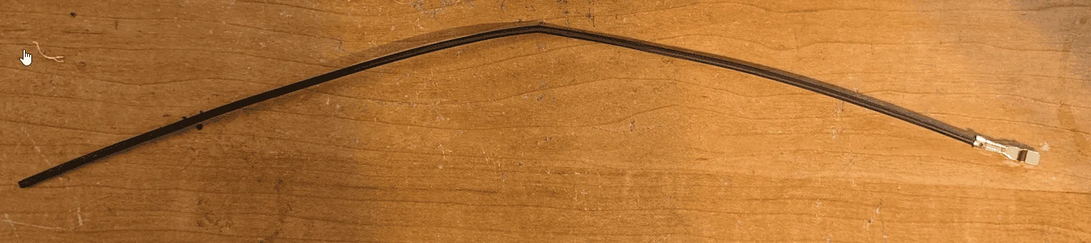

Looking at @MKohlman's superb work I know the power wire from connector C219 back to the trailer module connector C425A is simply missing. And since C425C is just for the 4 connectors to the trailer betting that's missing too. My question is if C425B is missing from the wiring harness. I don't really want to pull a panel and check unless I have too.
Ford Bronco Sport Trailer Wiring Install for Bronco Sport Using Factory Power Circuit (Part Two – Installation) 1680580245228
Edit: I pulled the panel, it's missing too.
I'd also like to point out an error in the diagram for the connector behind the glove compartment. The red line is actually pointing to pin 7, pin 38 is on the other side of the connector.
Instead of splicing into this wire I ordered a terminal repair kit from Ford that allowed me to add the wire to the connector where it was missing. It uses a 280 series Metri-Pack connector, so you could make your own. Ford's repair pigtail part # is DU2Z-14474-EA.
