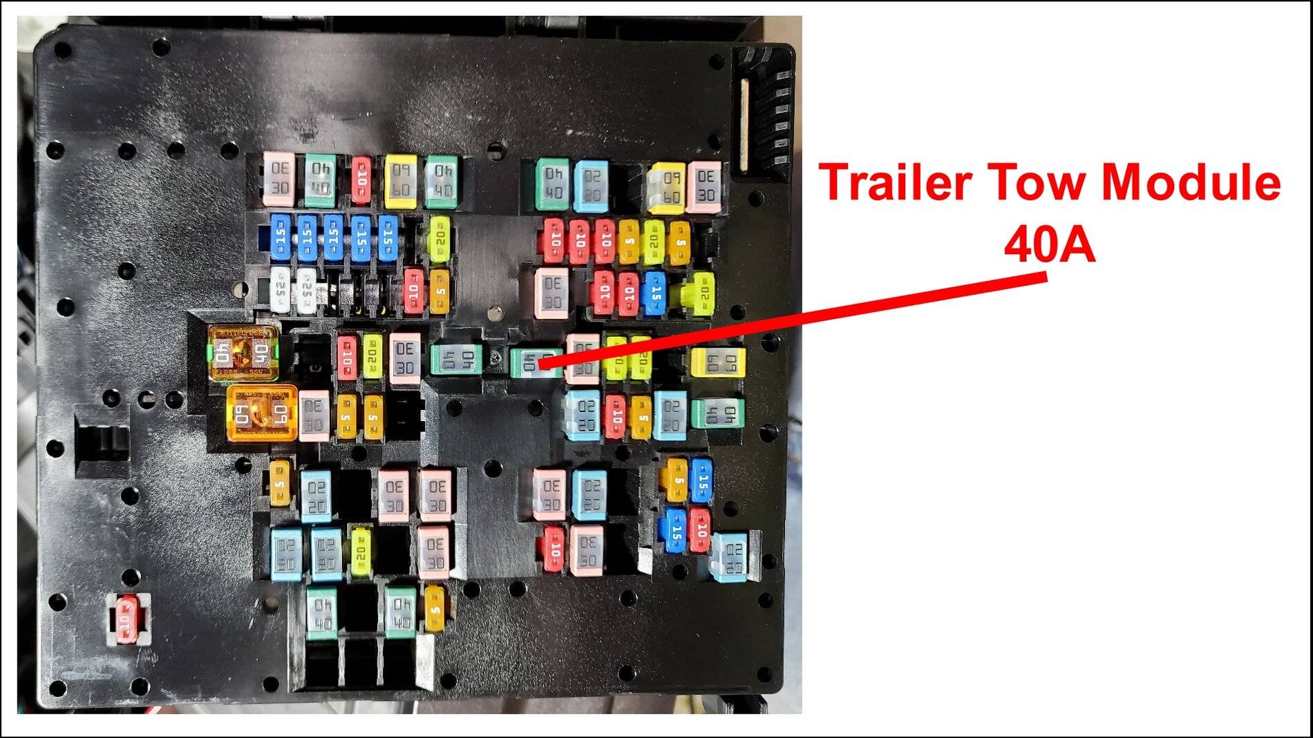

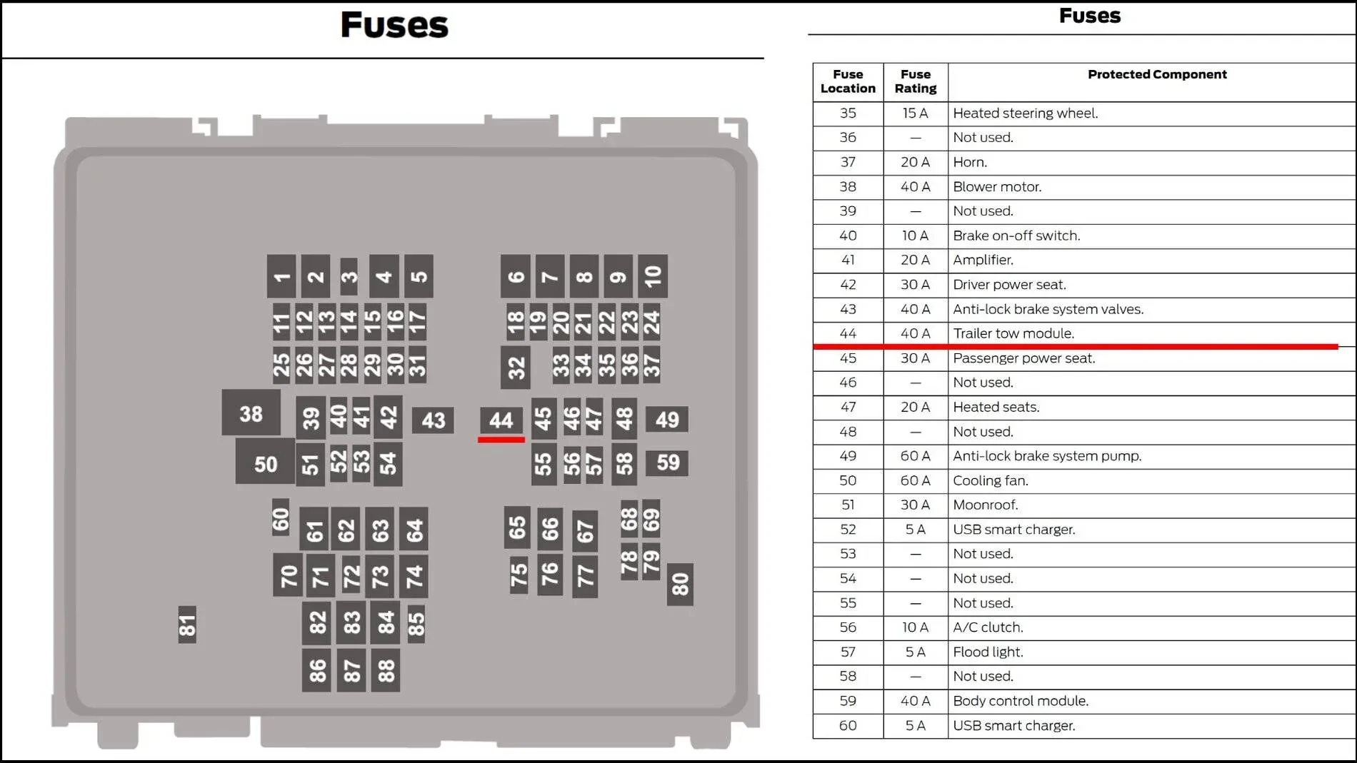

The first clue that Ford may have left at least something that could be connected to is in the Owner’s Manual. In the Fuses section of the manual, there is a Fuse listed as being located in the Battery Junction Box with a 40 amp service for the “Trailer Tow Module”:
Ford Bronco Sport Trailer Wiring Install for Bronco Sport Using Factory Power Circuit (Part One – Research) Fuses 1
And, lo-and-behold, upon opening the Box, I found that the location and the fuse were both present/installed on my non-factory-equipped Badlands:
Ford Bronco Sport Trailer Wiring Install for Bronco Sport Using Factory Power Circuit (Part One – Research) Fuses 2
So, this gets interesting… The question now is how far does the wiring for that circuit go and would it even be possible to add the missing modules and connectors?

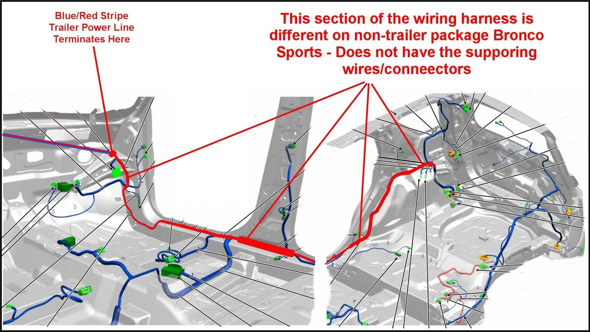

Next step was to find a way to get a shop manual and wiring diagram. Those started popping up on eBay in the spring and I added a DVD to my library. In the manual there is a section covering the wiring for the Trailer Tow Module, with 3 sections of wiring harness related to it. Section one runs from the Battery Junction Box to a connector located just behind the glove box on the passenger side. Section two runs from the glove box location to just above the right rear wheel-well (internally, behind the interior cargo panel). Section three runs from that location to a junction point under the car that would have provided the 4-way plug. Also, in the wiring diagram it was noted that the power wire for the Trailer Tow Module was a pretty hefty 10 gauge Blue/Red Stripe wire.
Ford Bronco Sport Trailer Wiring Install for Bronco Sport Using Factory Power Circuit (Part One – Research) Wiring 1

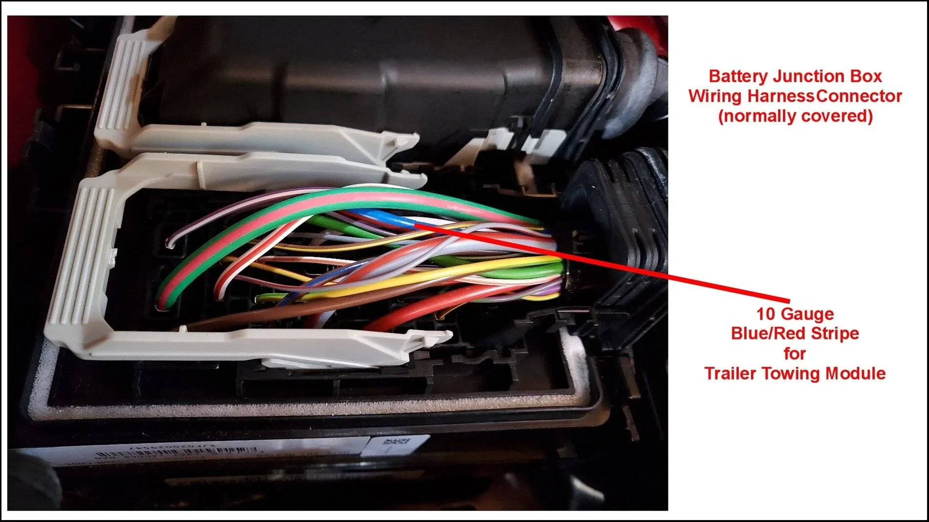

A cursory examination made it clear that section three of the wiring harness wasn’t installed on my Badlands. More disappointing was that, when examining section two of the wiring harness, it was clear that the heavy gauge wire was missing, meaning that Ford does use a different center section (section two) wiring harness for Bronco Sports without the factory tow package.
But since the Fuse is present, perhaps at least the wiring coming out of the Battery Junction Box is present as well?

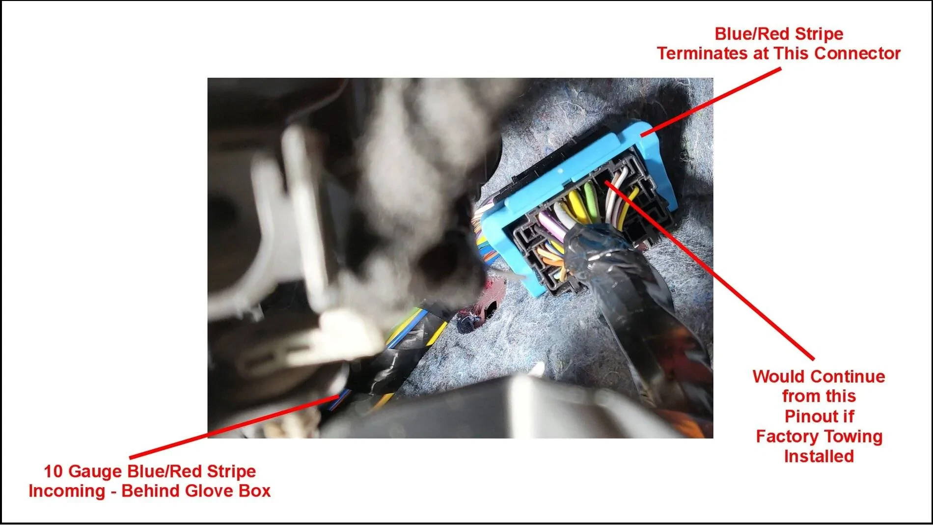

The good news is that the elusive Blue/Red Stripe wire does indeed come out of the Battery Junction Box, runs through the firewall, and terminates into the harness connector behind the glove box. It simply ends there when connected to the next section of harness and therefore is unused. This meant that it should be possible to tap that line without having to penetrate the firewall or running a direct-to-battery connection.

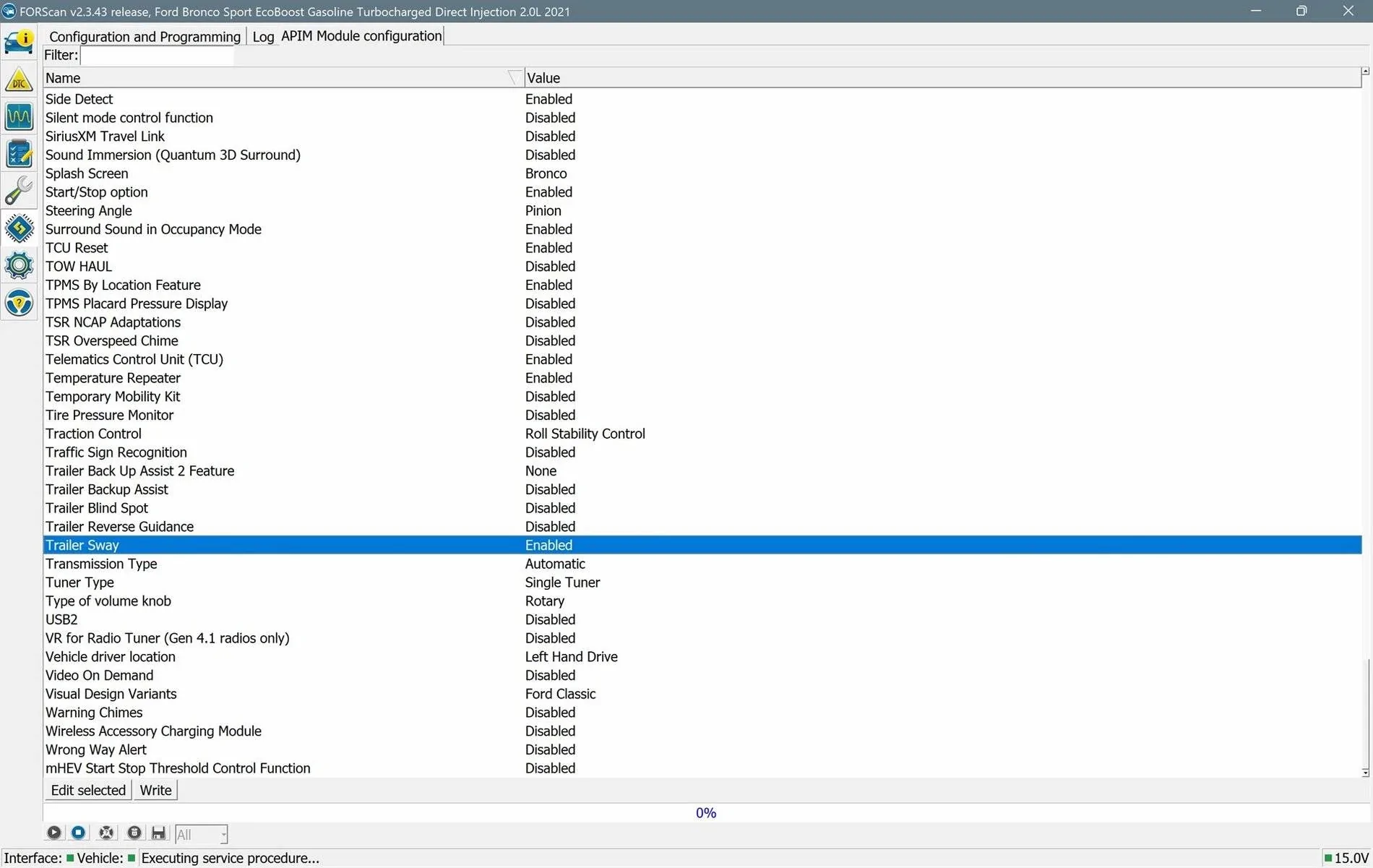

The last item of good news was, once Bronco Sport support was added to FORScan, a readout of the program settings revealed that the Trailer Sway Control was present and enabled on my Badlands (something that appears to be true for most/all 2021 Bronco Sports, regardless of trailer package status).
Ford Bronco Sport Trailer Wiring Install for Bronco Sport Using Factory Power Circuit (Part One – Research) FORScan Trailer Sway 1
This would seem to indicate that it should be possible to do a pretty clean install that would be a close match to what Ford offered, using the actual fuse/circuit that Ford designed for the trailer wiring.

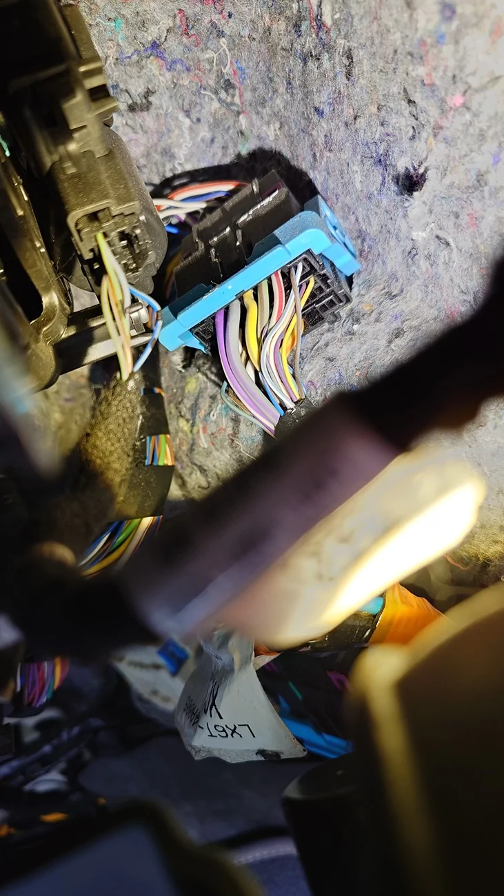

Hi , in this place, where you have Free pin I have white/ bronze 10 gauge. Where they going?
