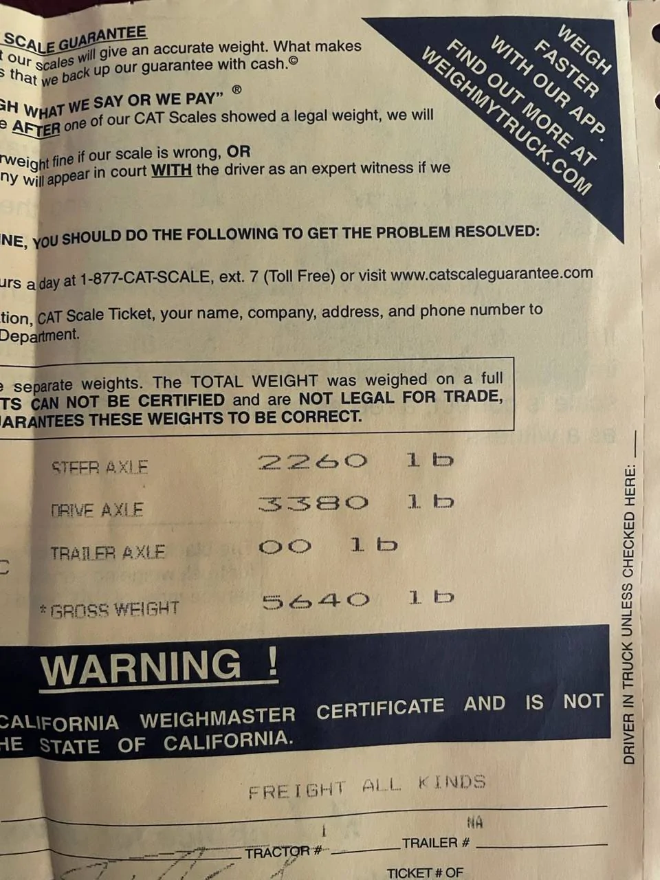

Went to cat scale this morning- because of the short wheel base it is difficult to get the thing set correctly- this is what it read - not sure the axel readings are correct but it appears that the gross weight is about 600 pounds below allowable 6260 - is that correct and does this seem like a non-issue to pull - it was loaded as we would load

Is this combined vehicle and trailer weight?

Yes - including passengers and some cargo

Then as you note, you are well below the GCWR. Assuming the weight in your car and trailer is properly distributed (at least 10% of total trailer weight on the tongue) you should be fine.
