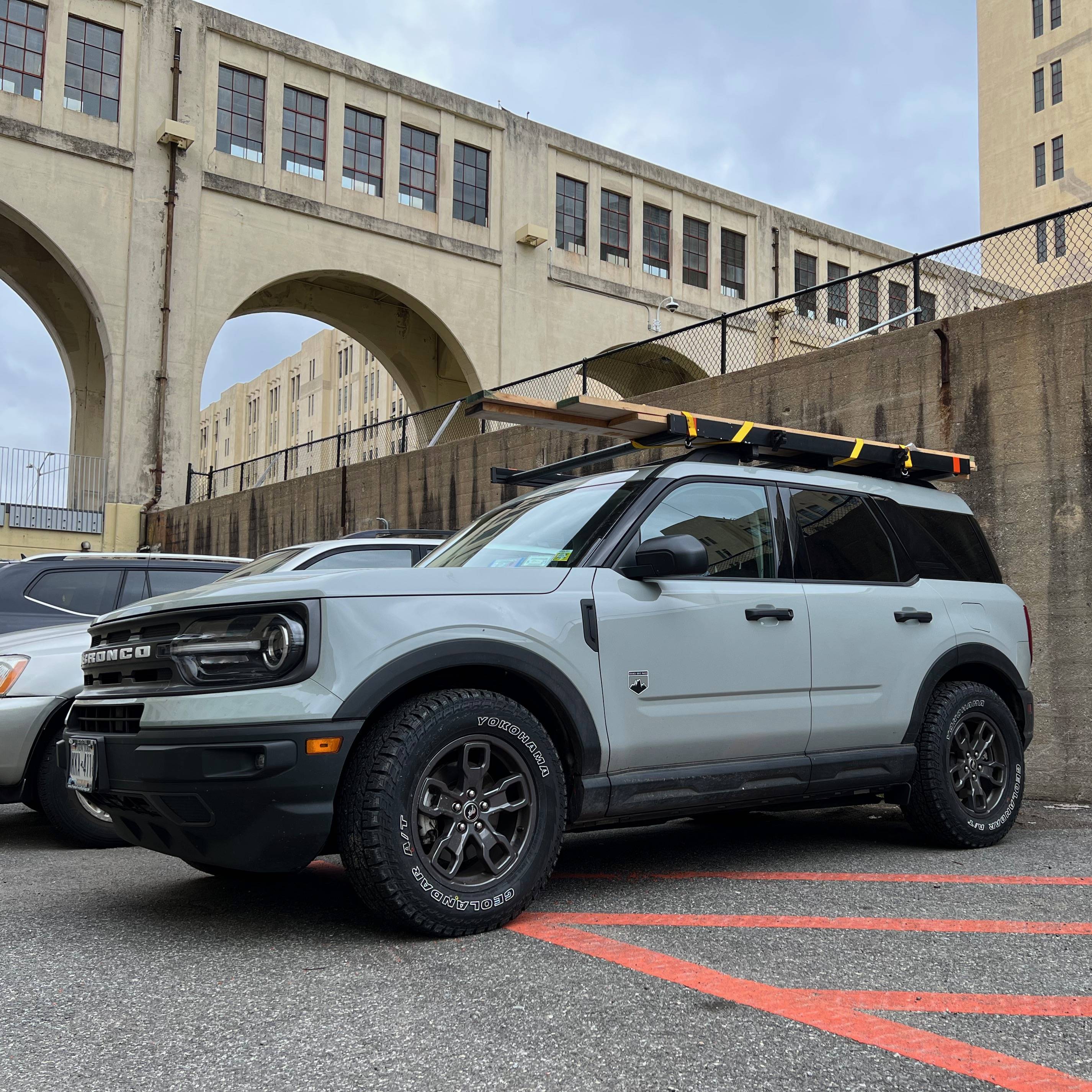

Yeah I got the Yokohama Geolander's on my Big Bend (after reading some of Osco's posts 👆)
Same engine as your base. I got the 245's which are a lot heavier than 235's but they're still really quiet. I think I lost a little bit of pep because of the weight, but haven't quantified it all. Haven't ridden in snow yet, but they're fantastic in the rain. They look great too, IMO.
Ford Bronco Sport Tire Recommendations IMG_2115
