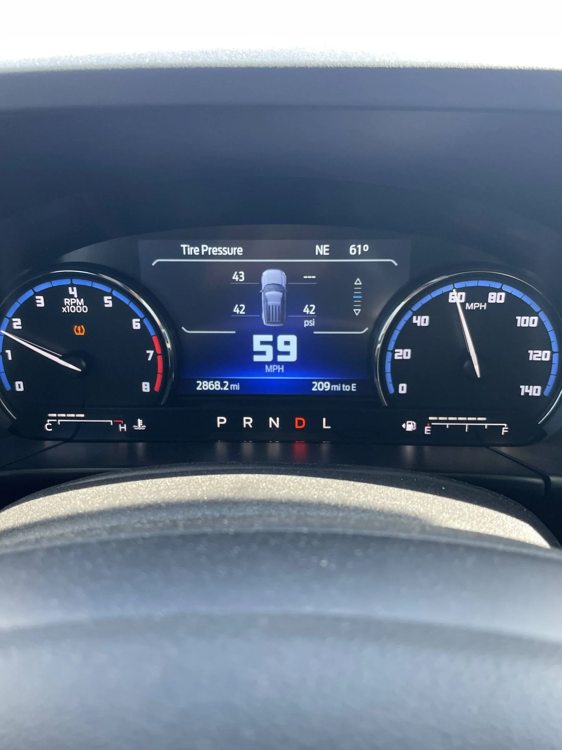

I’ve had this warning go off on me twice in the last week or so. Both times right, first rear then front. No flats no visible issues. Warning in dash then Ford pass. Psi screen showed blank on the tire as opposed to the level. After pulling over and inspecting warning disappeared after restarting. About to go visit my folks 200 miles away and wondering if I need to go to the dealership first. Anyone else experience this or have thoughts?

Yes makes sense. I’ve also noticed when it happens the reads are kinda high. Weather has been all over lately and have seen them read as high as 45. When it triggers I see most over 43. Is it strange to think because the computer wants me at 33 I could be exceeding what it considers a max?

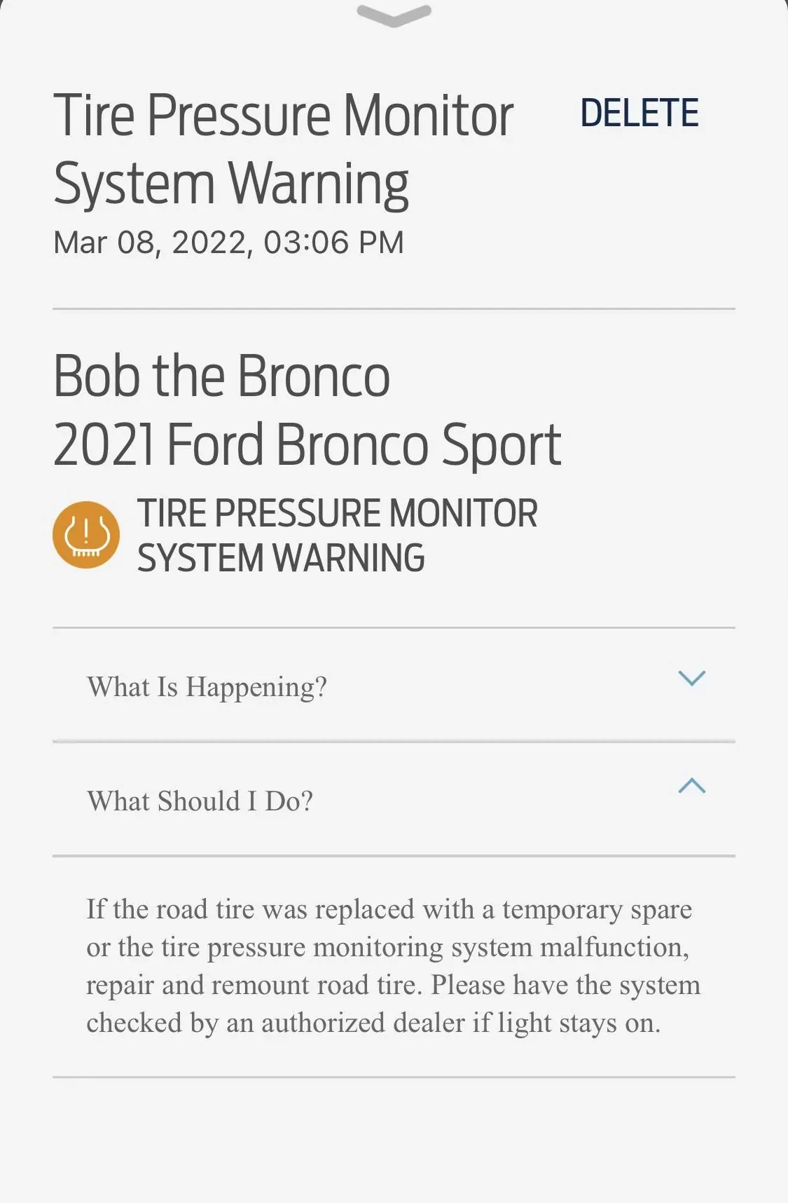

Still having TPMS sensor issues. Yesterday had the guys @Discount Tire deflate my psi to 40. Today they got up to 43 and one of them faulted out. No flat no visible issues. Ford Pass tells me 33psi but the AT3 have a 50 psi max and have been set to 40. Not sure why this keeps triggering. But going to call my dealer when I get back in town.

Took the picture to get more feedback. As it’s happened multiple times and no flats. Also have gone to Discount Tire and they have deflated tires and told me they are within the recommended use. Please give me further expertise as a tire professional.
