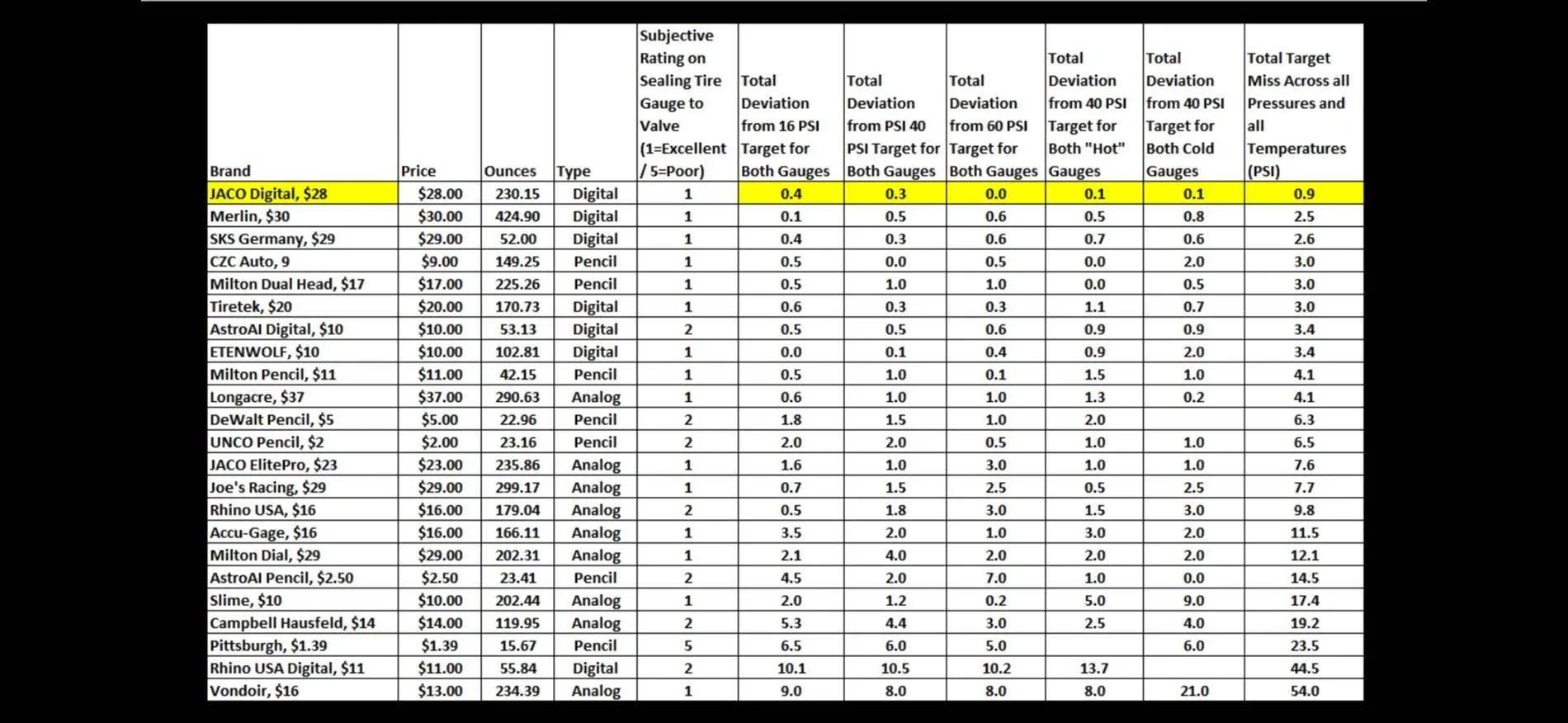

Great video!
There are test result charts for:
16 psi,
40 psi,
60 psi,
Subjective Rating on Sealing Tire Gauge to Valve,
Hot temperature test: Total Deviation from 40 PSI Target for Both "Hot" Gauges,
Cold temperature test: Total Deviation from 40 PSI Target for Both Cold Gauges

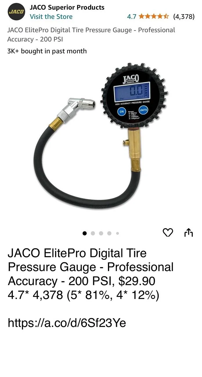

And this chart summarizes the tests along with a pic of the top performing gauge:

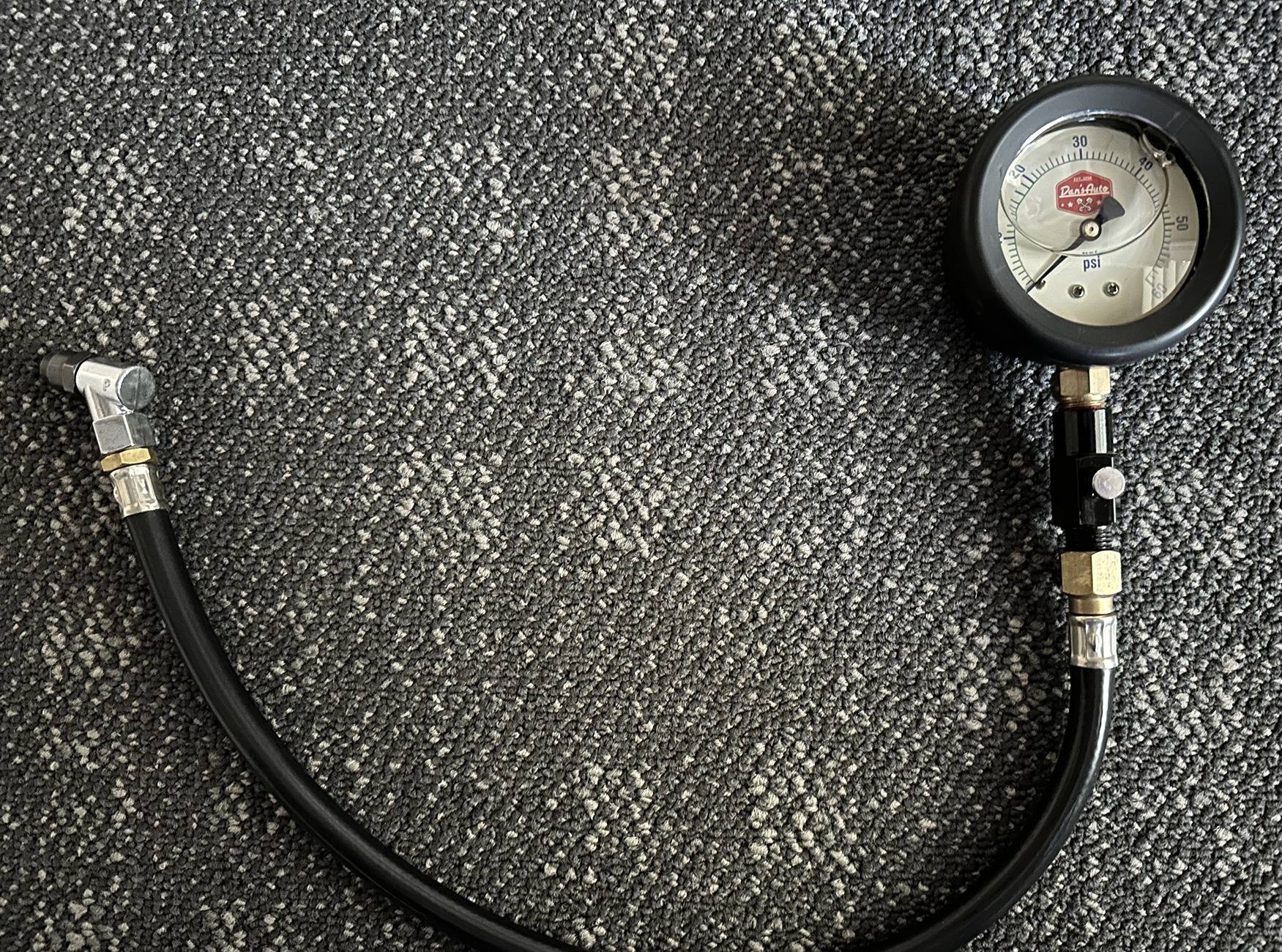

Bought this about 5 years ago. Liquid filled analog gauge. Works well but can't say for sure how accurate it is.

You can always compare its reading for the 4 tires to the psi shown on the dash (or FordPass App) and occasionally test against a known good gauge. That’s what I do.

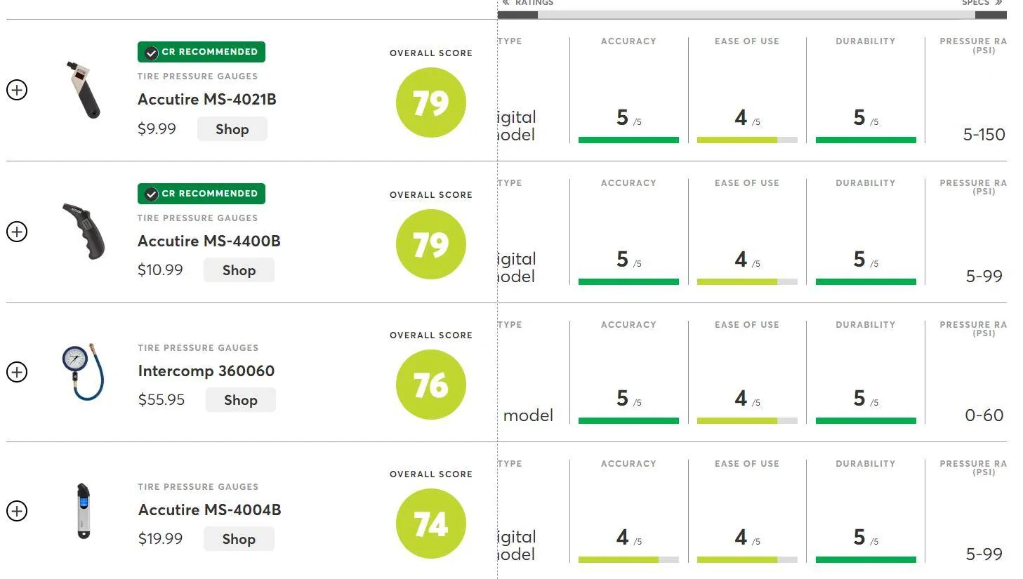

About:
The Accutire MS-4021B is part of the Tire pressure gauges test program at Consumer Reports. In our lab tests, Tire Pressure Gauges models like the MS-4021B are rated on multiple criteria, such as those listed below.
Accuracy: Accuracy is based on a comparison of each model against a known calibrated master gauge at various pressures, and at cold, room, and hot temperatures. Cold and hot temperatures simulated storing the gauge in a car in winter and summer temperatures.
Ease of use: Ease of use is primarily an assessment of pressure readability and how easy is it to take a pressure reading on an inflated tire.
Durability: Each model was checked for accuracy after a drop test of approximately 30-inches from a table to judge durability.
Those are the top 4 gauges.
I've used the Accutire MS-4021B (or very similar) for decades. It's a good deal at $10.

Guess I'm old school. Prefer the analog dial no batteries to worry about.

Nothing wrong with that.
The third gauge in the ratings is analog, and it's essentially as good as the 2 above it.
