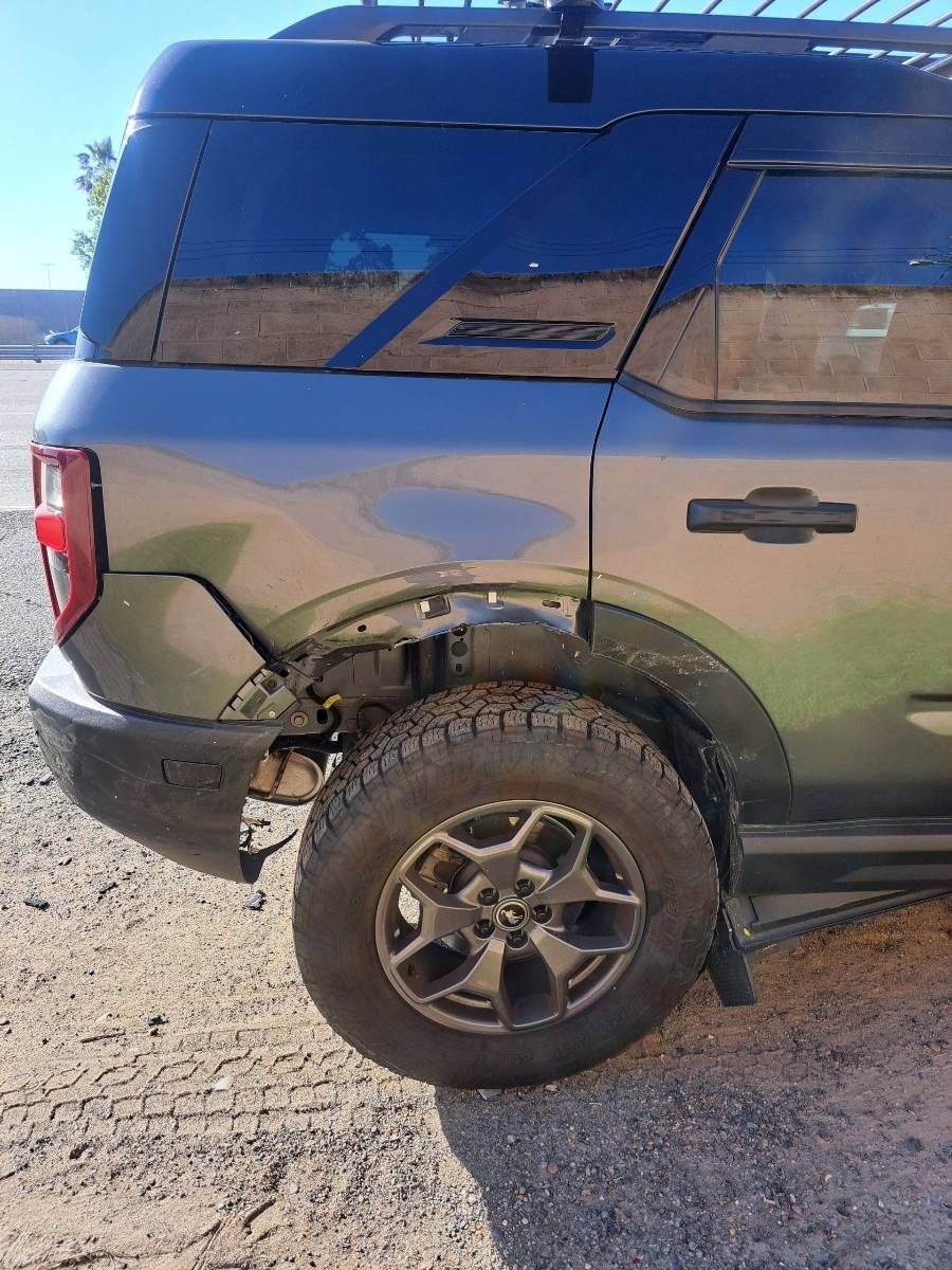

I've always thought the brakes on this car were terrible.
Ford Bronco Sport Thoughts on Power Stop Rotors and 17 Brake Pads? Resized_Resized_20250418_171659_1745021893369_1745021899463
Not wanting this to happen again, i want my wife to be able to stop and not have to make evasive maneuvers, resulting in an accident.
