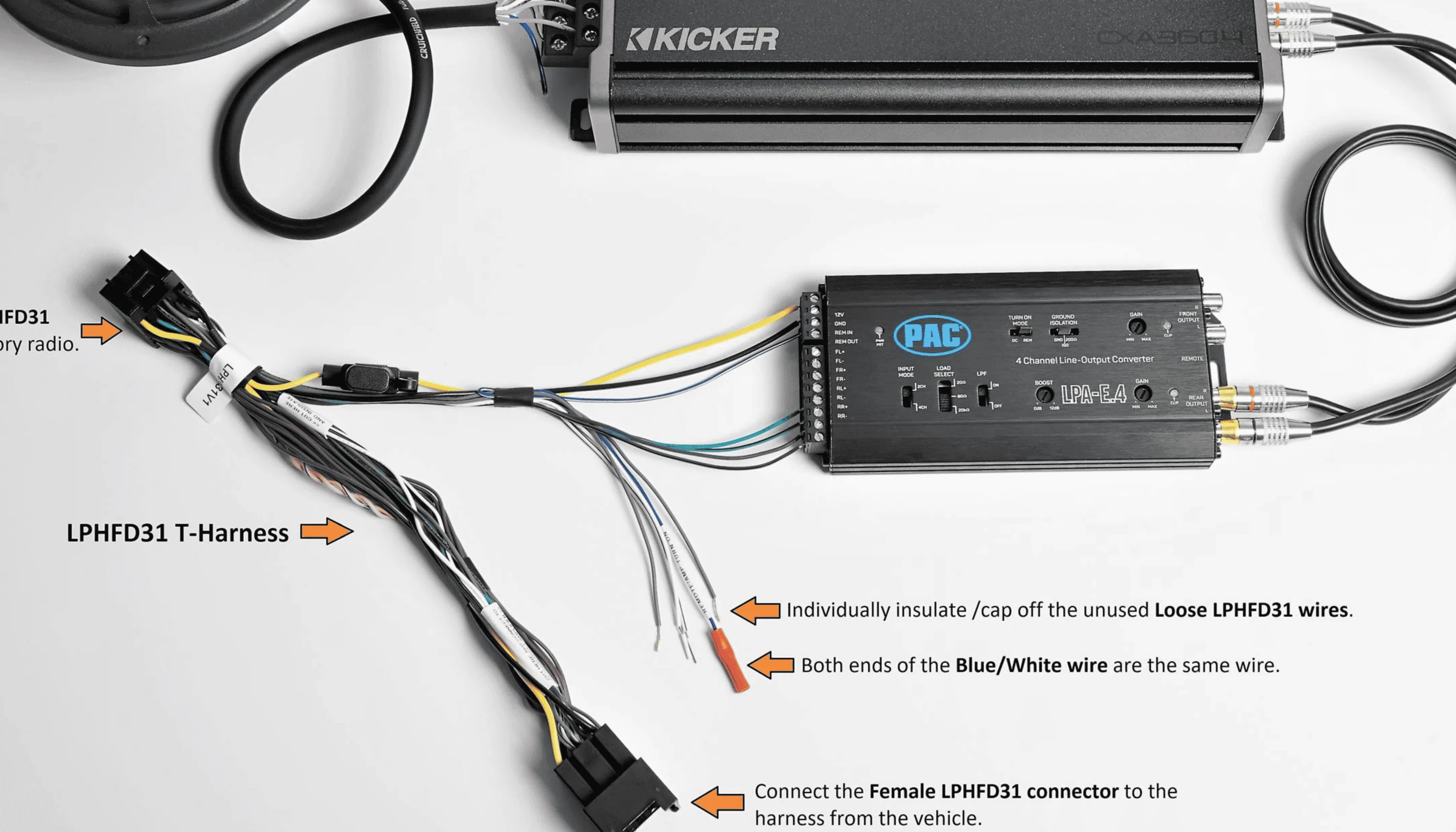

Does anyone have a video to install this device ?
I am looking to add an aftermarket amp....

You're going to tear down your dashboard fairly decently. YOu have to get your 'ACM', which is behind your AC controls. ONce there, its simply a matter of unplugging the connector going to the ACM, and sticking the adapter in between. Then you run the wires out to your amplifier, wherever itmight be mounted. They do a nice job of providing you a decent illustration here. You will have to doublecheck the color coding of the speaker wires, to make sure you grab and isolate the right ones.

Thank you for this video , this is gonna be way easier than i thought for this old man who loves his music loud and clear.

I am powering only door speakers not a sub ,
wire configuration is a little different. the wiring taps back into t harness to get to door speakers..
